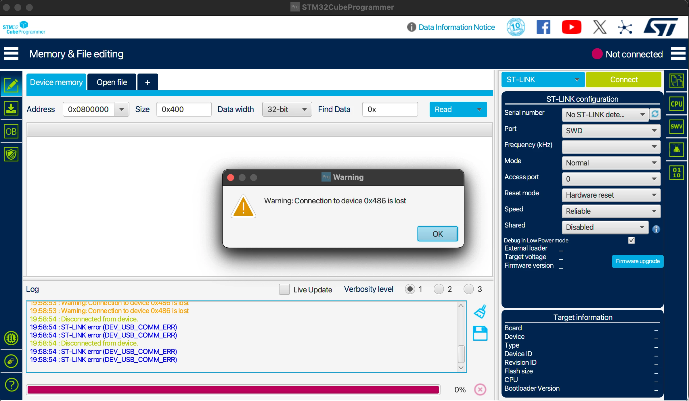

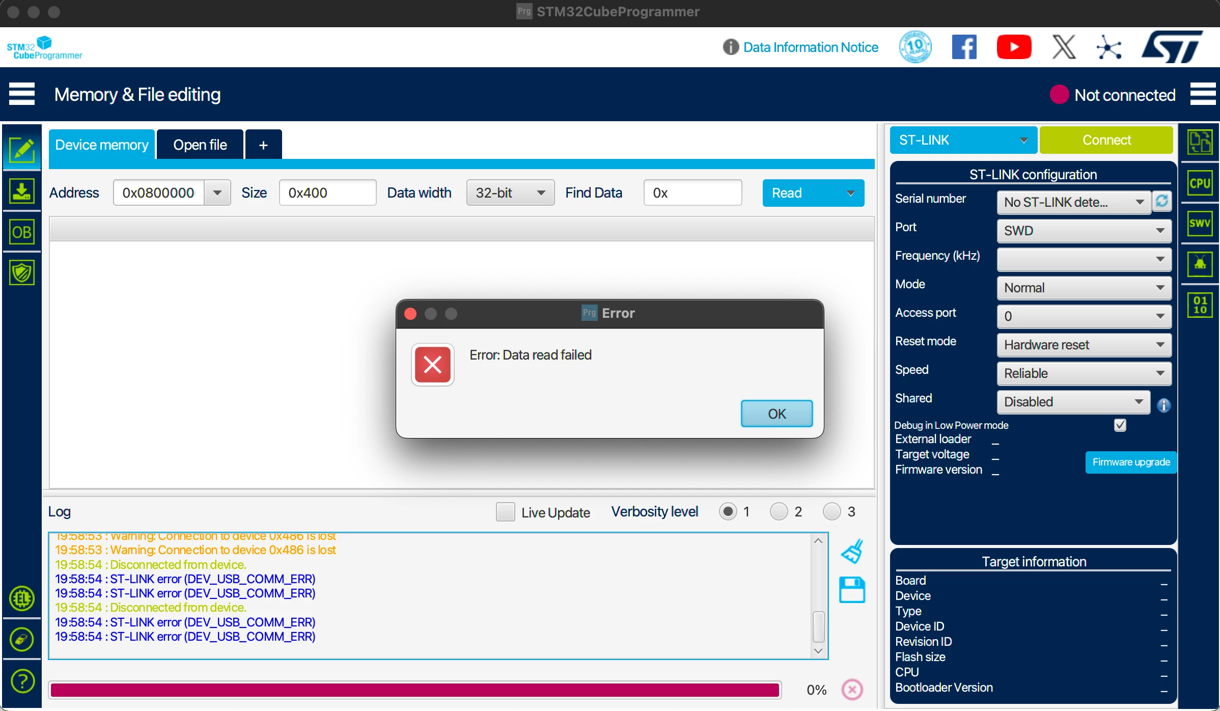

As I am trying to connect the STM32N6570-DK board on the STM32CubeProgrammer, initially the STM32CubeProgrammer recognises my device as in the following picture:
When I press Connect on the STM32CubeProgrammer I get a
warning: Connection to device 0x486 is lost

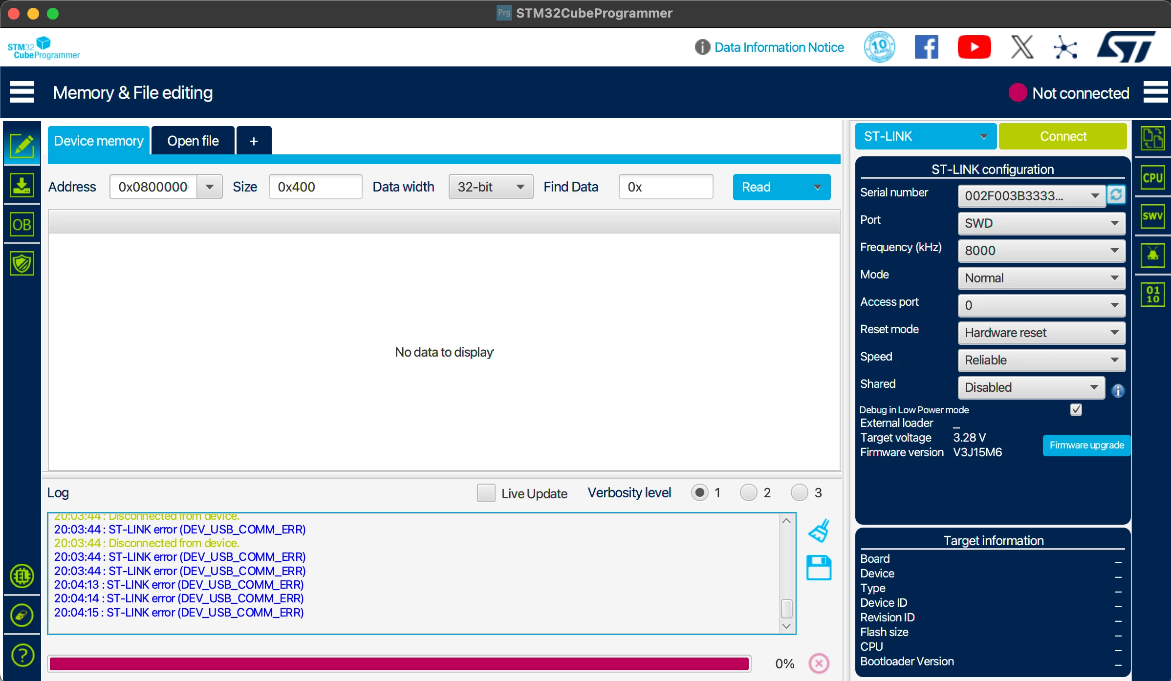

and then an error that says Data read fail
I am using a MacBook Air M3, 2024, but even on windows (running on a virtual machine) I get the same error on the STM32CubeProgrammer windows version.
Is there a way to overcome this issue? What could be the cause?

I managed to get all STM32Cube tools working on Mac OS M1 and M2 without any issues. I don't have M3 hardware.

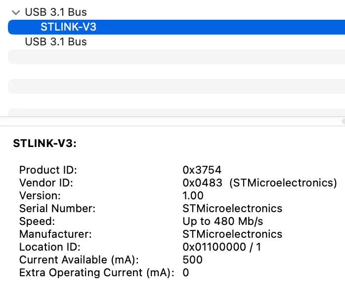

  1. Start with connecting the STM32N6570-DK STLinkV3 (CN8) to your Mac, and check if and how it recognizes the USB device (see the link below) https://www.youtube.com/watch?v=aXd7FsjcIpI
  2. Confirm that you are using the latest version STM32CubeProgrammer v2.19.0?
  3. On Mac computer, Update Rosetta: $> softwareupdate --install-rosetta
  4. Update the STLink Firmware to V3J16M7 of your STM32N6570-DK.
  5. Ensure that your board is in DEV_BOOT (BOOT1=H) and that the Red LED2 is on after a RESET.
  6. Try changing the ST-LINK configuration to Mode=Hot plug and Reset Mode=Software reset.
  7. Change the USB cable.
  8. Try on another computer.
Good luck.

1. I have connect it using a usb-c to usb-c cable to my computer and it seems that it recognises it as in the following picture. (I think you mean STLINK-V3EC USB Type-C CN6 connector. is this right?)

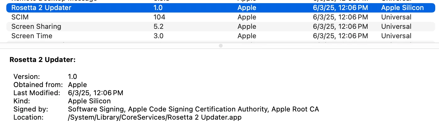

3. Rosetta is installed on my computer as in the following picture

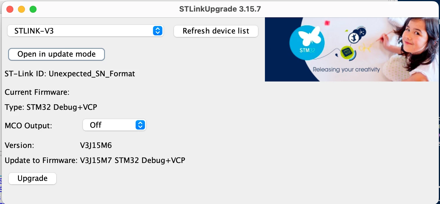

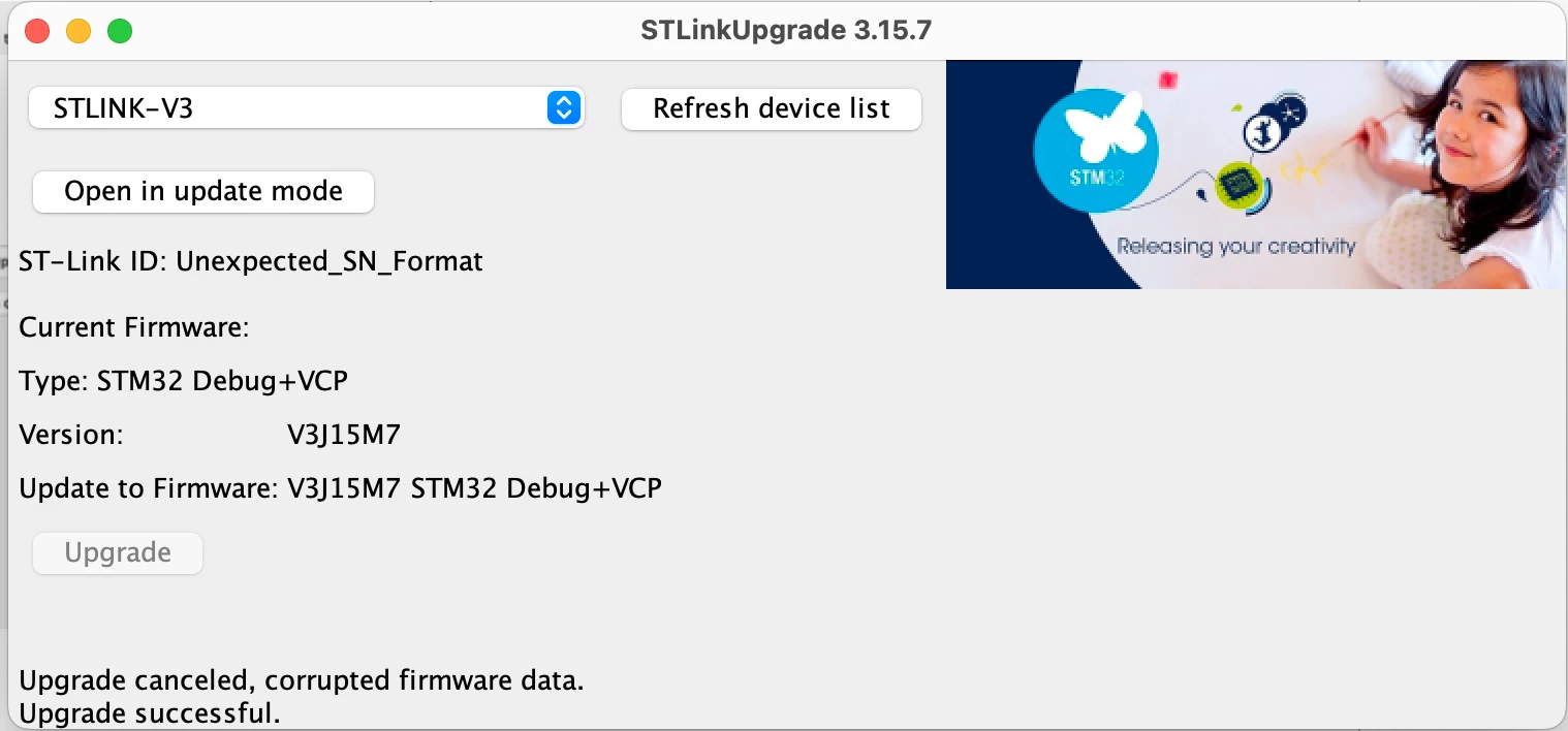

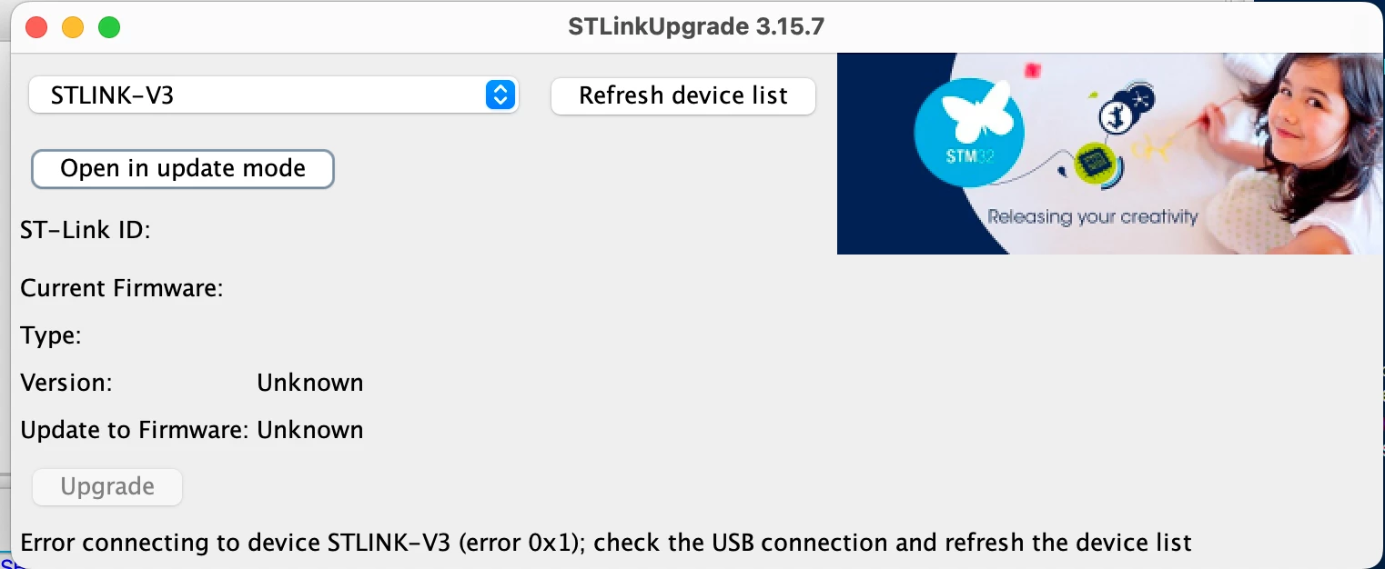

4. The firmware version is the V3J16M6 but it seems that it can not be updated. I have tried the following
Using a usb-c to usb-c cable:
I get the following error in the next picture:
Using a usb-c to usb-a cable with an adaptor for my Mac (usb-a to usb-c):
It seems that it recognises my device as in the following picture:
But when I press update I get the following:
Although it says Upgrade successful, when I refresh it shows again the first picture, meaning that the firmware has not been updated and it is still in the V3J16M6 version.

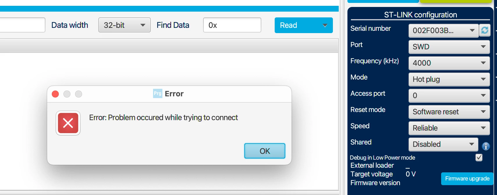

6. I tried the Mode=Hot plug and Reset Mode=Software reset but again I get an error as in the following picture:
(I get the same error using both cables as described above (usb-c to usb-c cable and usb-c to usb-a cable with an adaptor for my Mac (usb-a to usb-c))

The actual STLink-V3 version (the one on your N6-DK) is V3J15M6, this can be checked with the STM32CubeProgrammer capture you shared in the previous post.
I confirm that the USB-C must be connected on CN6 which correspond to STLink-V3 on the DK board.
Now, concerning the STLink firmware update, Do you have clicked "Open in update mode " before starting update?
These steps are needed to configure the STLink-V3 mcu (the STM32F7 on board) in DFU mode, and then program the new firmware version in the flash.
In the Update to firmware, the version should be V3J16M7, and not the V3J15M7.

18:46:47 : UR connection mode is defined with the SWrst reset mode
18:46:47 : ST-LINK SN : 002B00423234510E37333934
18:46:47 : ST-LINK FW : V3J15M7
18:46:47 : Board : STM32N6570-DK
18:46:47 : Voltage : 3.29V
18:46:47 : SWD freq : 8000 KHz
18:46:47 : Connect mode: Hot Plug
18:46:47 : Reset mode : Software reset
18:46:47 : Device ID : 0x486
18:46:47 : Revision ID : Rev B
18:46:47 : UPLOADING ...
18:46:47 : Size : 1024 Bytes
18:46:47 : Address : 0x8000000
18:46:47 : Read progress:
18:46:47 : Data read successfully
18:46:47 : Time elapsed during the read operation is: 00:00:00.003
18:46:54 : Opening and parsing file: x-cube-n6-ai-h264-usb-uvc-dk.hex
18:46:54 : Memory Programming ...
18:46:54 : File : x-cube-n6-ai-h264-usb-uvc-dk.hex
18:46:54 : Size : 11.11 MB
18:46:54 : Address : 0x70000000
18:46:54 : Erasing memory corresponding to segment 0:
18:46:54 : Erasing memory corresponding to segment 1:
18:46:54 : Erasing memory corresponding to segment 2:
18:46:54 : Download in Progress:
18:46:54 : Error: failed to download Sector[0]
18:46:54 : Error: failed to download the File
18:46:54 : Warning: Connection to device 0x486 is lost
18:46:54 : Disconnected from device.

Hello, I have the same question. My scenario is when debugging extra load. Details are as follows
1. Debug using develop mode (boot0-GND, boot1-3.3v)
2. Mistaken use of serial download (boot0-3.3v, boot1-GND)
3. Without realizing the error, use flash boot mode (boot0-GND, boot1-3.3V)
After these steps, 0x486 problems arise
Visitor II
Jun 27, 2026 10:08 AM UTC
I think the FSBL was damaged during startup, causing problems in the TZ area. May I ask if there are other ways to fix this after switching to Flash?
Visitor II
Jun 27, 2026 10:45 AM UTC
I addressed this issue by following the steps below
1. Reflash the stlink firmware
2. Burn the official extra loader
3. Flash a test case and restart it
