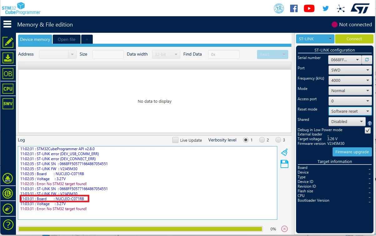

I'm working with NUCLEO-C071RB.
I debug , all OK.

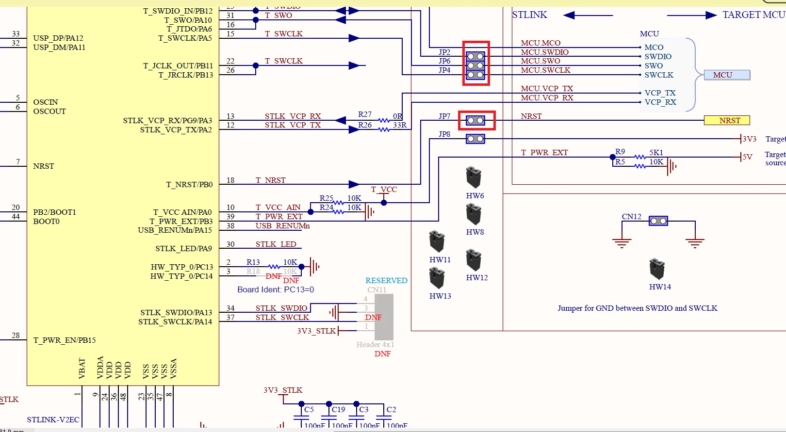

Because now i want bliud my board i tried to connect with the software Programmer with my ST/link2 device (external)
I disconnected JP2-4-6-7 like shown in screenshot.
I power on the board with usb cable.
The Programmer seems recnognize the MCU (NUCLEO-C071RB), but so what does it means "target no found"?sdsfgd.pngddddd.png

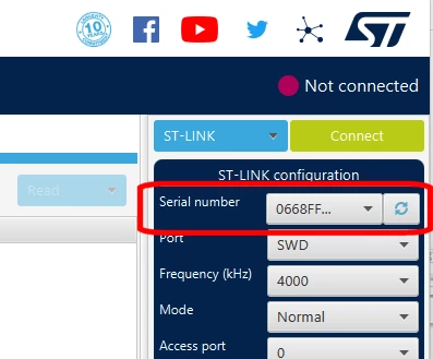

The on-board ST-Link is still connected to that USB - so the programmer will still see it.
But you have disconnected the target MCU from the on-board ST-Link - so it will say, "No target found"
Instead, you need to connect the programmer to your external ST-Link, and wire that ST-Link to the target MCU.

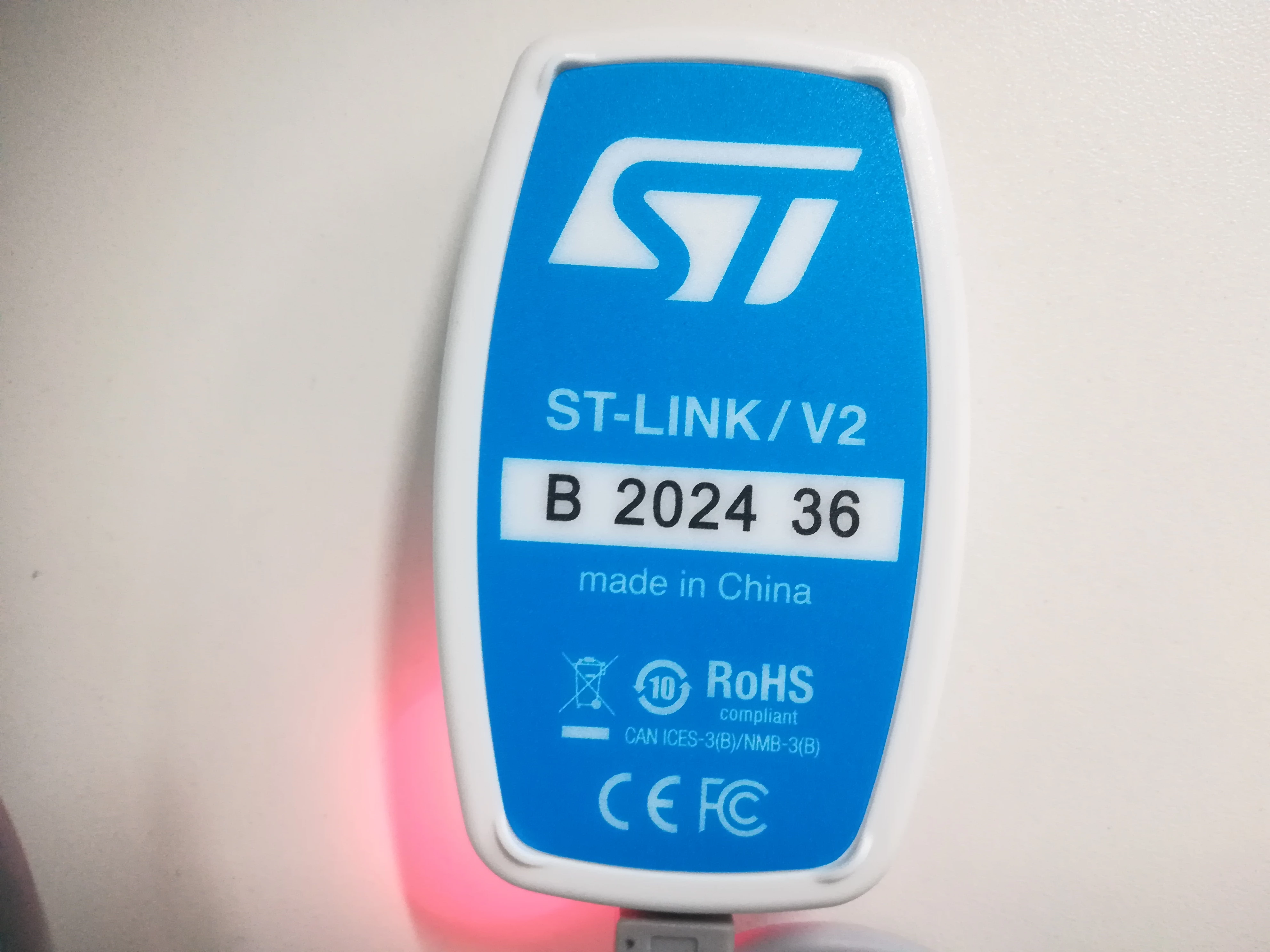

Is it a genuine ST-Link ?
See: How to recognize a genuine ST-LINK/V2 versus a cloned one
In particular, anything looking like this is fake!

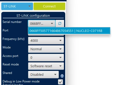

Andrew Neil
Apr 2, 2025 10:13 AM UTC
Use this drop-down to select which ST-Link to use:

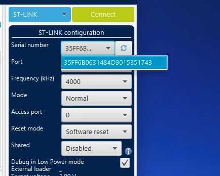

Apr 2, 2025 11:01 AM UTC
Here after the run the software Programmer without power on the board.

Andrew Neil
Apr 2, 2025 11:58 AM UTC
Those are the connections from the Target MCU to the ST-Link.
You also need to connect the ST-Link to the computer - via USB.
Again,  is your other ST-link a genuine ST one?
Apr 2, 2025 12:03 PM UTC
Here the photo
