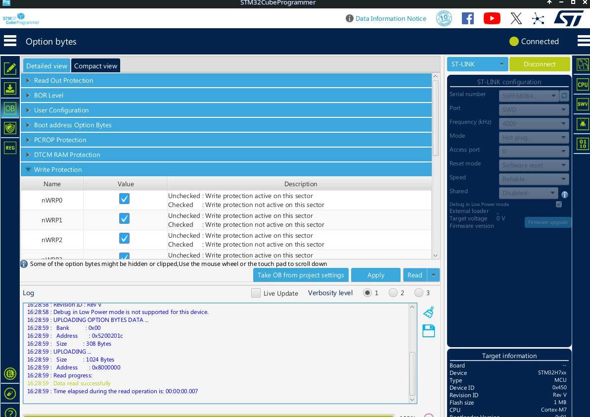

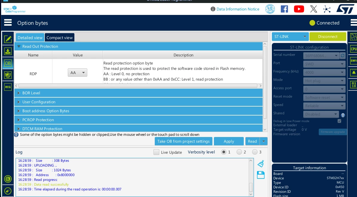

AScha.3
Jul 4, 2025 7:34 AM UTC
So connect it with CubeProgrammer, then check:
- rdp level   (do nothing here !!! just look, and show screenshot)
- option bytes
-> look at all blocks, there might be some with write protection active; set them to not protected.
Then try program/flash again.

Here my option bytes including rdp level:

AScha.3
Jul 4, 2025 2:34 PM UTC
I dont know, what you try to do...
just connect with CubeProg , then see OB  ...option bytes:
...then check for write protected blocks:
What you using to make the program ? CubeIDE ?
