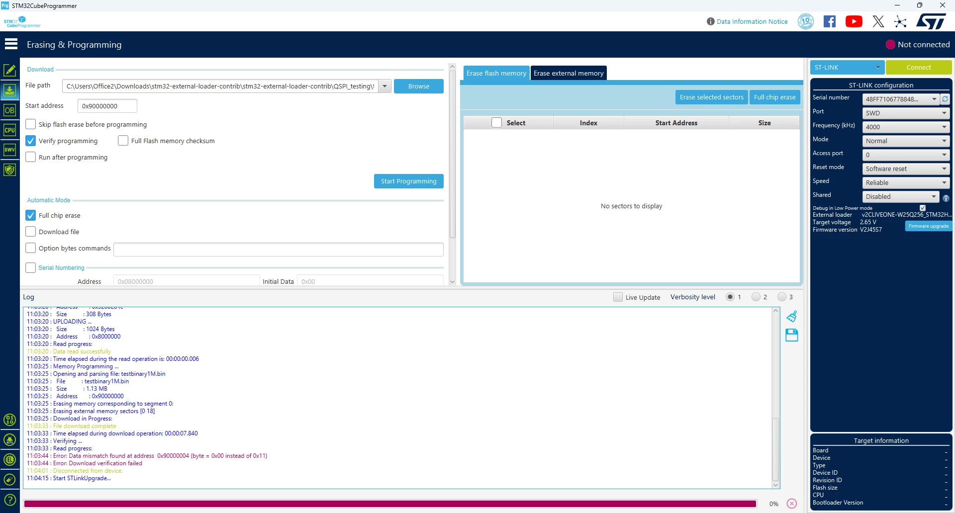

    mtechmattAuthor
    Aug 30, 2024 10:59 AM UTC
    Here is the CubeMX Prog output when loading the test file from the STM QSPI repo ( a 1mb file)

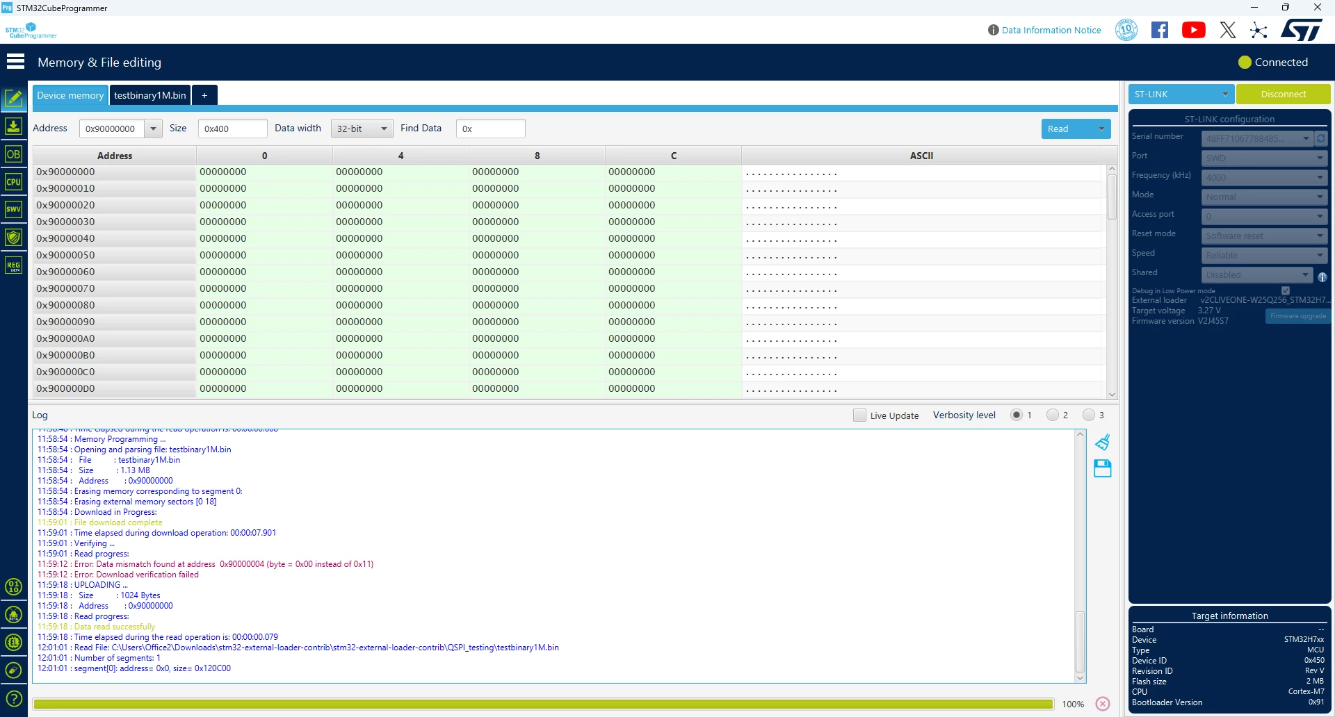

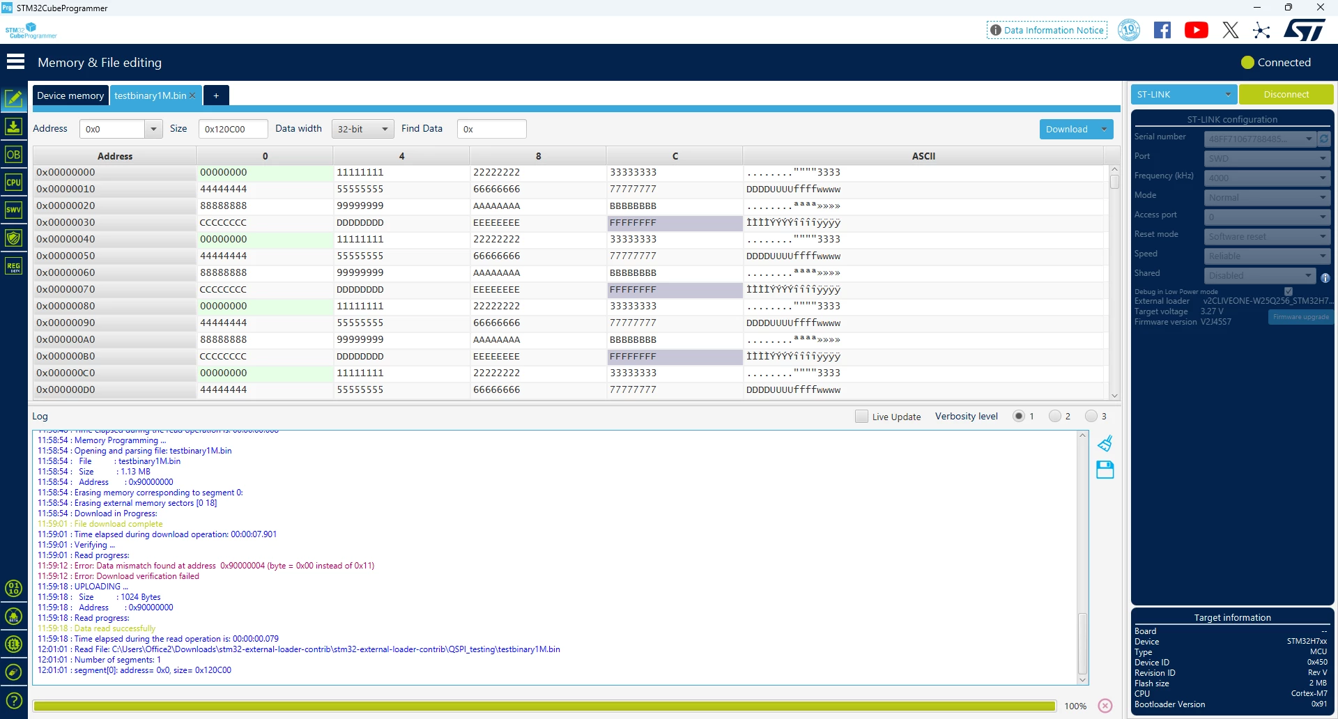

    mtechmattAuthor
    Aug 30, 2024 11:02 AM UTC
    Also, you can see the test binary contents:
    And the readback:
    So verification is rightly failing becuase the writing oft he data is not happening for some reason?
