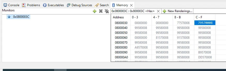

Piranha
Principal III
July 18, 2022
Open the memory view at 0x0800003C and check whether it contains the SysTick_Handler() address.
KiptonM
KiptonMAuthor
Senior III
July 18, 2022
0693W00000QLSZtQAP.pngFrom the .map file.
 .text.SysTick_Handler
        0x0000000008005778    0x8 ./Core/Src/stm32g0xx_it.o
        0x0000000008005778        SysTick_Handler
Why is it off by 1? 0x08005779? Should be a number divisible by 4 I would think.
It looks like all the vectors are odd numbers.

KnarfB
July 18, 2022
LSB 1 indicates thumb mode, looks correct.

KiptonM
KiptonMAuthor
Senior III
July 18, 2022
So I still do not know why when it calls this interrupt the debugger crashes. I was guessing the vector was wrong, but it appears correct.
I have a breakpoint for the first instruction in the ISR. It never breaks. The debugger just stops about 1 ms after we initialize the SysTick. That is what made me think it was a vector error. But everything looks good.
So I am back to not having a clue as to why it is no longer working. It has been working for more than 6 months, After I upgraded to the new version of IDE and MX it stopped working.
