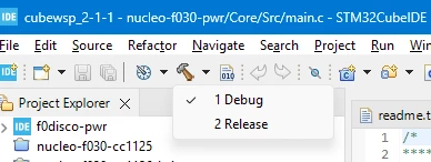

STM32CUBEMX2 and STM32CubeIDE 2.1.1 how to generate release file
I have ordered the Nucleo-C542C board. I am waiting on the board to arrive so I thought I would setup a blinky project to test on the board. i used MX2 to setup the GPIO, clock, etc. I then imported the project int CubeIDE using the CMAKE option.
Apparently there is no way to build a release file. This means I will not be able to program the board. The build hammer only shows the debug build option.

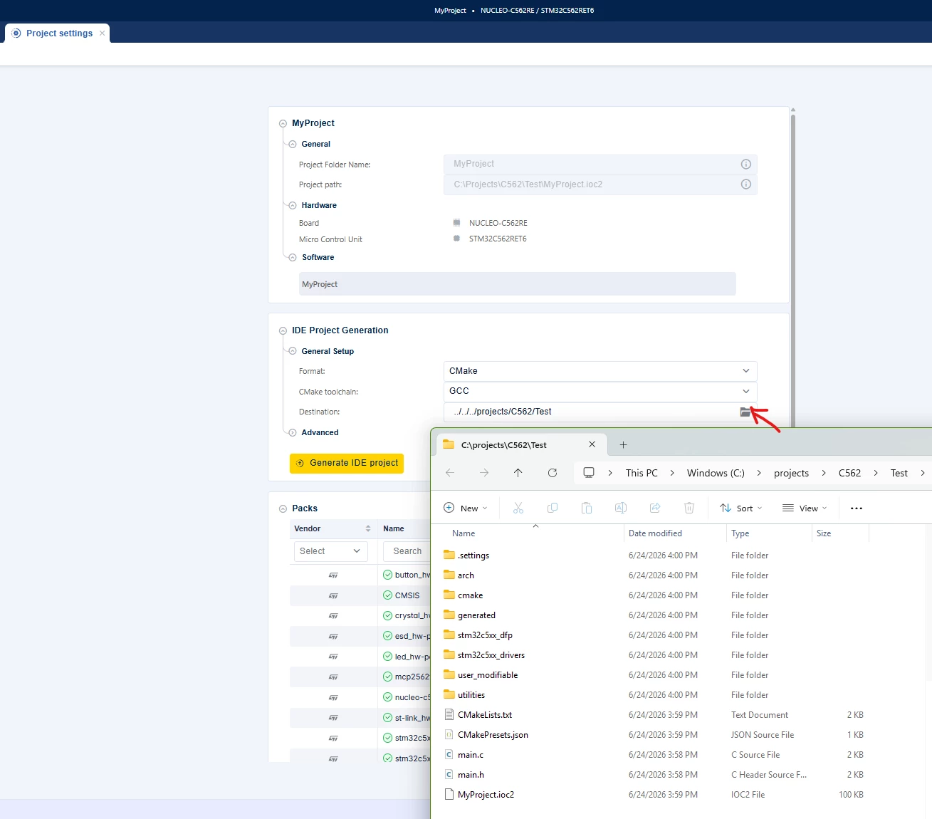

Also, I do not see the .ioc file in the project tree. Apparently I don’t understand how MX2 and CubeIDE link together. If I am able to ever find the .ioc file, will it be updated if I make changes in MX2? The old version of CubeMX linked the.ioc files together. If changes were made by CubeMX, those changes were reflected in CubeIDE.

At the moment, the release build configuration cannot be added via the STM32CubeMX2 GUI, but it is possible using the CLI.
For example, you can use a command similar to:
cube mx ide-project generate -p ./test.ioc2 --build-target .release_IAR+NUCLEO-C562RE --destination test_ewarm --format EWARM --source include-packs-from-local --force
An internal ticket has already been submitted to add the Release build configuration in the GUI and the team is currently working on it. I will keep you posted.
Not sure what you mean by that ?
You can certainly program the board with the Debug build!
Does your hammer button not give you the option to choose ‘Release’ ?

Andrew, that is correct. The only option under the hammer is Debug.
I have spent the last 4 hours using ChatGPG and Gemini trying to find a solution. According to both AI engines, there is no option to build a release file when using CubeMX2. Both of them say files have to be manually modified to have the Release option. So far, none of their suggestions have worked.
I don’t like the idea of using a debug file to program the board. If I look at the C/C++ build options for a debug file, there is no Post Build option so you can’t generate a hex file. If fact, there are not any options available to control the build steps. It appears if the project is built with MX2, no options are no longer available.

Can you explain why I can’t see the ioc file in the project tree? With the earlier versions of CubeMX generated projects, the ioc file was always at the bottom of the file list in the left panel.

Regarding the project tree and the .ioc2 file placement, by default the IDE project and the .ioc2 file are placed under the same workspace directory. For example:
Workspace
├── MyProject.ioc2
└── MyProject_cmake
However, you can use the Project Settings in STM32CubeMX2 to customize the project tree. For example, if you want to change the destination of the IDE project, simply click the folder icon, select the workspace, and adjust the path from the default location.
Please refer to the attached example:
I created a MyProject.ioc2 project under C:\projects\C562\Test. By default, the IDE project would be placed in C:\projects\C562\Test\MyProject_cmake, but I changed it to C:\projects\C562\Test.
Regards,
Sara.

Thank you, that helps. I will move mine to my root project folder so it is easily accessible.
