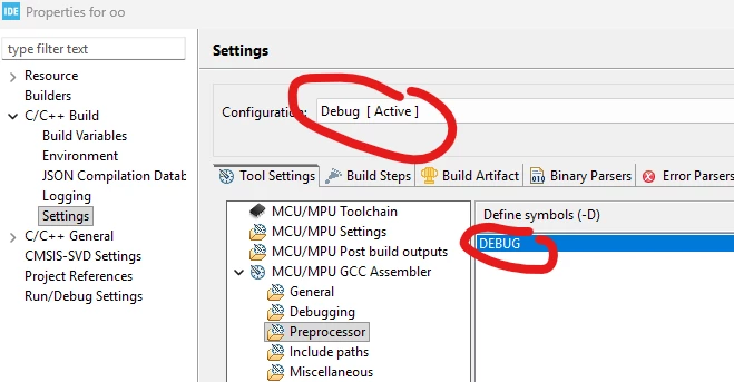

I generated a project using STM32CubeMX2 for Nucleo-C5A3ZG and I imported the project using the 'STM32CubeMX2 Project' option into STM32CubeIDE. I can compile and link the code without any issues however I noticed that there is only one build configuration (debug_GCC_NUCLEO-C5A3ZG for my project). Can STM32CubeMX2 also create a release  build configuration?
My second related question what is the best way to add compile flags? I managed to add a -DDEBUG flag to the flags.cmake file and it works fine. Is this the right way to do it? Would project regeneration be troubled by this change?
Finally, if I opted in for 'Assert checks on function parameters' and 'Assert checks on module state' in STM32CubeMX2 HAL System Init is there a way to only have this functionality enabled only for a debug build?

Then in the flags.cmake for for debug_GCC_NUCLEO-C562RE I defined the DEBUG flag:
target_compile_options(${CMAKE_PROJECT_NAME} PUBLIC "SHELL:-DDEBUG -g3 -O0 -fdata-sections -ffunction-sections -std=gnu11 -Wall -fstack-usage --specs=nano.specs --specs=nosys.specs -Werror=implicit-function-declaration ${CC_SECURE}")
