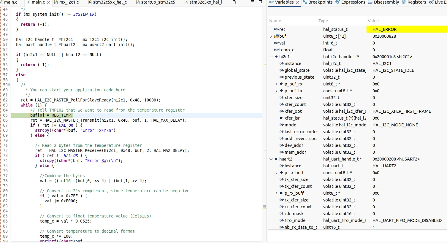

gpio_config.alternate = HAL_GPIO_AF_4;
There is no bug here. Why do you think there is? Look at the source:
#define HAL_GPIO_AF4_I2C1                HAL_GPIO_AF_4 /*!< I2C1 Alternate Function mapping        */
I cannot see Device found at
So probably the sensor is not powered or hooked up correctly. Use HAL_I2C_IsDeviceReady and ensure it returns HAL_OK before using any other I2C function.

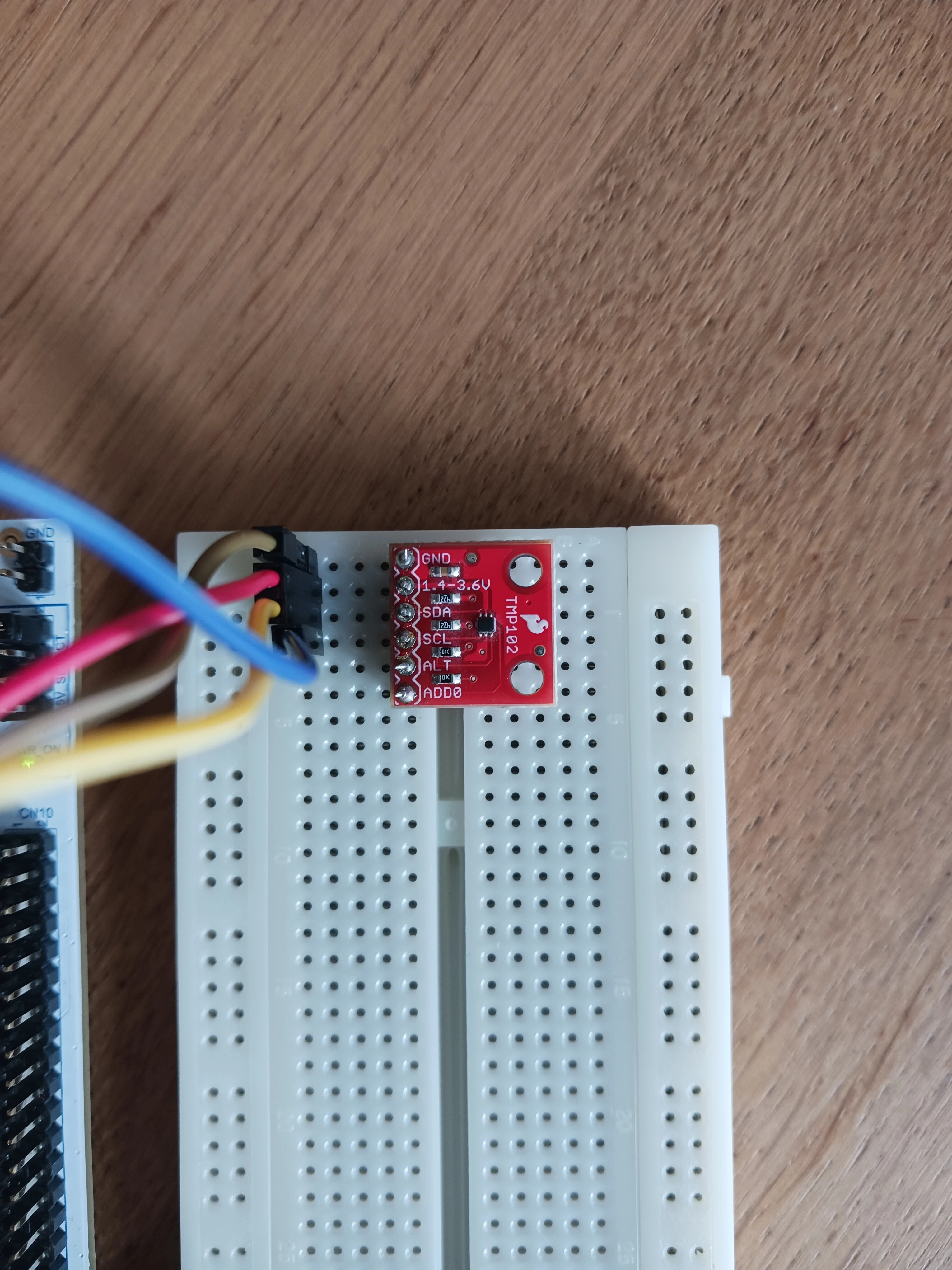

  • According to the documentation the TMP102 by  SparkFun does not need any external pull up.
  • The multimeter shows 3.33v stable for 1.4v-3.6v, SDA, SCL and ALT on the sensor
  • The attached image show the debugger after evaluating: ret = HAL_I2C_MASTER_PollForSlaveReady(hi2c1, 0x48, 10000);
  • Using TMP102_ADDR = 0x48 << 1; // Use 8-bit address gives the same HAL_ERROR
Manuel5Author
Visitor

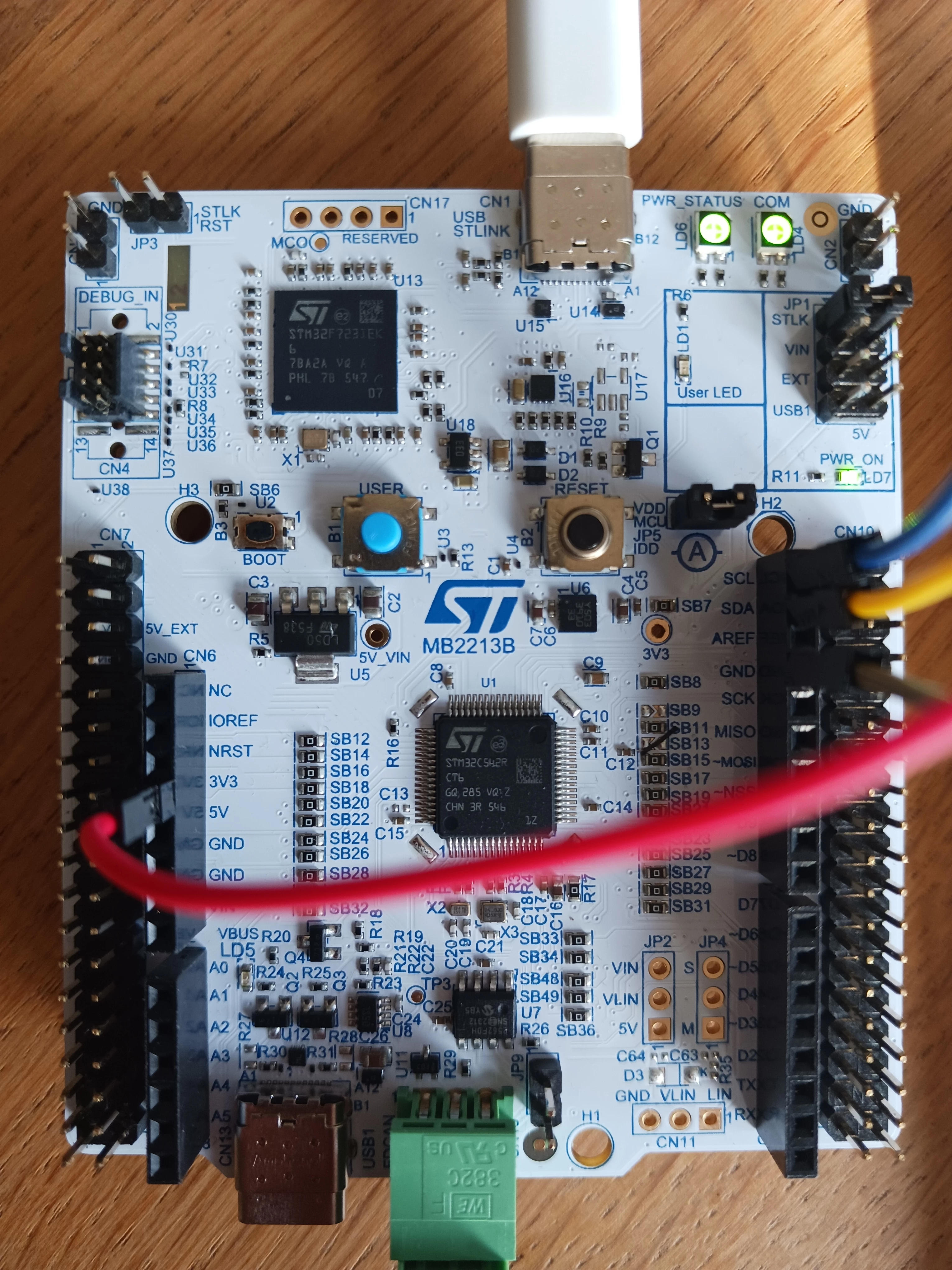

Sep 23, 2026 7:00 AM UTC
Wiring images also shared through photos.

Visitor
Sep 23, 2026 8:27 AM UTC
After rechecking the Data Sheet and User Manual I’ve found the issue:
I created a brand new MCU in STM32CubeMX2:
/* [GPIO Pin] ------> [Signal Name]
PB6 ------> I2C1_SCL
PB7 ------> I2C1_SDA
gpio_config.mode = HAL_GPIO_MODE_ALTERNATE;
gpio_config.output_type = HAL_GPIO_OUTPUT_OPENDRAIN;
gpio_config.pull = HAL_GPIO_PULL_NO;
gpio_config.speed = HAL_GPIO_SPEED_FREQ_LOW;
HAL_GPIO_Init(HAL_GPIOB, HAL_GPIO_PIN_6 | HAL_GPIO_PIN_7, &gpio_config);
The generation must match:
Table 15. ARDUINO® Digital[15:8] connector (CN5) pinout
Depicted in:
UM3615
STM32C5 Nucleo-64 board (MB2213)
The device is found and the temperature is being sent back.
Thanks for your support.
