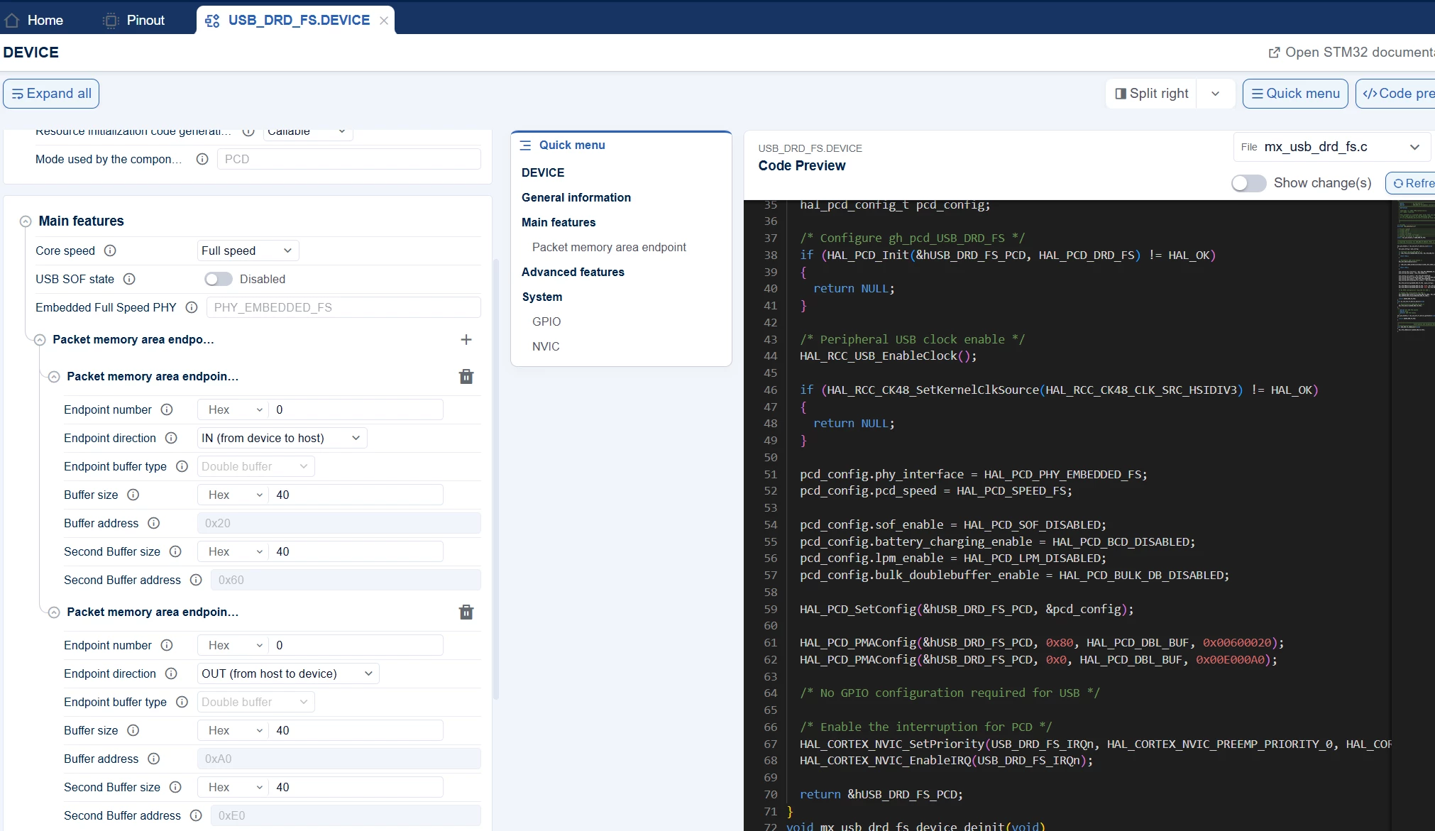

If i type in 1 as endpoint number, enable double buffering and then later switch to endpoint 0, double buffering is still enabled. Code generator will also generate code with double buffering on endpoint 0.

Double buffered endpoints are available for bulk and isochronous transfers (not for EP0). Check this article How to configure the packet memory area in STM32 USB controllers | Community

Yes, i know, but cubemx2 is generating code with double buffering on endpoint0, its a bug in cubemx2.

In my understanding, by default, EP0 is not configured in double buffer mode.
However, if the endpoint number is changed to a non zero value and set to double buffer mode, then later switched back to EP0, CubeMX2 may retain the double buffer setting. In that case, the generated code can incorrectly reflect a doubl buffer configuration on EP0.
This behavior appears to be an issue, since double buffering is not supported on EP0.
An internal ticket is submitted to dedicated team CDM0065230
