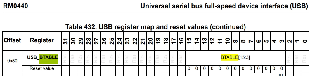

- COUNTn_TX and COUNTn_RX [9:0]: Specifies the number of bytes to be transmitted/received.
- ADDRn_TX and ADDRn_RX [15:0]: Points to the starting address of the transmission/reception buffer.
- USB_BTABLE register: Specific to version 1 and not present in version 2:

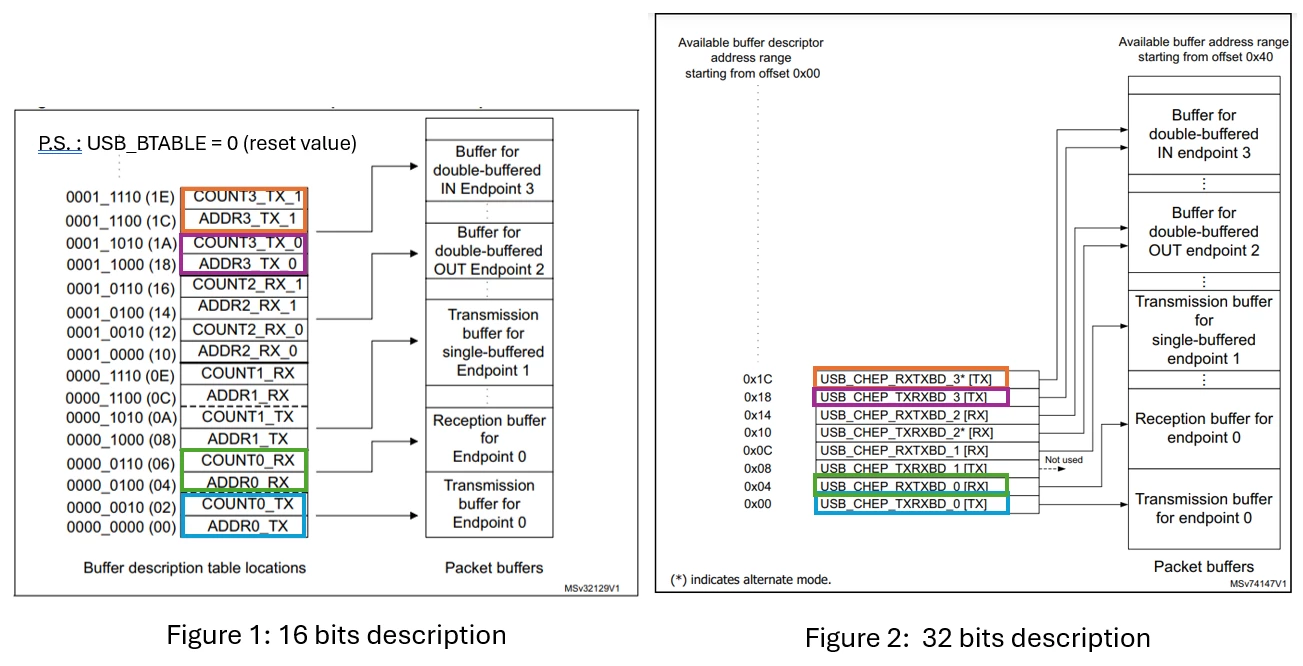

The following figures illustrate packet buffer areas with examples of buffer description table locations for two versions of USB controllers with minor changes.
Figure 1 is extracted from Figure 674 in RM0440 and Figure 2 from Figure 790 in RM0481.
- The diagram shows buffer descriptor registers (CHEP_TXRXBD_n) for endpoints 0 to 3, while support for buffer descriptors can be extended up to endpoint 7.
- The buffer descriptor table starts at offset 0x00.
- The packet buffers (actual data buffers) start from offset 0x40 in PMA.
- The available buffer address range could be optimized starting from offset inferior to 0x40.
0x40 is the worst case allocation.
