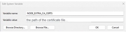

I assume this is due to a certificate issue, which prevented the packs from being installed.
In this case, what you need is to configure a proxy or a certificate to be able to access the servers and download packages.
  • Get your certificate from your company IT or company portal.
  • Place it under C:\certificate, for example.
  • Add the Windows environment variable NODE_EXTRA_CA_CERTS with the path to this certificate file. (Make sure that the path has no quotes.)
  • Finally, restart STM32CubeMX2.
You can also refer to this article for more details on: How to configure the proxy or certificate

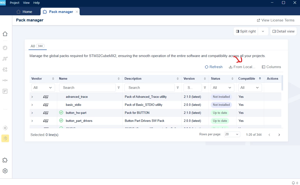

The following workaround allows you to bypass the online download step
  1. Download the packs from STM32 Package Creator
  2. Then install them in STM32CubeMX2 using “From Local”
Regarding the “Show in logs” option, you are right; it is currently not functional. I have submitted a ticket (CDM0064378) for a fix and will keep you posted. I have also submitted another ticket (CDM0064379) requesting that the logs path be added to the STM32CubeMX2 online documentation.
