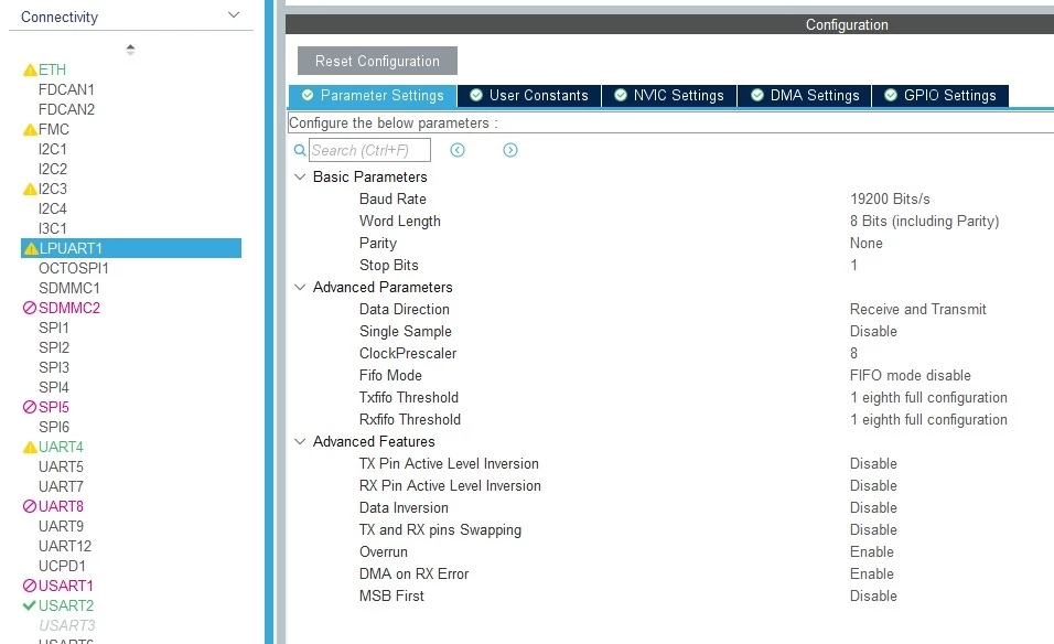

Is there any way to correctly specify the baud rate for different UARTs in STM32CubeMX?
I am currently using: STM32CubeMX V6.17.0 with STM32Cube_FW_H5_V1.6.0
I wanted to set the baud rate to 9600 for LPUART1, UART4, and USART2.
However, this isn't working; all three UARTs are outputting the same incorrect baud rate based on the calculated divider.
Instead of 9600 baud, transmission occurs at 3075 baud (a factor of 3.12195121951219512195:1 too slow).

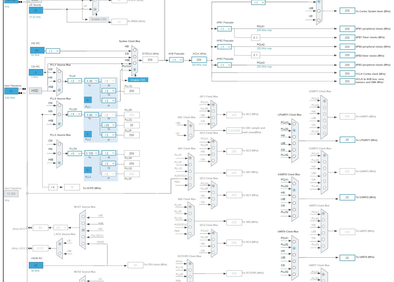

The external 25 MHz HSE oscillator is used as the clock source (original from the Nucleo Board).
PLL2Q is used as the clock source for each of the UARTs.

  • Changing the UART clock from 250 MHz to 25 MHz and 5 MHz,

UART initialization:
 MX_LPUART1_UART_Init();
MX_UART4_Init();
MX_USART2_UART_Init();
PLL-Init:
void PeriphCommonClock_Config(void)
RCC_PeriphCLKInitTypeDef PeriphClkInitStruct = {0};
/** Initializes the peripherals clock
PeriphClkInitStruct.PeriphClockSelection = RCC_PERIPHCLK_USART2|RCC_PERIPHCLK_UART4
|RCC_PERIPHCLK_LPUART1;
PeriphClkInitStruct.PLL2.PLL2Source = RCC_PLL2_SOURCE_HSE;
PeriphClkInitStruct.PLL2.PLL2M = 4;
PeriphClkInitStruct.PLL2.PLL2N = 80;
PeriphClkInitStruct.PLL2.PLL2P = 2;
PeriphClkInitStruct.PLL2.PLL2Q = 20;
PeriphClkInitStruct.PLL2.PLL2R = 2;
PeriphClkInitStruct.PLL2.PLL2RGE = RCC_PLL2_VCIRANGE_2;
PeriphClkInitStruct.PLL2.PLL2VCOSEL = RCC_PLL2_VCORANGE_WIDE;
PeriphClkInitStruct.PLL2.PLL2FRACN = 0;
PeriphClkInitStruct.PLL2.PLL2ClockOut = RCC_PLL2_DIVQ;
PeriphClkInitStruct.Usart2ClockSelection = RCC_USART2CLKSOURCE_PLL2Q;
PeriphClkInitStruct.Uart4ClockSelection = RCC_UART4CLKSOURCE_PLL2Q;
PeriphClkInitStruct.Lpuart1ClockSelection = RCC_LPUART1CLKSOURCE_PLL2Q;
if (HAL_RCCEx_PeriphCLKConfig(&PeriphClkInitStruct) != HAL_OK)
Error_Handler();

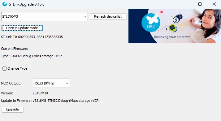

Did you fit SB3 and SB4 to use HSE since they are not fitted by default?
A factor of 3 exists between the configured baud rate and the expected baud rate. This difference can result from the use of the STLINK-V3 MCO output.
Open STM32CubeProgrammer, and click Firmware upgrade. Then open the tool in update mode, check the clock frequency in use, and enter that value as the input frequency instead of 25 MHz to obtain correct values.

Wonderful. That was the solution.
