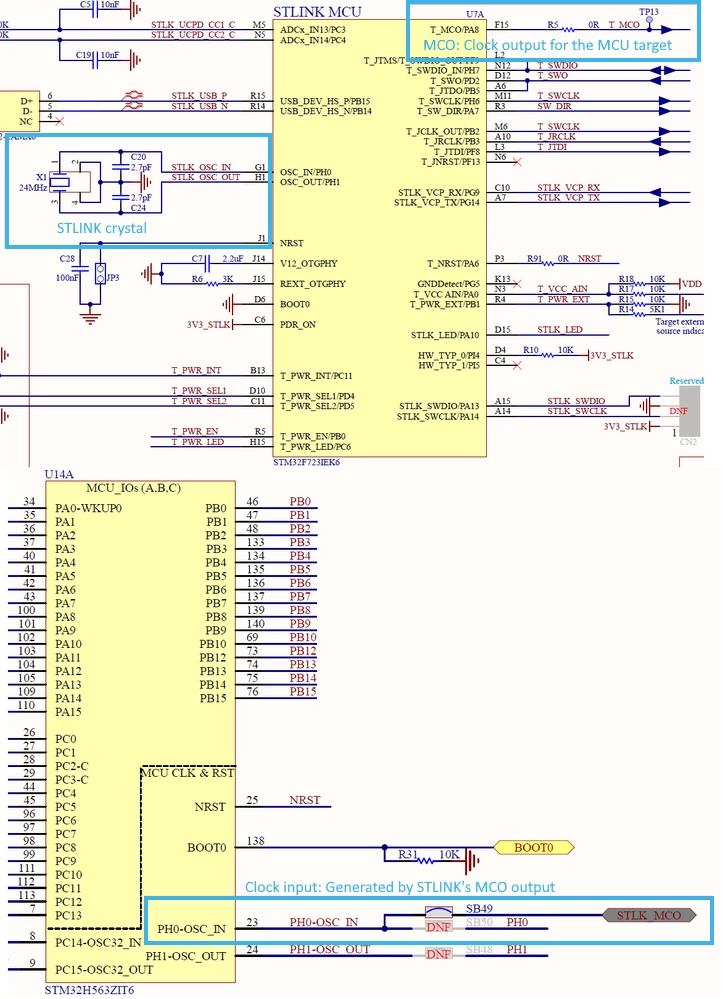

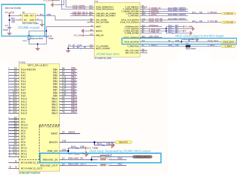

The following figures are the parts of schematics of NUCLEO-H753ZI (MB1364), and NUCLEO-H563ZI (MB1404).
The two schematics (figure 2 and figure 3) show how the STLINK-V3 module is clocked and how the MCO output is feeding the HSE of the target MCU. The MCO output is connected over a resistor and a solder bridge. Refer to the schematics of the respective board for more details.
Figure 2. NUCLEO-H753ZI: STLINK crystal oscillator of 25 MHzFigure 2. NUCLEO-H753ZI: STLINK crystal oscillator of 25 MHz
Figure 3. NUCLEO-H563ZI: STLINK crystal of 24 MHzFigure 3. NUCLEO-H563ZI: STLINK crystal of 24 MHz

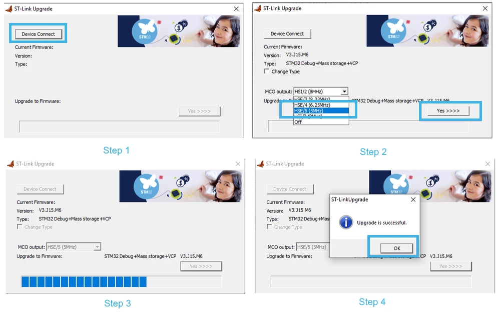

For the STLINK firmware upgrade tool, you need to follow these steps (see figure 4):
  • Step 1: Open the STLINK firmware upgrade tool and click the [Device Connect] button.
  • Step 2: Select the frequency that you need to output on the STLINK MCO and click the [Yes >>>] button to proceed for the update.
  • Step 3: Wait for the update to be completed. In the meantime, the STLINK LED is blinking.
  • Step 4: You receive a prompt that the upgrade was successful. Click the [OK] button.
Figure 4. Using ST-LINK firmware upgrade tool to modify the MCO frequencyFigure 4. Using ST-LINK firmware upgrade tool to modify the MCO frequency

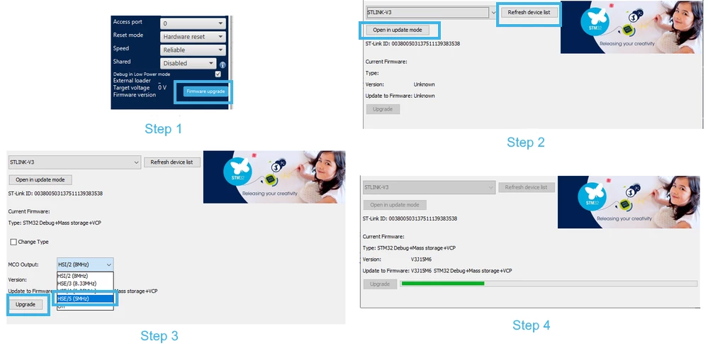

For the STM32CubeProgrammer tool, you need to follow these steps (see figure 5):
  • Step 1: Open the STM32CubeProgrammer tool and click the [Firmware upgrade] button.
  • Step 2: A new window is opened. Click on [Refresh device list]. STLINK ID needs to be displayed under the button [Open in update mode]. Then click on this button to let STLINK enter the upgrade mode.
  • Step 3: In the [MCO Output] menu, select the needed frequency and click [Upgrade] button.
  • Step 4: The upgrade will start and the STLINK LED is blinking. Wait until the progress bar reaches 100%. The STLINK firmware is updated.
Figure 5. Using STM32CubeProgrammer tool to modify the MCO frequencyFigure 5. Using STM32CubeProgrammer tool to modify the MCO frequency

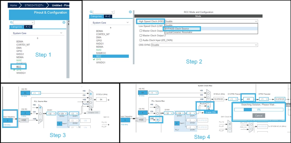

2.2. The MCU target clock configuration
The RCC of the MCU target needs to be configured to set STLINK-V3 MCO output as an external clock source. To do so, the RCC needs to be configured in Bypass mode. For more details about this configuration, refer to the respective reference manual and the datasheet of the MCU product.
Example: we need to set the system clock of the STM32H753 MCU (on NUCLEO-H753ZI) at 400 MHz and the RCC in Bypass mode with a clock source HSE of 5 MHz using STM32CubeMX tool:
  • Step 1: Go to the [Pinout & Configuration] tab and click [RCC].
  • Step 2: In the [Mode] menu, select [Bypass Clock Source] for [High Speed Clock (HSE)].
  • Step 3: Go to the [Clock Configuration] tab and set the [Input frequency] in the blue box to the same value already set for STLINK-V3 MCO (see section 2.1.) In this example, 5 MHz is set.
    Warning: Set the same input frequency value as the one configured on STLINK-V3. If the input frequency is not the same, the clock configuration is incorrect, and issues will appear in the application.
  • Step 4: Select [HSE] as an external clock source of the MCU, then select [PLLCLK] as a source clock of the system. Finally, type the desired system frequency in the writable box and hit the [Enter] key and wait until STM32CubeMX compute all the possibilities to set the final configuration. In this example, 400 MHz is selected as the system frequency.
