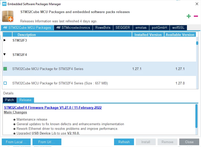

MM..1
MM..1Author
November 10, 2022

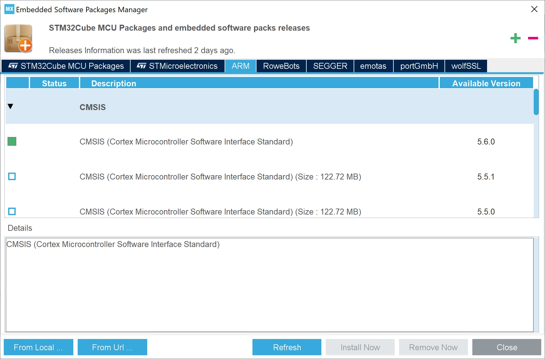

I ever use my stable IDE and compare with latest, now 1.7 vs 1.10
In 1.7
0693W00000WHy7YQAT.png0693W00000WHy87QAD.png0693W00000WHy8CQAT.pngand PS 1.27.1 have file
 * @version V1.5.3
 * @date 10. January 2018
same as 1.26.1 , but older as from ioc MX in 1.7

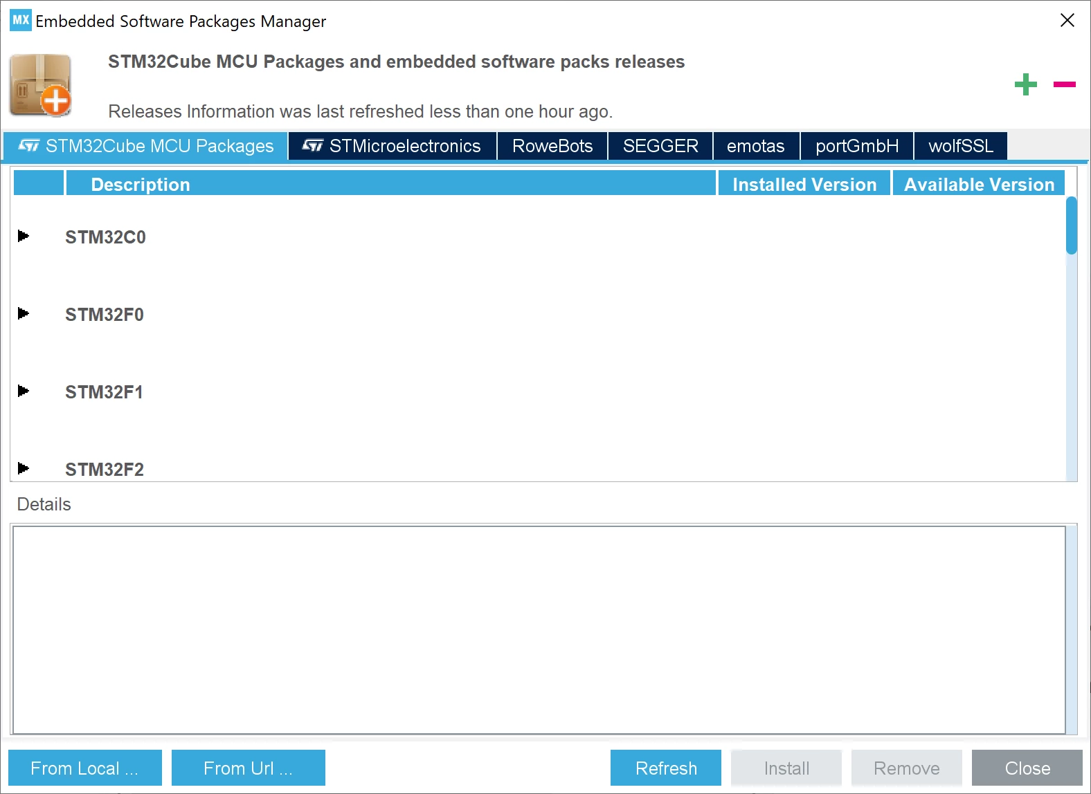

On the latest STM32CubeIDE there is no left-side listing for Software Packs, I can't see any option anywhere to select CMSIS DSP packages.

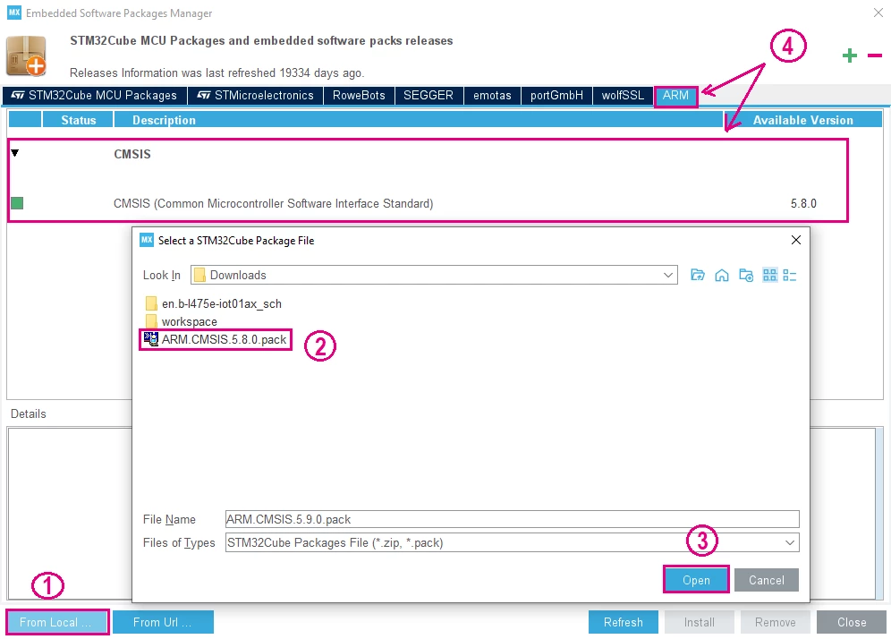

Sara BEN HADJ YAHYA
December 8, 2022
Hello @MM..1​ , @Robmar​ , @eLuigi​ ,
Thanks for your feedback,
The CMSIS pack can be downloaded from arm website and then imported locally in CubeMX, please refer to the picture below,
0693W00000WKYO0QAP.pngI hope this helps !
If your issue is solved, please close this post by clicking the "Select as Best" button. This will help other members of the community find this response more quickly :)
Sara.

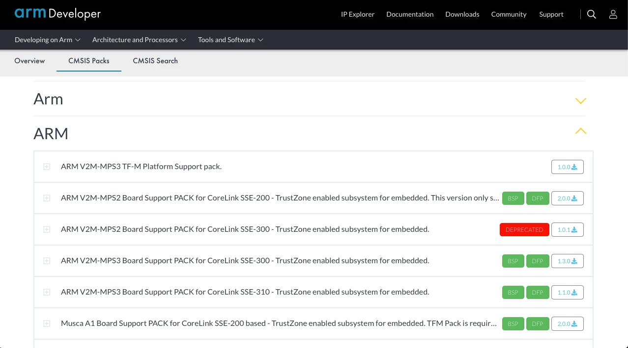

eLuigi

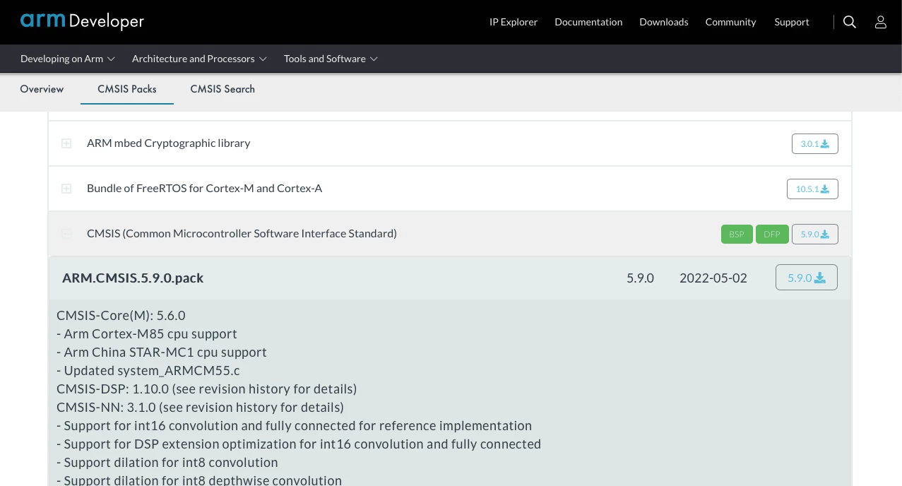

December 8, 2022
Hello @Robmar​,@Sara BEN HADJ YAHYA​ ,@MM..1​
First, thank you @Sara BEN HADJ YAHYA​ for your help!
You can find the package at this url https://developer.arm.com/tools-and-software/embedded/cmsis/cmsis-packs
The package 5.8.0 works for me but not the 5.9.0

Robmar
Senior II
December 8, 2022
Thanks for that! Your link opens to a long list, and under "ARM" (not Arm! - you'd think they'd not use identical names for different things!)
I can see CMSIS Embedded Compute Library, but only version 1.10 to 1.14.1.
Could you give an exact link to the correct reference?

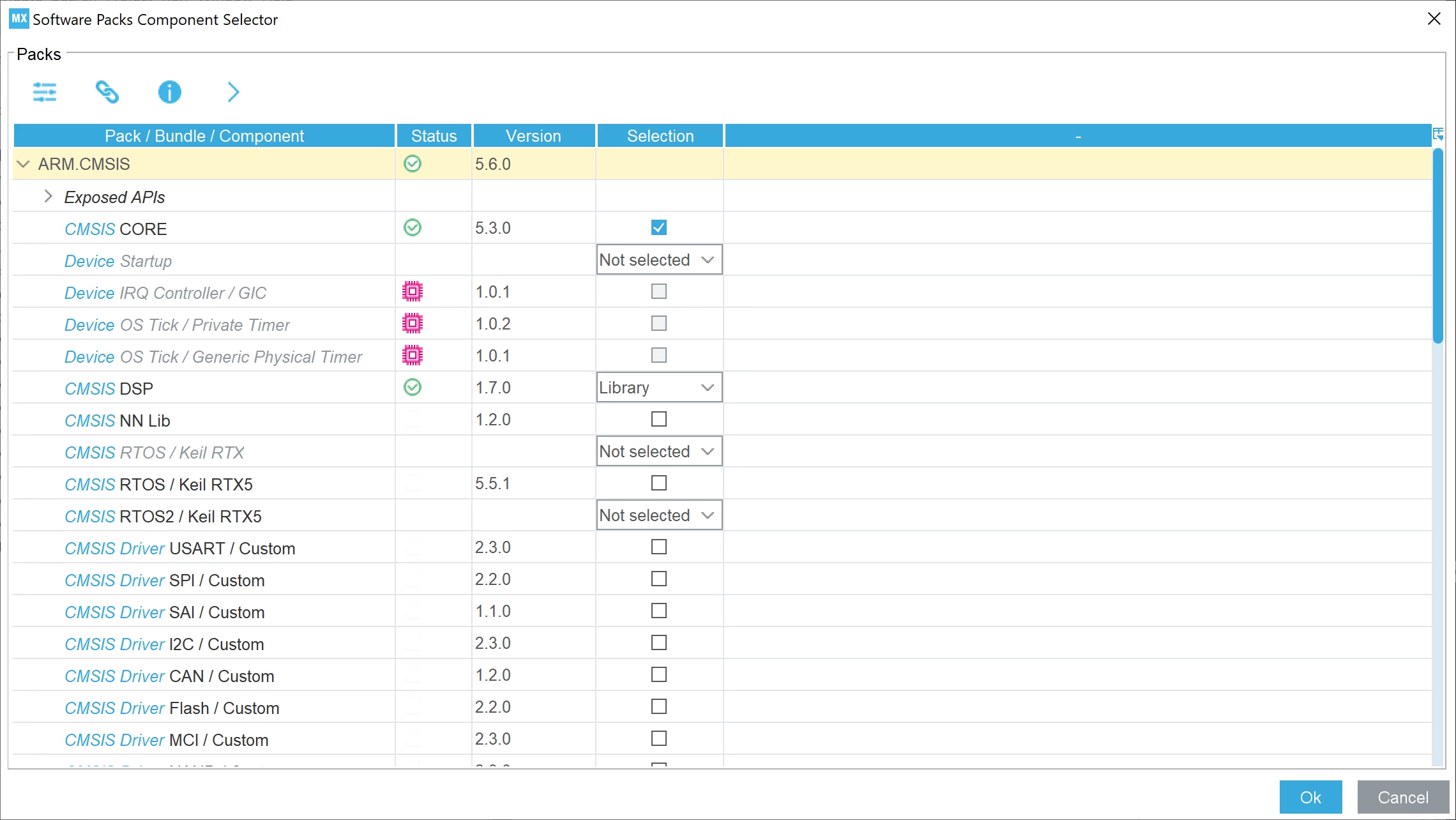

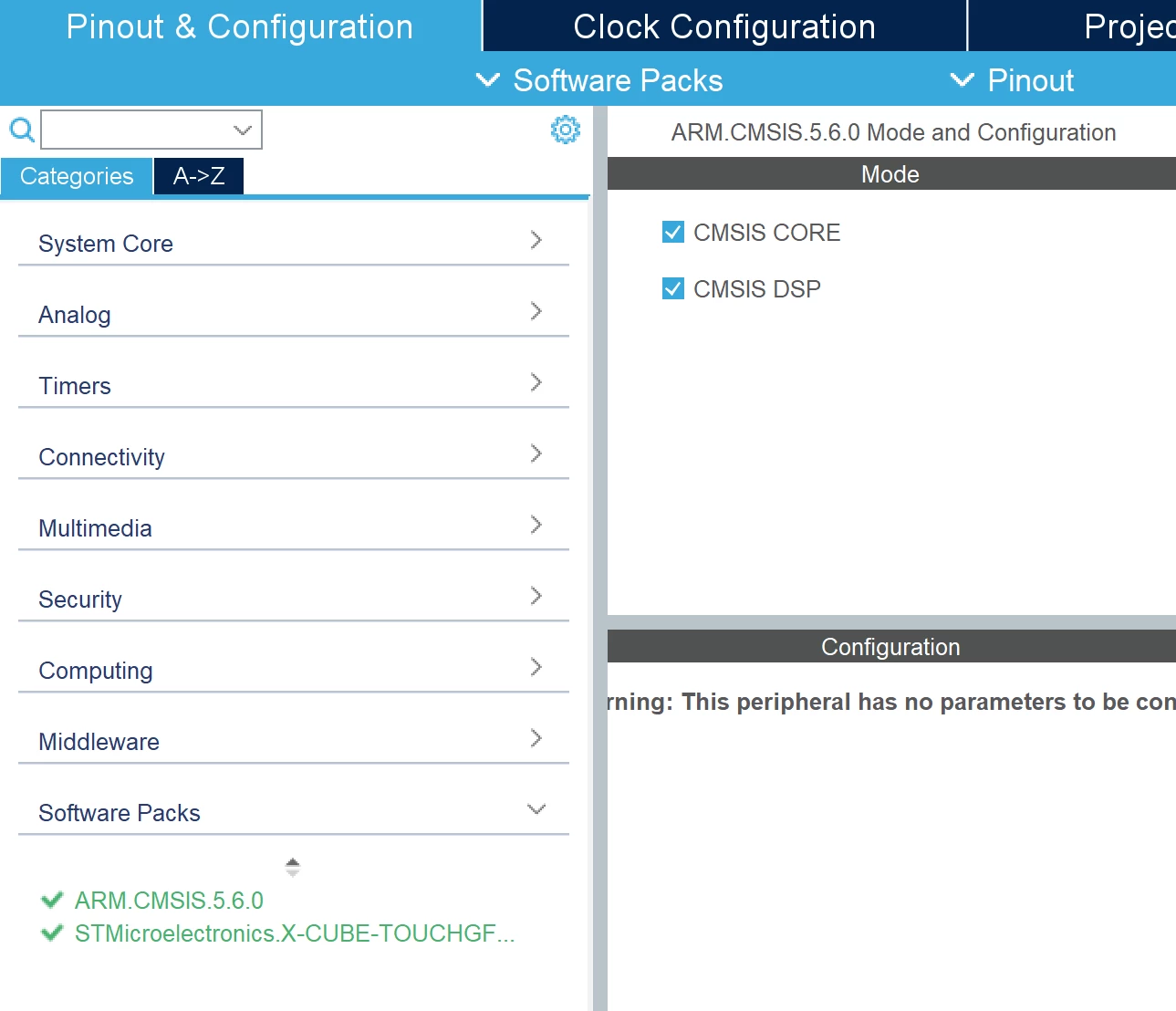

December 30, 2022
What a pain, so finally got around to trying to test our code with the CMSIS DSP, went into the component selector, selected CMSIS modules, DSP, and clicked OK, as there was no big flashing INSTALL button, and nothing happened!
It didn't install the DSP folder after code generation, sure this is easy right, but obvious it is not.
Any pointers?
C. Mart
February 1, 2023
Man you seem to have an issue with comprehensive reading. You probably ignored the warning given by the component selector, and did not enable CMSIS CORE. CMSIS DSP stands on top of CMSIS CORE.
You're probably going to continue having issues that you're not going to know how to resolve by yourself. I suggest you to ignore the component selector and just copy and paste the source code:
