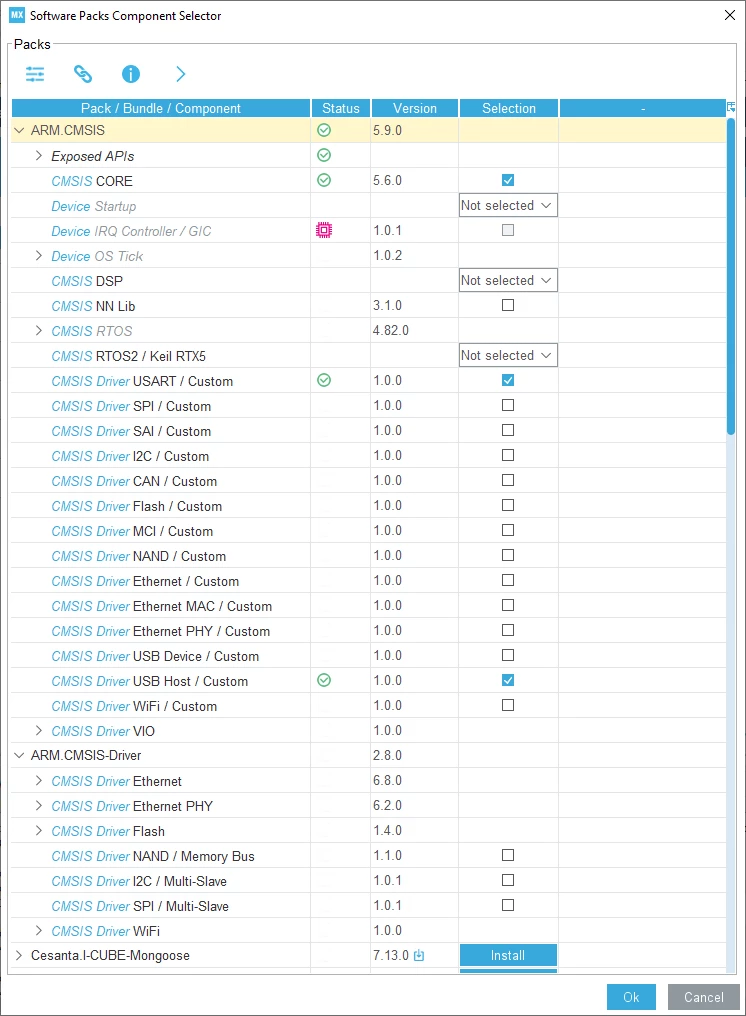

Jul 26, 2024 12:57 PM UTC
I'm also having problems installing this CMSIS stuff.  In my case I want to use it with USB-Host.
I have downloaded and installed:
- ARM.CMSIS.5.9.0.pack
- Keil.STM32F4xx_DFP.2.17.1.pack
Here is what I have configured in stm32cubeide:
Is this enough? (Why is there no USB under ARM.CMSIS-Driver?)
So now I want to take a first step with USB.
On this page I found some example code.
https://arm-software.github.io/CMSIS_5/develop/Driver/html/group__usbh__host__gr.html#gab11e67e11e7a0edbc8a1afa86b971784
So, I added the first two lines of the example code into my source code:
extern ARM_DRIVER_USBH Driver_USBH0;
ARM_DRIVER_USBH *drv_info;
And this fails...
So, what do I need more?  An include file, perhaps? But which one? I'm clueless where to find it.
Or perhaps more driver sources? If so, where could I find it?
I would like to see an example of how to use CMSIS in STM32CubeIde for use with USB Host, but Google and Youtube have not been helpful so far.
