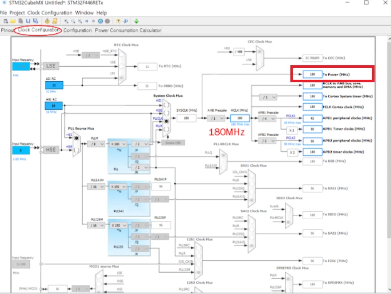

what is To Power???
0693W00000AMRdnQAH.pnghello
I use STM23CubeMX, but i have question.
what is To Power????
why to connect system clock to to power??
4 replies
Uwe Bonnes
Chief
April 25, 2021
This is probably the clock for the power controller (PWR)
waclawek.jan
April 25, 2021
Probably not, as PWR is on APB1.
Uwe Bonnes
Chief
April 25, 2021
RM0390 in Fig 14 has a path to "Power ctrl clock"
waclawek.jan
April 25, 2021
Humm.
Maybe related to https://community.st.com/s/question/0D50X00009XkaCJSAZ/f446-documentation-what-is-ckgatenr-in-rcc (which of course still explains nothing).
