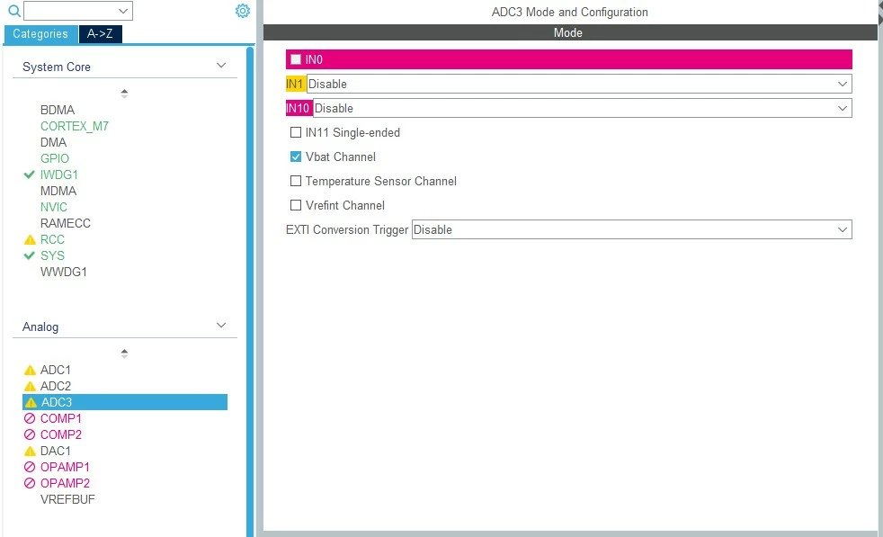

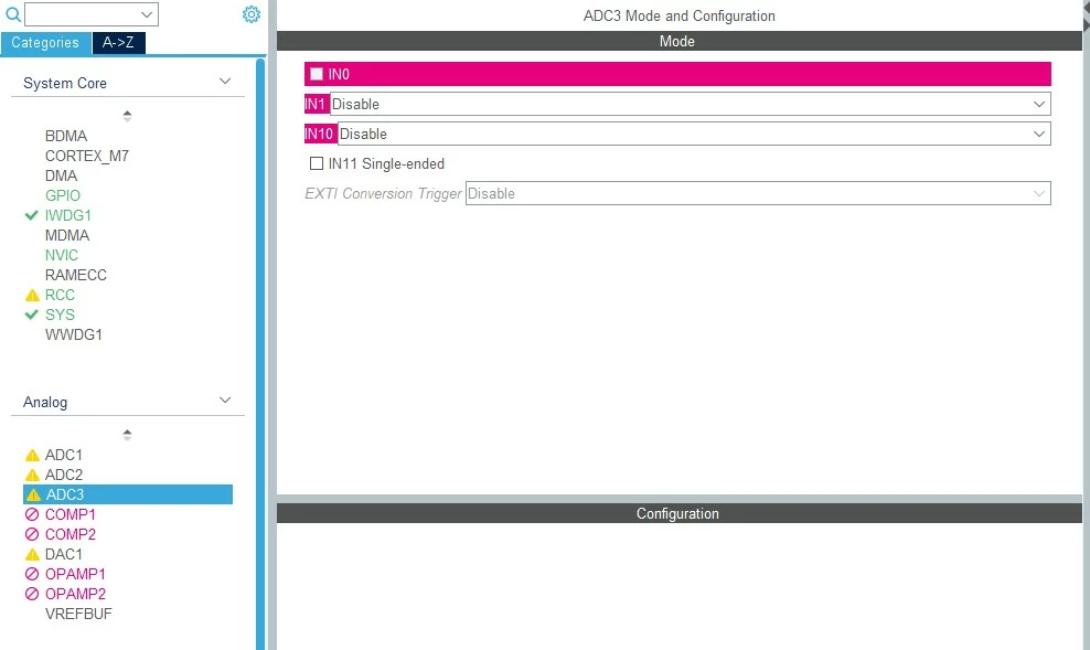

Vbat ADC setting is missing in the new version
Hi, i'm using STM32H750VB and i could previously make the Vbat measurement setting under Analog->ADC3 in the old version of cubemx (6.10), but this option has been removed in the new version (6.11). Also the temperature sensor setting is lost.
Is this a bug ?

It’s a known regression in CubeMx version V6.11.
See and follow this thread.

Here is the fix in ADC-aditf5_v3_0_Cube_Modes.xml file for STM32H7
For Vbat Channel:
From:
<Mode Name="IN-Vbat" RemoveCondition="(DIE480 &amp;!($IpNumber=2)) | !(DIE485&amp;($IpNumber=2))" UserName="Vbat Channel">
To:
<Mode Name="IN-Vbat" RemoveCondition="(DIE480 &amp;!($IpNumber=2)) | (DIE485&amp;!($IpNumber=2))" UserName="Vbat Channel">
For Temperature Sensor Channel:
From:
<Mode Name="IN-TempSens" RemoveCondition="(DIE480 &amp;!($IpNumber=2)) | !(DIE485 &amp;($IpNumber=1))" UserName="Temperature Sensor Channel">
To:
<Mode Name="IN-TempSens" RemoveCondition="(DIE480 &amp;!($IpNumber=2)) | (DIE485 &amp;!($IpNumber=1))" UserName="Temperature Sensor Channel">
For Vrefint Channel:
From:
<Mode Name="IN-Vrefint" RemoveCondition="(DIE480 &amp;!($IpNumber=2)) | !(DIE485 &amp;($IpNumber=1))" UserName="Vrefint Channel">
To:
<Mode Name="IN-Vrefint" RemoveCondition="(DIE480 &amp;!($IpNumber=2)) | (DIE485 &amp;!($IpNumber=1))" UserName="Vrefint Channel">
