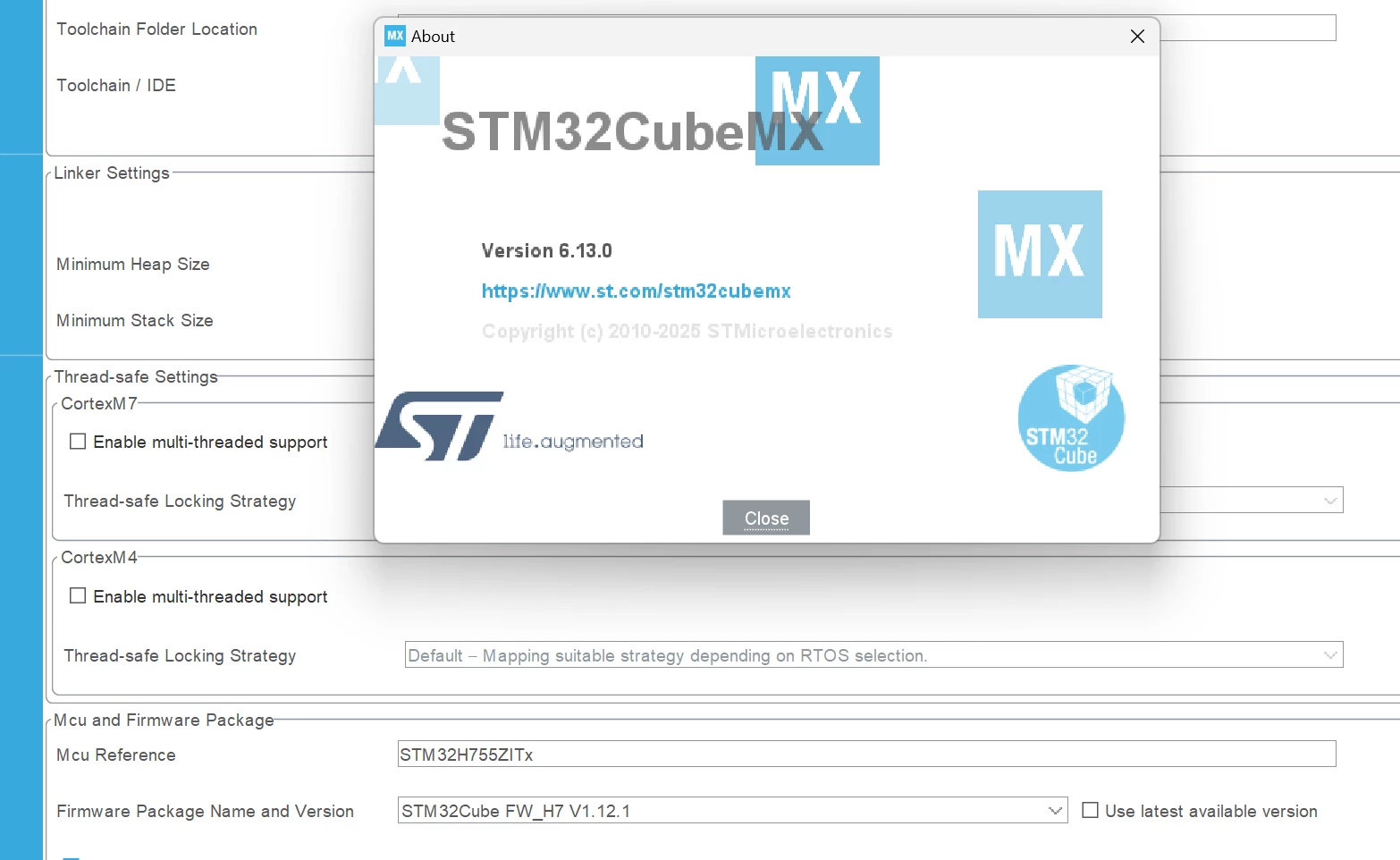

Hi, @Amel NASRI
By the way, RCC clock auto configuration is also wrong.
but result showing:
which will mess up UART baud rate ( I have to chage UART clock source to HSI to get correct UART output, the old is PCLK1), same issue as the post you linked.
CubeMX 6.13.0 and MCU Package H7 v1.12.0 produce i... - STMicroelectronics Community
These issues are fundamental, need to be resloved with high priority.
Peter

Peter3718Author
January 2, 2025
Hi @Amel NASRI ,
I was aware that 1.12.1 has a bug fix about RCC. But the wrong result is with the latest firmware 1.12.1 and 6.13.0 MX
peter
Amel NASRI
January 2, 2025
OK I get it. It looks like STM32CubeMX generated code doesn't consider the updated template for system_stm32h7xx_dualcore_boot_cm4_cm7.c. I reported this issue internally (199524).
The correct one should be based on the template available under STM32Cube_FW_H7_V1.12.1\Drivers\CMSIS\Device\ST\STM32H7xx\Source\Templates.
In the file <generated_prj>/Common/Src/system_stm32h7xx_dualcore_boot_cm4_cm7.c, try to replace:
const uint8_t D1CorePrescTable[16] = {0, 0, 0, 0, 0, 0, 0, 0, 1, 2, 3, 4, 6, 7, 8, 9};
by
const uint8_t D1CorePrescTable[16] = {0, 0, 0, 0, 1, 2, 3, 4, 1, 2, 3, 4, 6, 7, 8, 9};
That should fix the issue.
