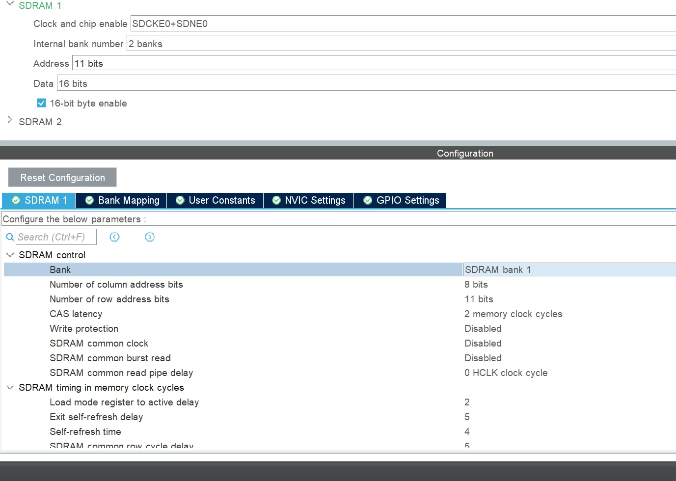

STM32H730ZB - SDRAM BANK1 wrong address
I create a new project with STM32CubeIde 1.15.1 (but same with 1.10.1)
I add SDRAM 1 - BANK 1
When I debug this project, after HAL_SDRAM_Init function in MX_FMC_Init(), I can wath the memory in MEMORY BROWSER at address 0x60000000.

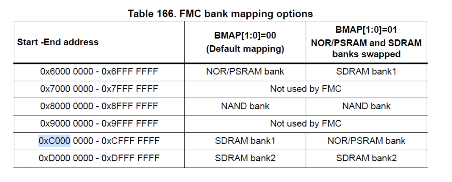

But on reference manual, SDRAM should be at 0xC0000000.

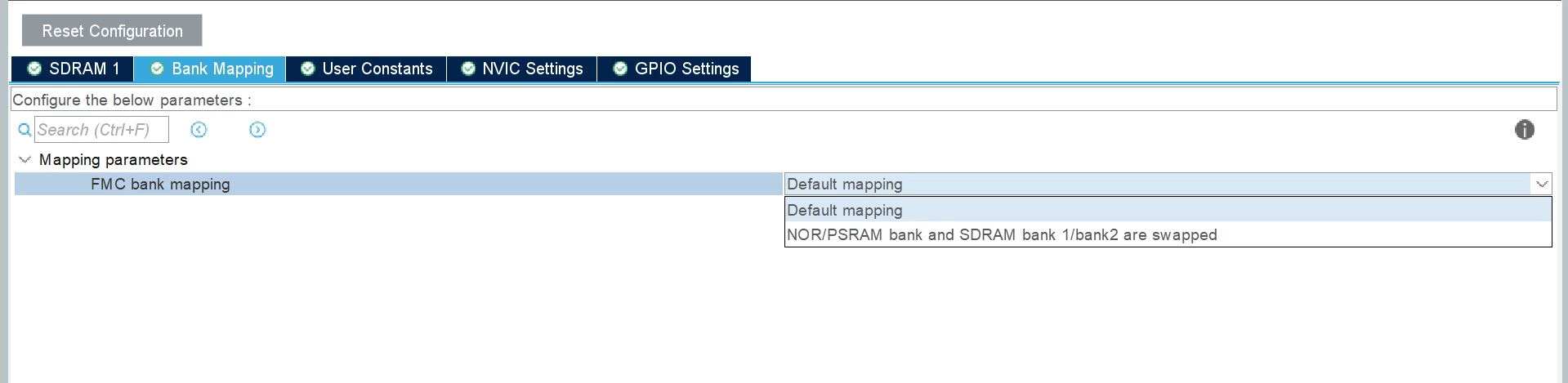

I select Default mapping in Bank Mapping :
If I select bank swapped, I have my datas at 0xC0000000.
Is it a bug of STM32CubeIDE ?

Isn't 0x60000000 the NOR FLASH on the STM32H743I-EVAL board?
What about after it's finished SDRAM_Initialization_Sequence() ??

Honestly I think this problem is compounded because the Hardware has 0 / 1 signal designations, and then you refer to SDRAM Bank 1 and Bank 2, and the SDRAM chip itself has it's own understanding of "banks", with BA0 / BA1
ie
SDNE0 / SDCKE0 -> SDRAM1 aka BANK 1 -> 0xC0000000
SDNE1 / SDCKE1 -> SDRAM2 aka BANK 2 -> 0xD0000000
Given how systemic this has become, going to hard to rationalize it now..

Well, if that, It should be on every STM32H7, but it woks with STM32H7B3.
If that, I should have wrong address 0xC0000000 / 0xD0000000 but not 0xC0000000 / 0x60000000
