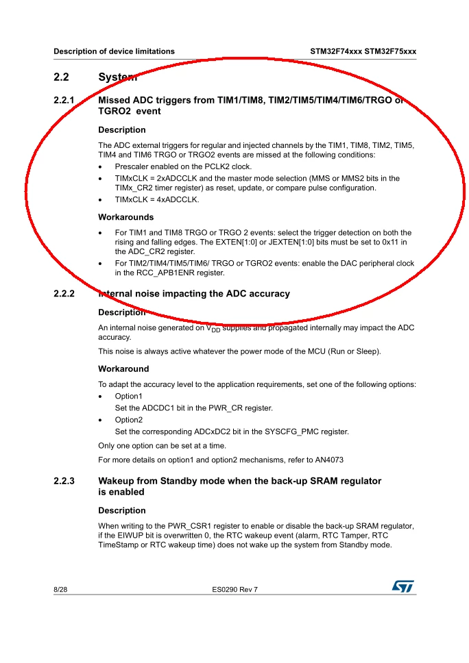

Hard to tell from your description, but maybe this erratum
0693W00000aH4DlQAK.pngThe workaround for  TIM2/TIM4/TIM5/TIM6 is charming and I wonder how does it work...

Feb 17, 2023 9:07 AM UTC
Thank you very much for your answer.
As it turns out I had actually downloaded the wrong Errata sheet (for STM32F76xxx instead of STM32F74xxx).
Nevertheless I just tried these workarounds, but they didn't help.
But since it is working now with TIM1 I'm okay with that.
Thanks again.

Many errata are written badly - they often omit describing root of the problem or describe it only very vaguely (probably because of guilt/shame), and the workarounds are often incorrect or improperly described with missing vital details (that's poor sloppiness, I guess errata are written by the design engineers who don't have proper application experience and are too proud to ask for applications engineers for help/review/feedback. The culture of pushing Cube, i.e. hiding the real problem by adding mysterious steps in "libraries" instead of properly describing the problem and workaround, is certainly part of the problem.
In this particular case, it appears to be that for the workaround to work you need to enable DAC clock before ADC clock. I can imagine that both DAC and ADC share a common timer-trigger-resynchronizer block, which may go like "after DAC or ADC clock enabled, wait until the next APB clock edge, and start the synchronization machine from there", with bug in the "after DAC or ADC clock enabled" part, working only if DAC is enabled first.
[EDIT] Uhm, no, the Cube example does it just before starting the timer. The underlying principle may be similar, though.
Also, I had a faint recollection, I've read about this already, somewhere... and, indeed... :)
SFahr
SFahrAuthor
Feb 17, 2023 10:51 AM UTC
Enabling the DAC clock actually did the trick!
(So I got me the wrong errata sheet and when I got the right one, I made some mistake when I tried to implement the workaround... now that's worth some guild and shame).
