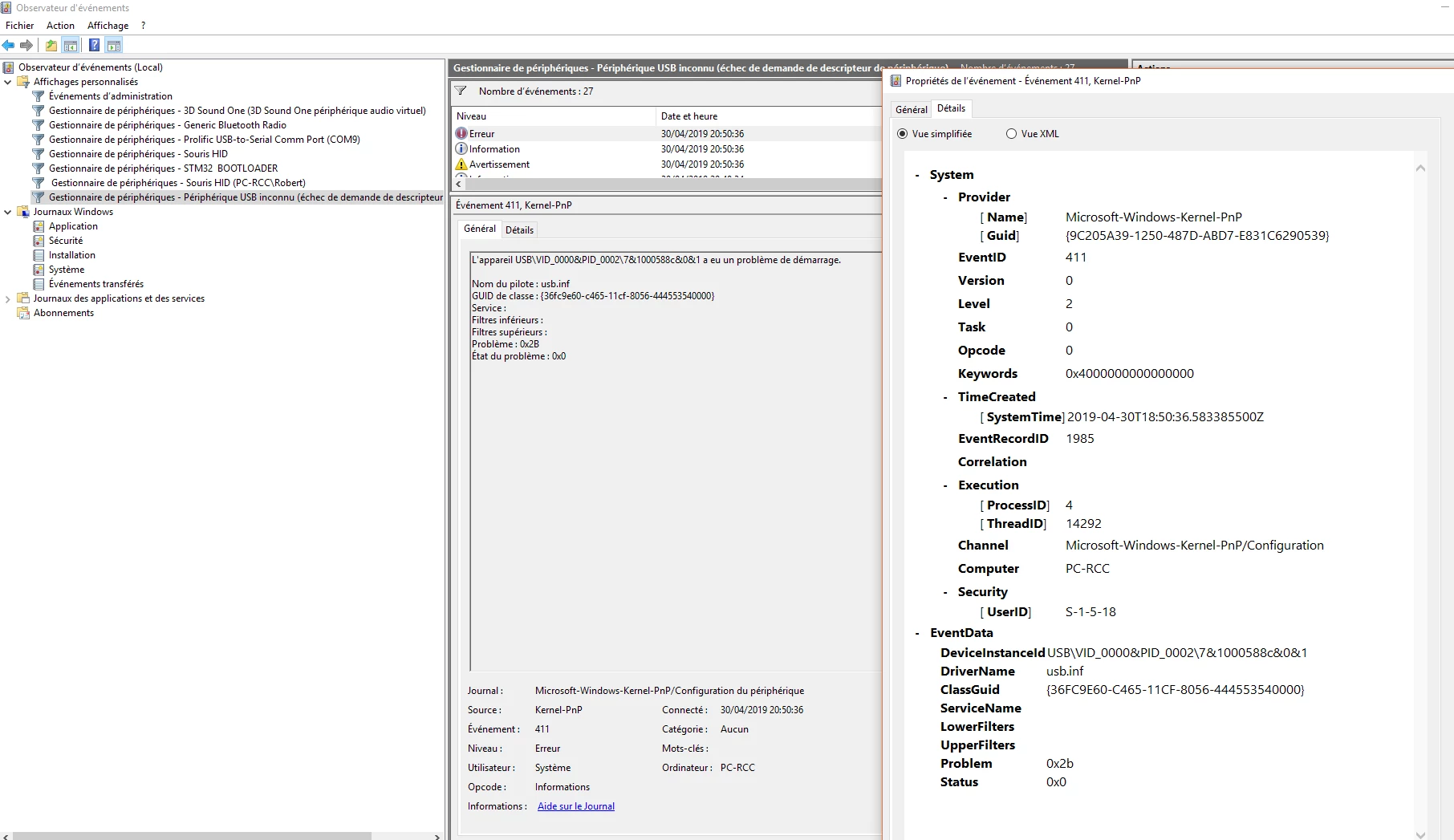

I test the CDC with my STM32F407VgTx in an up-to-date environment:
 Windows 10 / STM32CubeMx v5.20 / SW4STM32 / System WorkBench for STM32/ST-LINK V2
The VCP v 1.50 driver for windows 10 has been installed normally and declared active.
The source of the CDC program used is:
\ STM32Cube_FW_F4_V1.24.0 \ STM32Cube_FW_F4_V1.24.0 \ Middleware \ ST \ STM32_USB_Device_Library \ Class \ CDC
When running the program, when init the USB, I get Windows Error 43.
 Unknown USB Device (descriptor request failure).
Can you help me solve this problem?

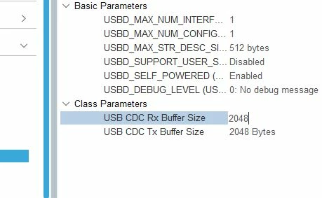

inside usbd_cdc_if.c the allocation of TX and RX buffer is on Stack and is 2048+2048= 0x00001000
So the Stack must be above 0x1400 (0x400 is the default stack alloc.)
As for the Heap allocation, follow the guide from ST.

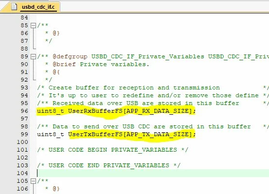

Are you sure?
-- pa
Vangelis Fortounas
May 7, 2019 7:54 PM UTC
Hi
Yes , this is a higher layer buffer allocated by user.
I put a Photo for this in the previous post. Very easy to check.
This buffer is different than in the first answer posted.
I know it seems irrelevant with this case but the uint8_t UserTxBufferFS[APP_TX_DATA_SIZE]; is on stack and as global, allocated first.
So Stack continues growing down and conflicts with upper heap space.
Bob S
May 8, 2019 7:53 PM UTC
No, those are NOT on the stack. Those are global variables and are statically allocated by the compiler/linker. A "global" variable cannot be "on the stack", because data on the stack is not permanent, it disappears when the function exits. You can have a global pointer point to data on the stack, but that is a recipe for a world of hurt.

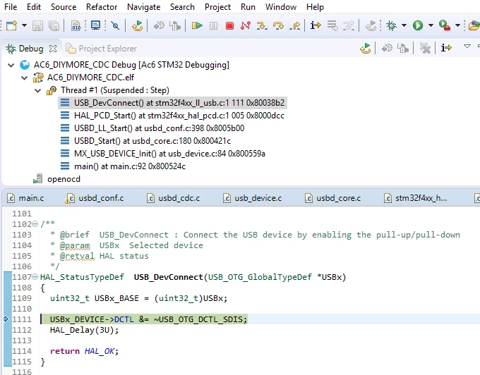

That's where I am:
I still have the driver problem initially described.
I increased the size of the stack beyond 1400..3000 without result.
I use 26MHz crystal and I have modified Clock Init
The anomaly fires when MX_USB_DEVICE_Init () is executed
 and the following functions (see CONNECT.PNG)
at the execution of USBx_DEVICE-> DCTL & = ~ USB_OTG_DCTL_SDIS the program manager
"Device Descriptor Request Failed" Appears
I added Trace tools in the console (see DBG_Trace.c / DBG_Trace.h)
 but I do not know how to debug the Driver and trap requests for descriptors proposed by Pavel.

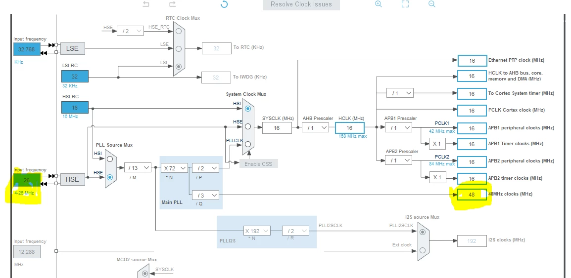

I tried last version drivers with 16 Mhz sysclck from HSI (as yours) and enumerates ok.
I suspect that USB clock isn't 48 Mhz ( In posted IOC file the XTAL freq is 25 MHZ and you use 26 MHz.)
CC_ROB
CC_ROBAuthor
May 8, 2019 4:34 PM UTC
Thank you evangelis.
With my 26Mhz crystalI have a 48Mhz USB clock
(It is possible to type 26 in the HSI line of configurator)
With the 16MHz HSE clock it is impossible to have the 48 MHz USB clock with the STM32CubeMx configurator.
