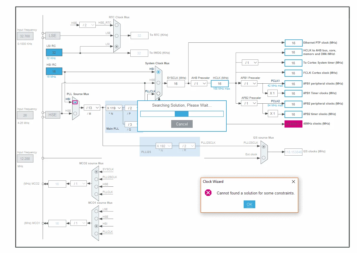

HSI
Pavel A.
May 8, 2019
Yes so there's a problem with clocks. Need to have external oscillator for USB?
-- pa

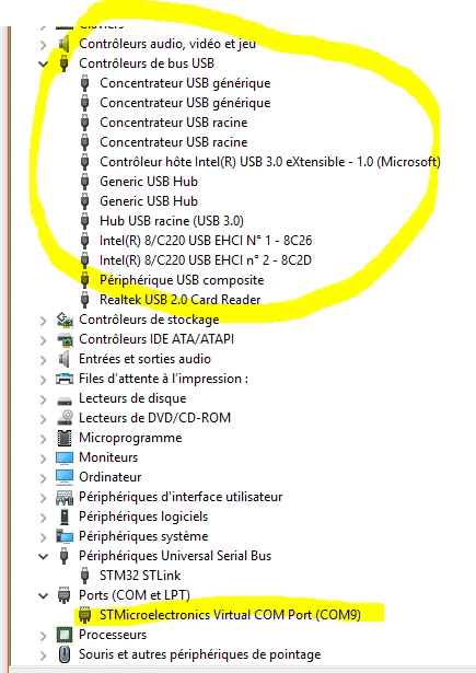

CC_ROB
CC_ROBAuthor
May 10, 2019
VCP CLEANFLIGT
CDC OK
Pavel A.
May 10, 2019
The picture you've posted 2 days ago shows a problem with USB clock. Have you resolved it? Does the board have external oscillator for HSE?
-- pa
CC_ROB
CC_ROBAuthor
May 10, 2019
Sorry to have mixed HSE / HSI in the text 2 days ago.
My card has an external crystal of 26 Mhz / HSE
I'm doing my tests in this extern crystal config
I had been told that the CDC was working in 16 Mhz / HSI but when I saw that there were clock config problems I did not try.
That said if there was a solution to work with the USB without extern crystal outside I would be a taker.
Rob

Pavel A.
May 11, 2019
Some MCUs with device-only controller (F072 for example) can derive the USB clock from host, using SOF.
They can work without external crystal. I don't know whether OTG can do this, even in device mode.
-- pa
