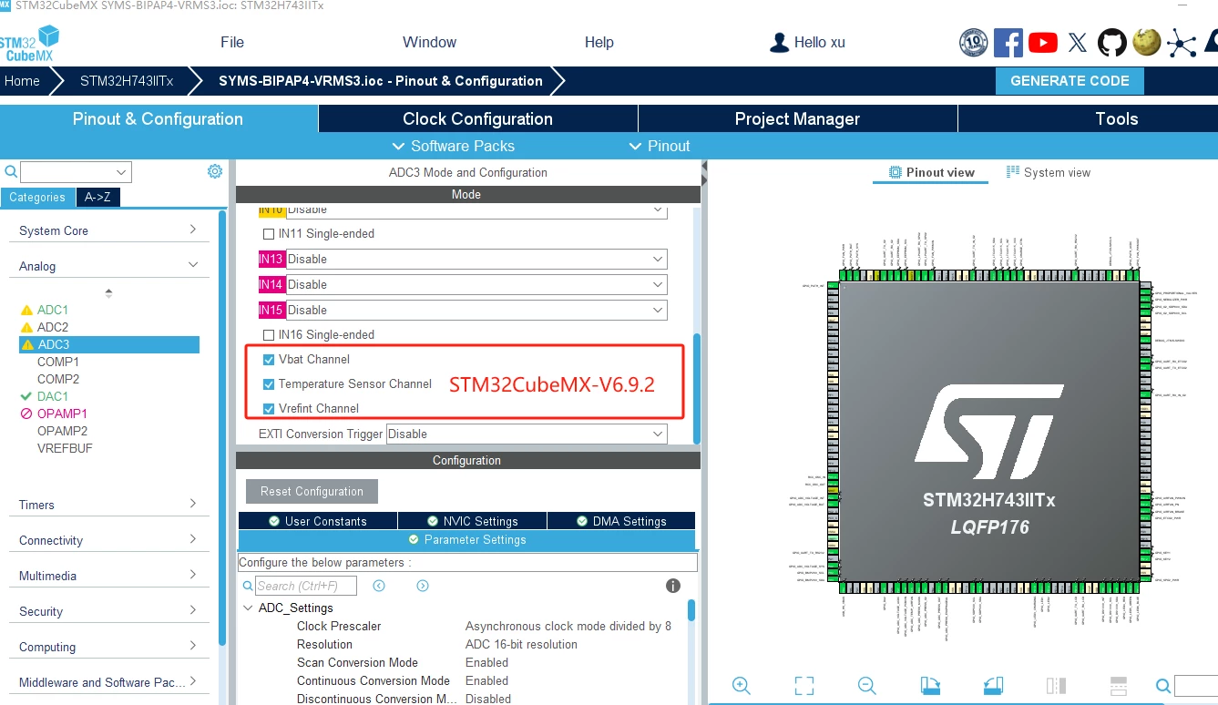

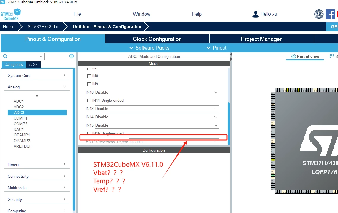

STM32CubeMX6.11.0 (STM32H743IITx) ADC3 Page have not Vbat and Temp and Vref Channel
STM32CubeMX 6.9.2:
STM32CubeMX 6.11.0:

Already escalated internally and will be fixed in the next version of CubeMx.
