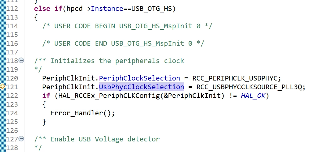

Works fine here. In initialization code:
Actual bits get set here:

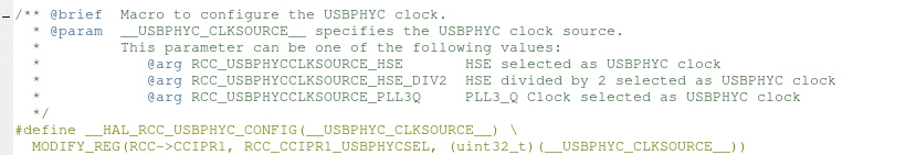

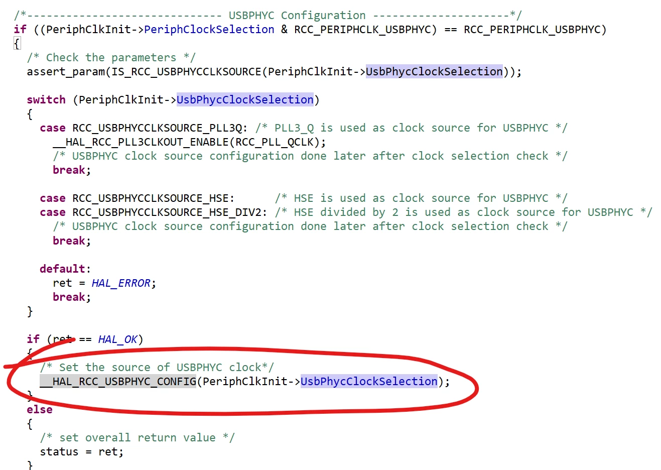

Thanks. Digging into stm32h7rsxx_hal_rcc_ex.h you can see that function is not actually touching the bits which tell the PLL what the reference frequency is.
That function only controls the input mux setting via the USBPHYCSEL bits, choosing the PLL3Q input in this case. It does not select the frequency controlled by the USBREFCKSEL bits.
