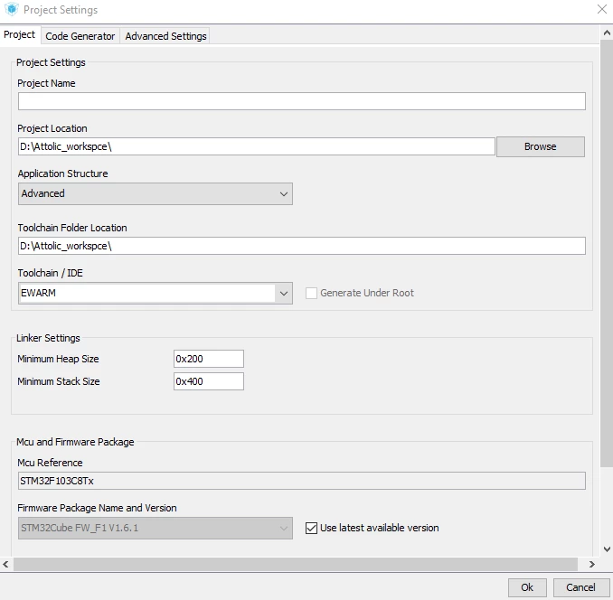

STM32CubeMX deletes Src folder..
When I am generating Code with CubeMX, it will delete my complete Src folder. I always have to recover it. For that reason it will also not generate any new c files once i add a new peripheral.
Tried this on Mac and Windows with latest CubeMx version (4.26.1) and i get the same behaviour in both.
Can anybody help?
Thanks

Thanks for your feedback,
I confirm its a bug, and it will be fixed in next CubeMX version 4.27.0,
Please feel free to contact me for further information,
Best regards,
Mohamed

0690X000006Bze5QAC.pngHi, I notice that in "Settings" one can select in Application structure "Basic" or "Advanced". The first one erase src, the last one not erase src located in Core folder. Hope help someone. I use CubeMX v4.26.

It seems like my problem has been gone with v4.26. The new v4.27 doesn't have this problem at this moment.
