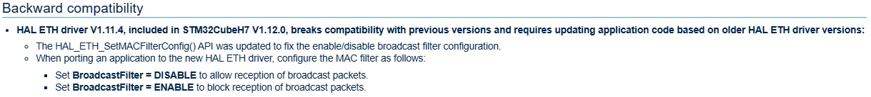

So, I had to manually install a newer ARM.CMSIS pack 5.9.0 and then it built and the app mostly works, except now the ethernet functionality doesn't work. ARP packets are not getting through to the etharp_input function. I found a rather obscure breaking change mentioned in the release notes.
The suggested solution here is so simplistic that  it is not useful. How is this meant to be fixed in user application code?
