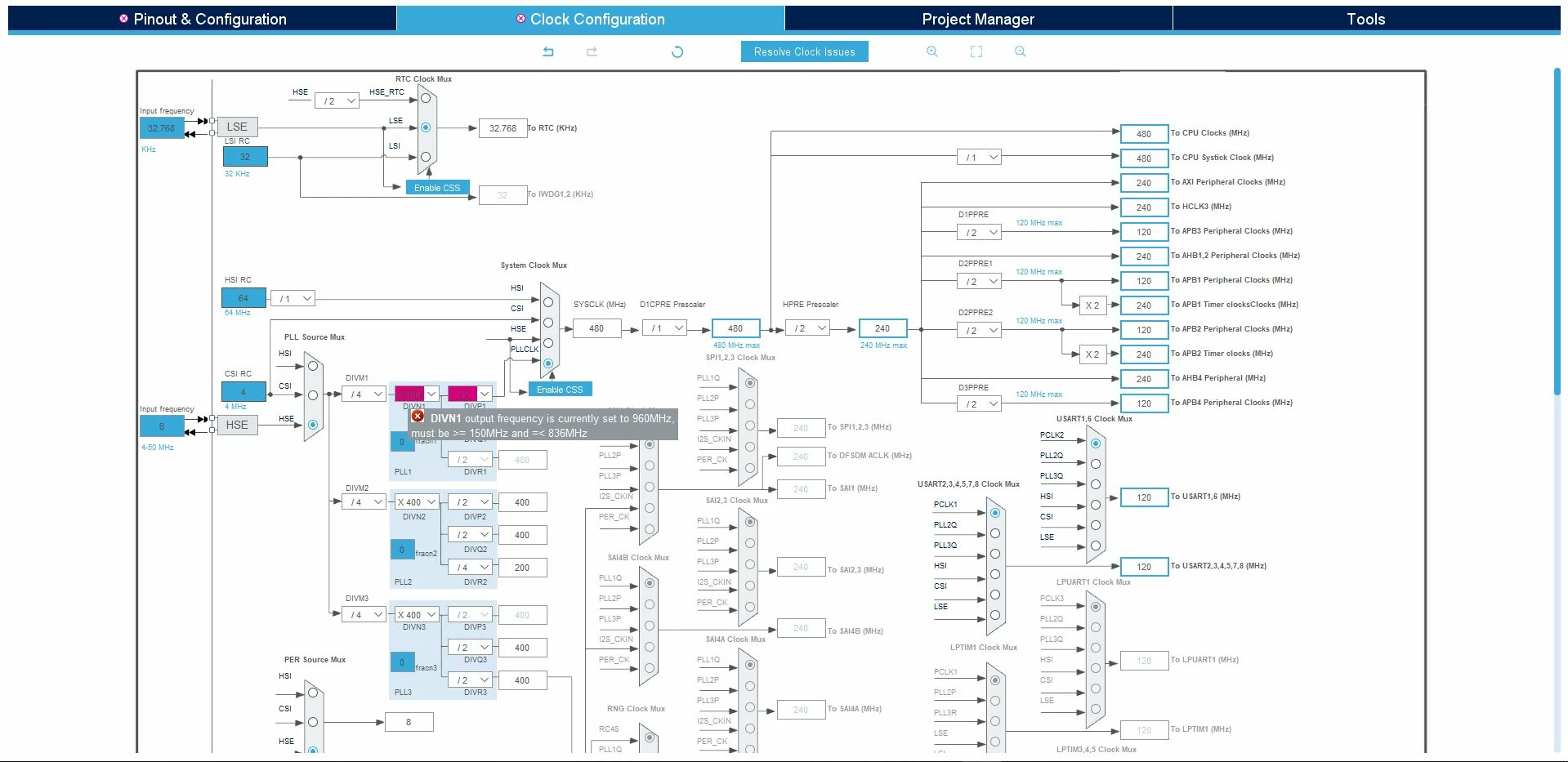

Hi @hans12345691.5549423946210898E12 (Community Member)​,
This release of STM32CubeMX also seems to allow the CPU clocks of the STM32H753ZIT to be set to 480MHz, this used to be 400MHz.
The odd thing is that STM32CubeMX does not allow the PLL to be configured to this frequency.
The minimum value of DIVP1 is 2, meaning that for 480MHz SYSCLK the output of DIVN1 needs to be 960MHz, STM32CubeMX gives an error when trying to do this:0690X000008B2UhQAK.jpg
Is there a solution for this?
Thanks in advance!
Best regards,
Martin Meijerman
Software Engineer
caleb
May 15, 2019 3:50 PM UTC
Did you ever find a solution for running at 480MHz? We should need to go to 'Power Regulator Voltage Scale 0' (VOS0, DS12110 Rev 7, Page 240, Note 2) , and only on device revision V, and you must make sure the LDO regulator is on (DS12110 Rev 7, Page 215, Note 4). Table 147 says that the max VCO output frequency is 960 MHz, which would allow a 480MHz clock, but the STM32CubeMX 5.2.0 only alows up to 836MHz, even when I set the VOS to VOS0. So, maybe set the VOS0, and manually set (in code) the PLL to 480MHz? But only if you have a rev V silicon....
Martin Meijerman
May 16, 2019 8:12 AM UTC
Hi Caleb,
I did not get an answer yet...
Guess that, indeed, we will have to hardcode the multiplier of the PLL to reach higher clock speeds.
I failed to notice that only revision V supports that speed, that introduces some nice dependencies :-/... Supply chain etc.
Best regards,
Martin
