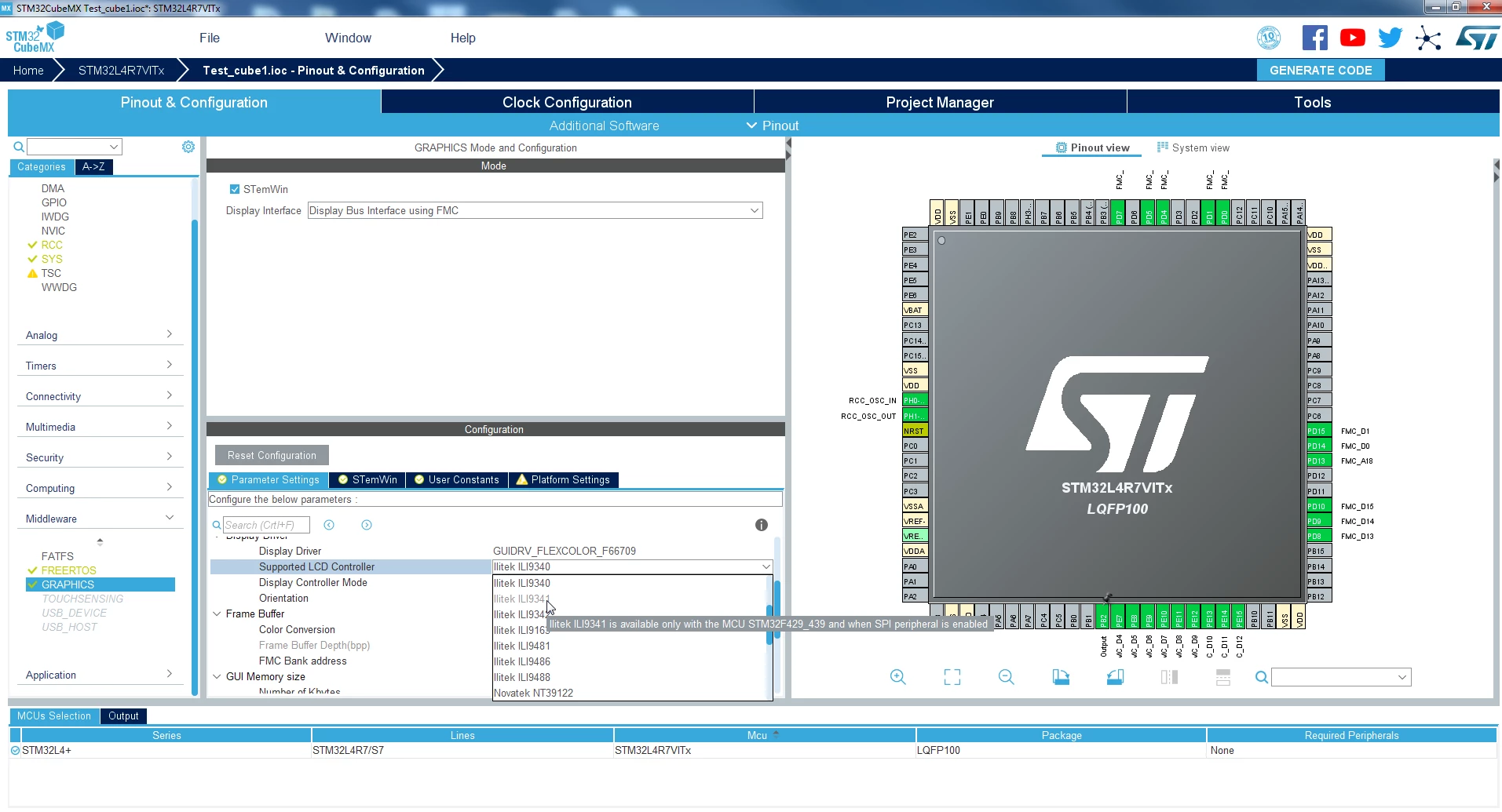

1) Problem with Stemwin graphics. If I choose stm32l4r7vi MCU I cannot use ILI9341 driver of stemwin library, I see message: "ILI9341 is available only with MCU STM32F429_439 and when SPI peripheral enabled"(see attach). But why I cannot use this with stm32l4r7vi via FMC interface?0690X000008wR4CQAU.png
