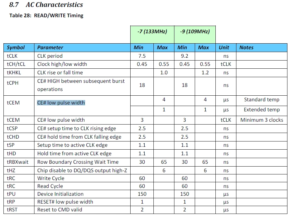

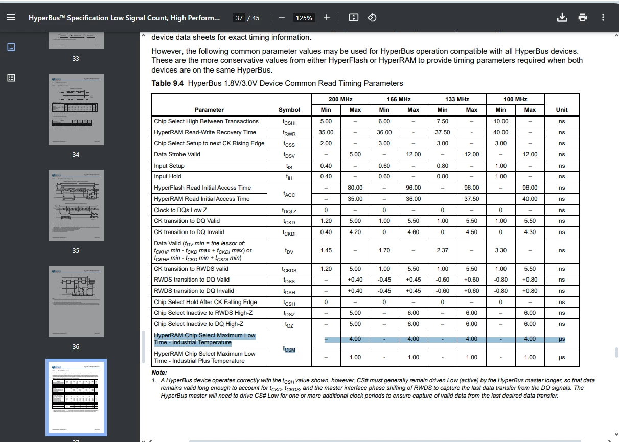

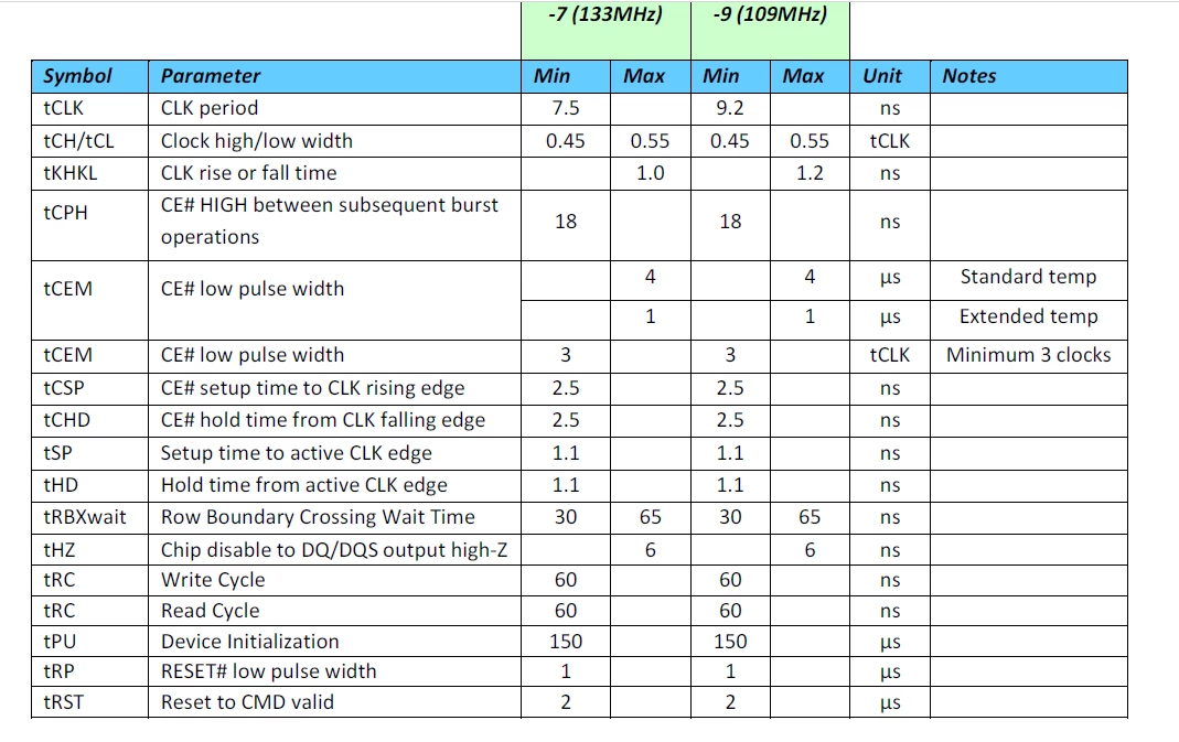

About the refresh rate. My octospi clock is 104Mhz, i use as external ram memory APMemory APS6408L-3OBMx, could someone help me calculate the refresh rate?
Senior
November 16, 2023
I have found the answer to my question myself.
1/104MHZ = 9.62ns = octospi clock cycle
Refresh = Refresh rate/ octospi clock cycle   = 4µs/9.62ns = 4µs/(1/(104MHZ)) = 416
Choose as refresh value 417 or 418, don't ask me why.
The value of refresh rate, we can find it in datasheet, for APMemory it is the parameter tCEM(CE# low pulse width), for my memory it has the value 4µs. --> See picture below.
Refresh rate for the Hyperbus Cypress memory(infineon): look at the parameter "HyperRAM Chip Select Maximum Low Time - Industrial Temperature" = tCSM = 4.00 µs --> see picture below

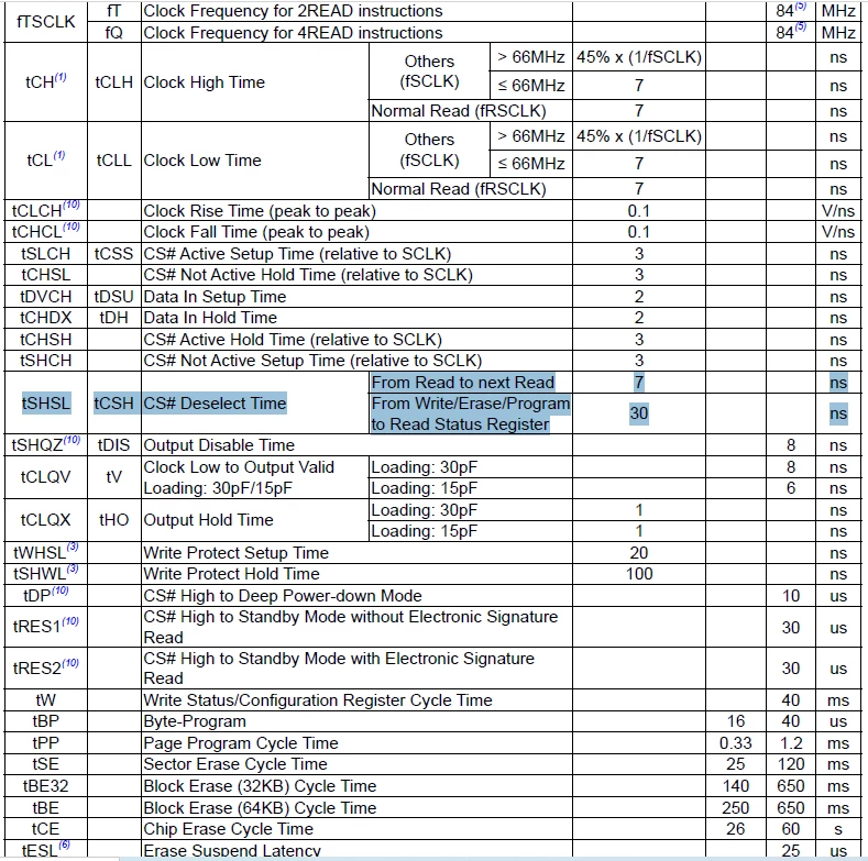

For my externa flash memory MX25L12833FMI-10G
Chip Select high time--->in datasheet of external flash memory: look for "deselect time after a non READ command"(tSHSL or tCSH): for my memory it's 30 ns. See picture below.
Example:  fclk = 104Mhz = 9.62ns , prescaller = 1, what's the chip select high time?
Chip select high time: 30 ns/1*104Mhz = 3.12-->4.
For my external ram memory APS6408L-3OBM-BA_PSRAM
Chip select high time is : 2
Look at the parameter "tCPH =CE# HIGH between subsequent burst operations = 18 ns" to calculate this.
Chip select high time: 18 ns/1*104Mhz = 1.87-->2.
