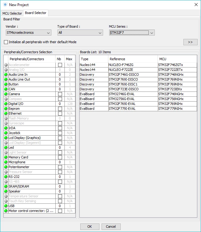

Hello!
NUCLEO-F767ZI lost in STM32CubeMX 4.19.0
while i
t was introduced
in
4.18.0.
I
have installed
STM32CubeMX as standalone (
on a different computer
) and
as a plugin for Eclipse
(as update)
the same result: NUCLEO-F767ZI missing.
What happened?
Regards,
Dmitrij

Refer to
https://community.st.com/0D50X00009XkfGLSAZ
for a temporary solution to the problem.
STM is aware of the bug and they say it will be fixed in the next release of CubeMX (4.20).
