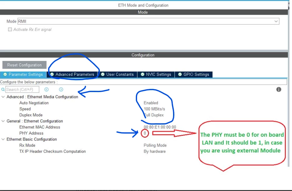

I tried to configure the ethernet driver to use LAN8720 and also LAN8742 but I find that some icons missed.
the menu that I faced is like this:

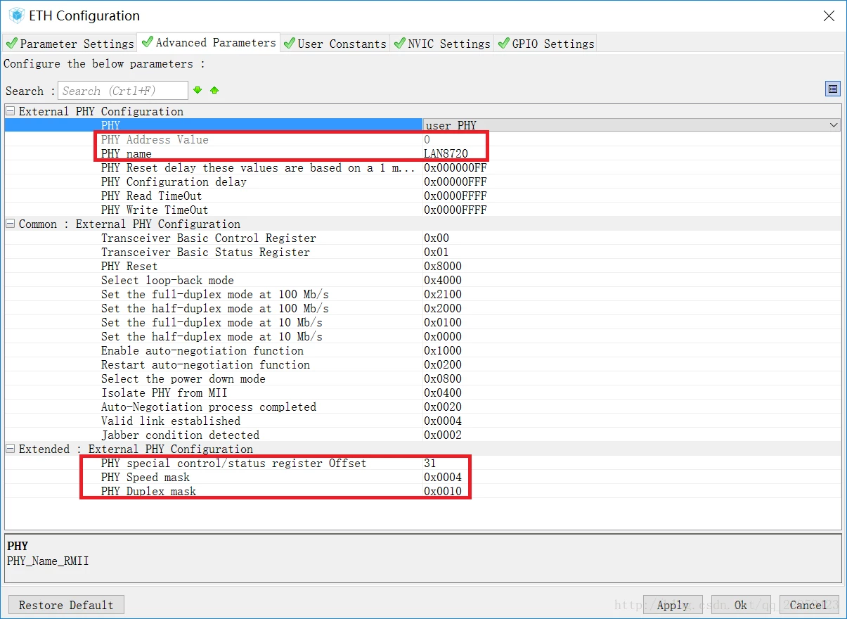

but some search on the internet shows that I don't have some parts:
look at lines and arrows. and also one of the headers missed too[advance parameters].
the version that I use is 6.9.0
what can I do to solve problems?
thanks for your attention

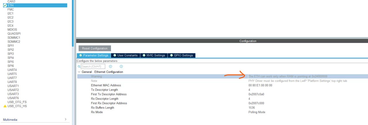

Also attention to the red arrow on the first image.
It mentioned to wrong RAM address for STM32F767 series.
