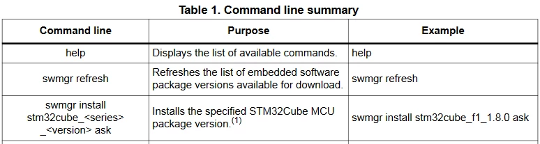

We're hoping to setup a CI pipeline using the CubeMX command line functionality and are having problems downloading and installing FW packages among other things.
I've followed the connection setup instructions and get the green check mark saying it works.
I've found that interactive mode described in the manual does not work. As suggested in this post it does in fact launch into the CubeMX application/IDE. As I understand the following command should result in a MX> prompt but does not.
& "$env:STM32CubeMX_PATH\jre\bin\java" -jar "$env:STM32CubeMX_PATH\STM32CubeMX.exe" -i
The manuals suggest using the following commands to download and install FW packages:
I've placed those commands in a script
swmgr install stm32cube_f4_1.28.0 ask
exit
and executed the scrip via PowerShell:
& "$env:STM32CubeMX_PATH\jre\bin\java" -jar "$env:STM32CubeMX_PATH\STM32CubeMX.exe" -q .\myscript

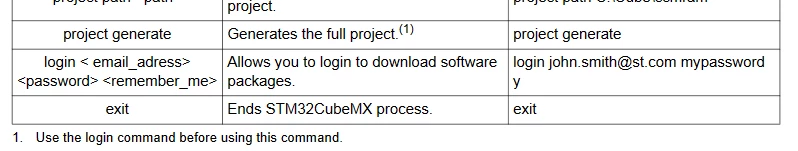

This download action requires prior login. To proceed, please use the 'login' command with your my.st.com account email and password.
Run 'login <email> <password> <remember_me>' for example 'login john.smith@st.com mypassword y'.
If you do not have a my.st.com account, please visit https://st.com website to create one.
KO
exit
Bye bye
Note the error saying the login command is required. So I add the login command before the install as it requests.
login some.user@mycompany.com myPassword y [actual credentials omitted of course]
exit
For which I now receive this error:
..... [Lots of noise omitted]
2024-08-20 10:24:45,580 [INFO] UserAuth:179 - activating auth plugin

The login command appears to be unsupported because it's execution results in the help command output being displayed.  Odd, that login is not supported, the previous swmgr command specifically calls it out as necessary (as I showed above) and it's also described in the manual.
Can someone help me understand what I'm actually supposed to do here to download packages? Seems the command line has issues.

Manually download all the Cube related install files and store them locally.  Have you CI commands install from these local copies.  Trying to download stuff from the web in you CI will cause you nothing but headaches.
brothhypAuthor
August 20, 2024
Are you suggesting roll my own un-zip routine?  i.e. Is manually unzipping the file into the STM32Cube Repository all that's needed?
It seems the swmgr install command is functionally useless anyway as according to the usage I can only (deny|ask) the package license.  There is no accept option?
Usage:
swmgr swmgr install <full_cmsispack_name | full_firmware_name | full_filepath> <licence_mode (deny|ask)>: install specified Cmsis packname or Cube Firmware with se
lected license accept mode.
ask - negates the entire concept of command line where you don't want to interact with a UI as it pops up the license acceptance dialog and freezes for user input.
deny - downloads the package (yes, goes through the entire download) and then tosses it out because you automatically deny the license. So net is a NOOP where you downloaded an 800Mb file. Seriously, who actually authored this API and what possible use case does this represent?
