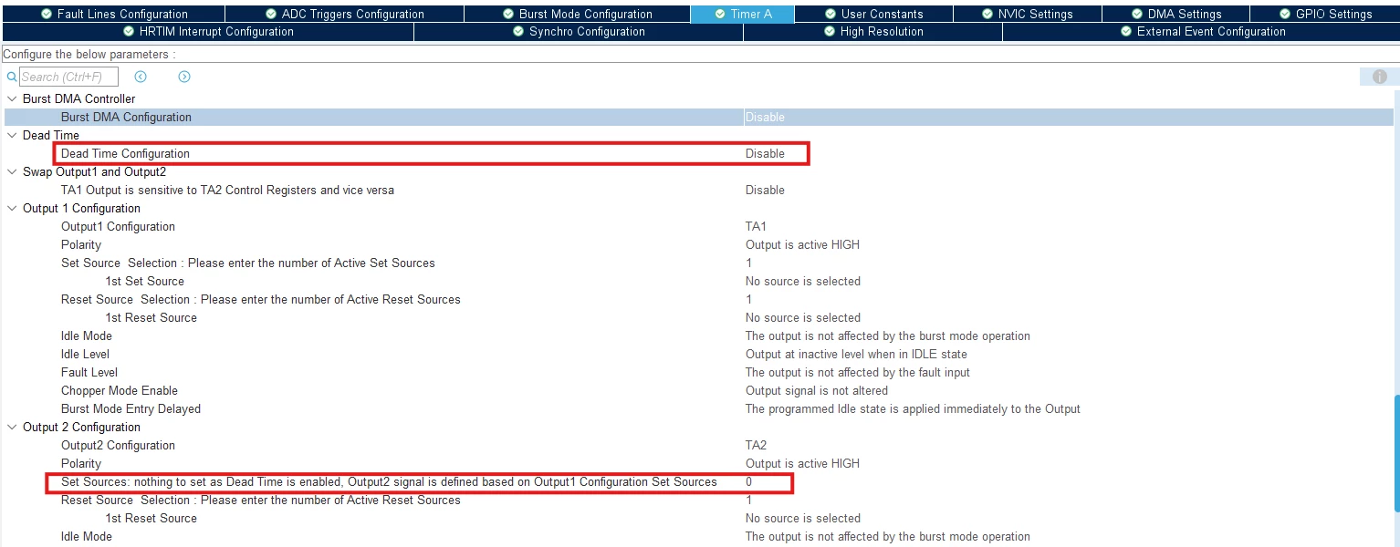

In CubeMX Version 6.17.0, for STM32G474RET6, HRTIM1, TIMA output2 configuration, set sources is forced to 0 cannot be changed to 1 and it is showing "Set Sources: nothing to set as Dead Time is enabled, Output2 signal is defined based on Output1 Configuration Set Sources" even if Dead time is kept disabled. This issue was not present on previous versions of CubeMX.

This issue has been fixed in the latest version of STM32CubeMX 6.18.0
Download STM32CubeMX6.18.0 from  here

Actually this is a known limitation that has been already escalated to our development team under internal ticket and it will be fixed as soon as possible.
More details could be found in the following links:
Solved: HRTIM configuration when updated to 6.16.1 CubeMX - STMicroelectronics Community
Stm32cube MX Hrtim G474x 6.16.0 Bug Report - STMicroelectronics Community
