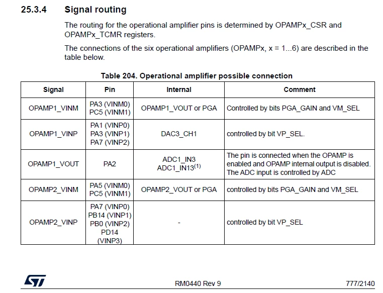

When I look the PIN-out view, PA5 is marked red. When I look the reference manual about OPAMPS:
Then it seems possible to have OPAM2 use PA5. In CubeMX I look at OPMP2 mode pull down menu, you got “Standalone Internally connected_IO”. But it is marked red and cannot be selected.

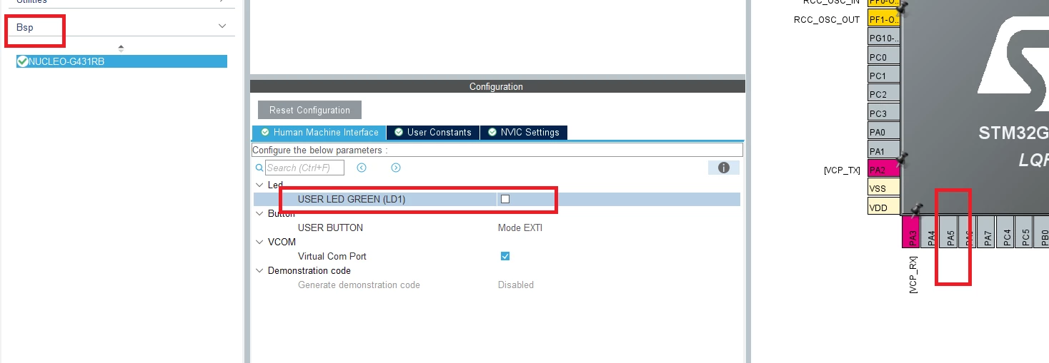

    You can go to the Bsp menu and uncheck the user LED option, as the following:
    As you can see PA5 is no more allocated to the user LED.
    Then configure the Opamp in the Analog menu.
    Hope I’ve answerd your question.

    Thank you!
    I was not aware of the Bsp menu. Yes, now it is possible.
