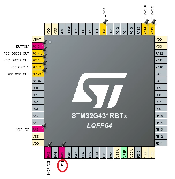

This is my first post here, and I have started learning about the STM32G4xx processors. So I might very well have got something wrong here. I like to ask about a detail in the pin-out picture of the STM32G431 Nucleo64 board in STM32CubeMX software.

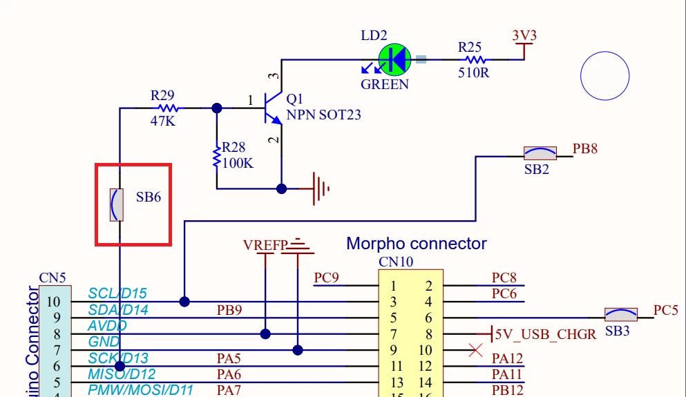

When I look at the schematics for this Nucleo board, it seems that the PA5 pin can activate the LD2 LED and not the LD1. I guess, that for the typical beginner start blink software, you normally use LD2. When I look at the same picture for the NUCLEO64 STM32G474 board, this PA5 pin activate LD2.
The same pin is used for input to an OP-AMP. Would it be possible to use it if you disconnect the SB6 jumper?

Yes you can use that GPIO for the OPAMP input while removing SB6.
For the CubeMx, I’ll escalate internally for analysis and fix (internal ticket for follow-up: CDM0064210) as in the schematic the reference is LD2:

Yes, for the NUCLEO-G474RE the Pin label seems correct. It is the NUCLEO-G431RB that I am asking about in the CubeMX Pinout wiew. You see the screen dump above with a red marking ring around the issue. I think this marking should have been (LD2) like for the G474RE.

This appears to be another typo going back at least as far as CubeMX 6.16.1, as I was able to confirm after a brief check. The cause turned out to be two XML files located in the CubeMX installation folder under:
db\plugins\boardmanager\boards\bsp
  • NUCLEO-G431RB_Configs.xml
  • NUCLEO-G431RB_Modes.xml
You can edit them with a text editor and replace every occurrence of the string LD1 with LD2, then your pinout will be generated correctly.
