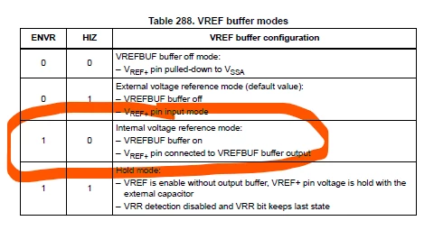

How to Set VREFBUF to Internal Voltage Refence
I'm using at STM32H563VITz in LQFP100 package.
According to the reference manual (RM0481 Rev 21209) I can use the internal Voltage Reference (and then set it to 2.0478V)
I've also referenced the post at: How to configure VREFBUF on my STM32 - STMicroelectronics Community
When I open the .ioc file for my project. I don't have the option to select the Internal Voltage Reference
It could be a bug in Cube MX - but I suspect it's more likely that I haven't enabled some component or peripharl in the .ico file?

Hello @BenG
This behavior has been solved on the last version of the STM32CubeMX V6.13.0.
Best Regards.

Hello @BenG
I confirm that it is an issue on the STM32CubeMX. I've escalated to the concerned team for correction (under internal ticket number 192092).

Thanks
Is there an estimate on how long a fix will take? (I appreciate that's like asking how long a piece of string is?)
I'll try and temporarily hack the (auto)generated code to enable it, but any advice/tips would be helpful

Hello @BenG
Best Regards.
