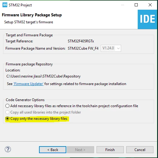

Nesrine.JLASSI
Visitor II
May 10, 2019
Hello @Stephen28​
After check, CubeIDE only makes the copy only of the necessary library files.
Best regards,
Nesrine.

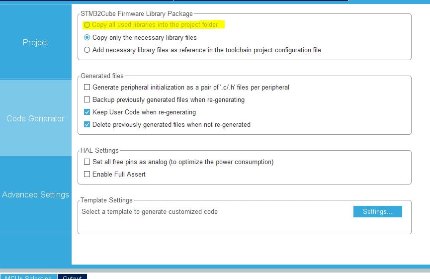

Stephen28
Stephen28Author
May 10, 2019
This is the configuration window I see in CubeIDE
"Copy only the necessary library files" is selected. I cannot find any checkbox to tell CubeMX that the project will use the DSP functions. How does it know to copy the DSP files, if it does not know that they will be used? The Device Configuration Tool does not ask if you are intending to use floating point or DSP functions.
Nesrine.JLASSI
Visitor II
May 13, 2019
Hi @Stephen28​
STM32CubeIDE uses the option "Generate Under Root" that always deactivates "Copy all used libraries into the project folder"
Best regards,
Nesrine
