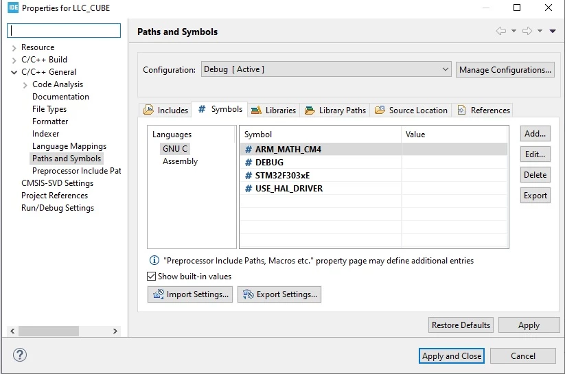

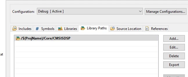

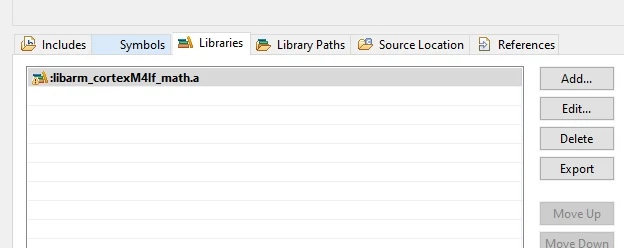

I had a similar problem recently and asked ST directly with STM32CubeIDE V1.1.0, I use a STM32F303.
The following was the Answer:
"... The package feature for third party pack is not yet fully implemented in CubeMX. This is reason why it is partially working.
Also currently is no possible to select this in CubeMX. But is possible to add this library manually.
You can find it in you HAL package in
STM32Cube_FW_F3_V1.11.0\Drivers\CMSIS\Lib\GCC\
And you must add it into your project on disc.
And then in project properties -> C/C++ Build -> Settings -> Tool Settings -> Libraries
Sect path where is your library and select name of this library.
This worked.
I copied the library and the headerfiles to my project and added the library as in the picture below.
further did I had to define the symbol(this is MCU dependend) also as in the picture below.

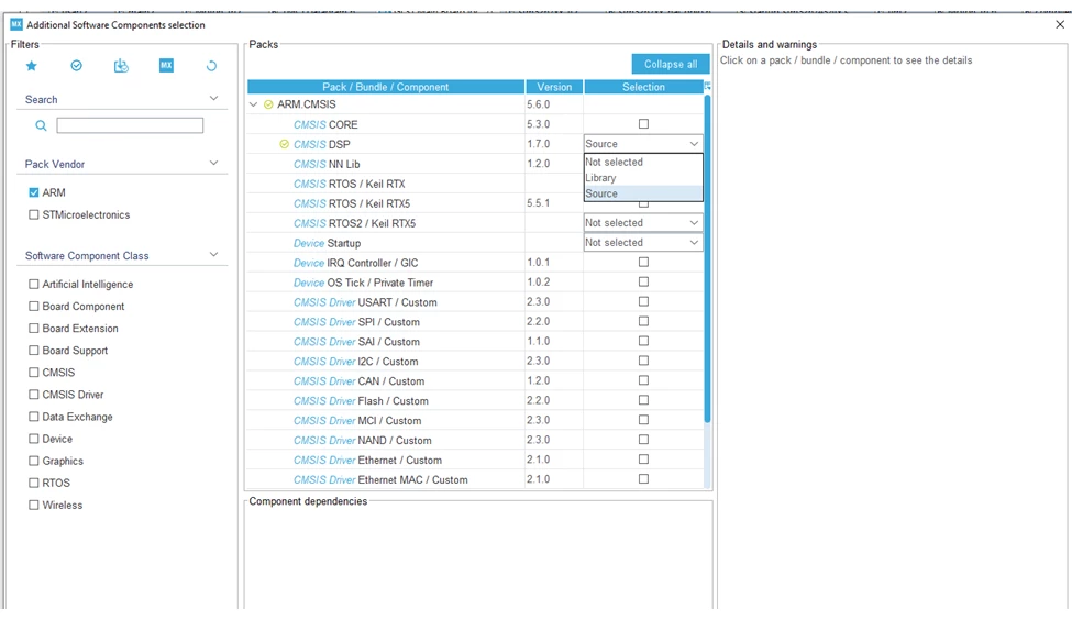

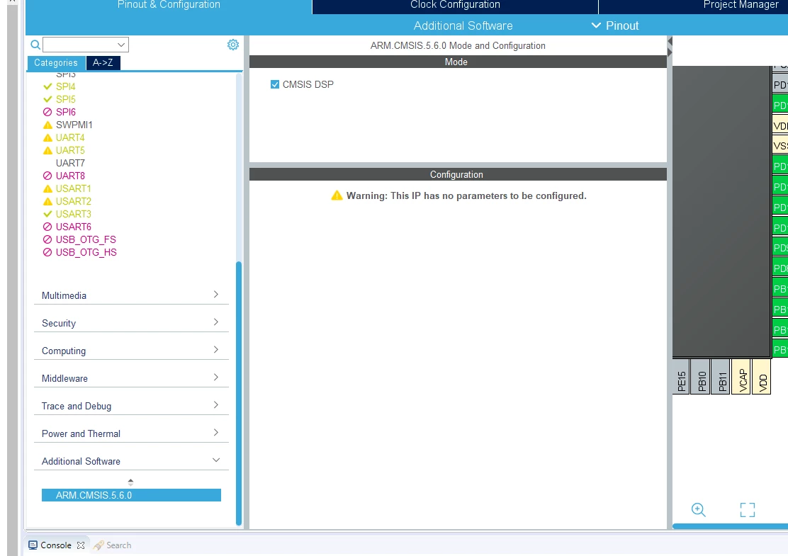

Feb 5, 2020 10:07 PM UTC
I have another answer that worked for me. Go to the "Addition Software" link on the .ioc. Then filter for ARM CMSIS
Install this SW package and you will then see an option in the configuration to turn on DSP functions:

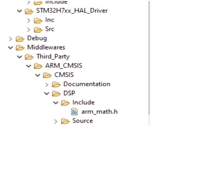

Enable this and regenerate the code. You will then have a new folder in your project titled "Middleware". Dig down deep and you will find the arm_math.h include:
SMall.1
Mar 18, 2020 3:02 PM UTC
This solved the problem. Also make sure to include the required arm math source files into the main Src folder. You can get these from the DSP Source mentioned in the above diagram.
