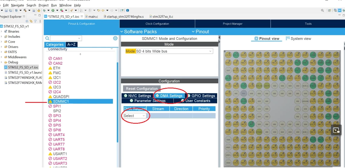

How to configure FatFs with DMA on STM32L5 using CubeMx.
I would like to have advice, I see this video about SD Card :
https://www.youtube.com/watch?v=I9KDN1o6924&t=359s
And in the video (5:30) I can see DMA tab via CubeMX
But with me I don't have this tab, do you know why ?
I have STM32L552E-EV Evaluation Board with STM32L552ZET6QU microcontroller, after me It's possible to have the DMA with SD Card.

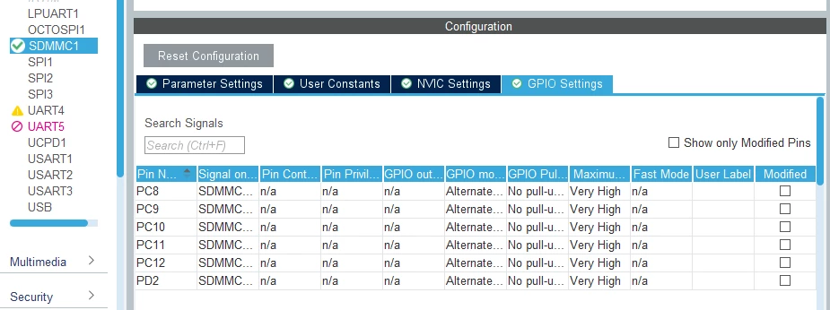

Jan 10, 2025 3:24 PM UTC
There is no DMA configuration for the SDMMC on L5 as it's already a master (a kind of DMA):
Unlike the F7 family, SDMMC1 is mounted as a slave on APB2 where you can configure a DMA (a master) for DMA transfer:

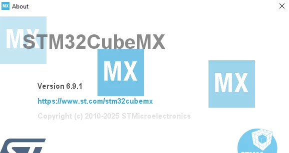

DYann.1
DYann.1Author
Senior II
Jan 10, 2025 3:30 PM UTC
Thank you for this information, does this mean by default I am already in DMA with my STM32L5xx card ? Right ? For CubeMX I have this version
mƎALLEm
mƎALLEmBest answer
Jan 10, 2025 3:48 PM UTC
 As said SDMMC is already a DMA but in sd_diskio.c / SD_read() and SD_write() there are two types of implementations with and without DMA:
HAL_SD_ReadBlocks_DMA(): with DMA
HAL_SD_ReadBlocks(): without DMA
HAL_SD_WriteBlocks_DMA(): with DMA
HAL_SD_WriteBlocks(): without DMA
Look at the implementations of SD_read() and SD_write() in the examples:
STM32L552E-EV/Applications/FatFs/FatFs_uSD_Standalone
and
STM32L552E-EV/Applications/FatFs/FatFs_uSD_DMA
Their corresponding sd_diskio.c are respectively:
1- https://github.com/STMicroelectronics/STM32CubeL5/blob/master/Projects/STM32L552E-EV/Applications/FatFs/FatFs_uSD_Standalone/FATFS/Target/sd_diskio.c
2- https://github.com/STMicroelectronics/STM32CubeL5/blob/master/Projects/STM32L552E-EV/Applications/FatFs/FatFs_uSD_DMA/FATFS/Target/sd_diskio.c
PS: in any case you need to update your CubeMx version.
