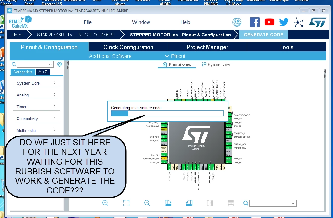

I have wasted so much time over the last day or so trying to generate code for a new project in CUBE MX
I can't go back to version 4 that use to work ok, because it's been generated in crappy version 5 !
ST you really need to sort your Act Out!!! THIS IS BEYOND POOR, who the hell is writing this crap development software for ST ???
this software is so crap it's unreal, how are professional embedded designer supposed to work with this total garbage
it just locks up when trying to generate the project code WTF ?
any help will be appreciated , but don't seem to get any of that either ?
thanks
I have included the cube ioc project file that crashes ???
Can't seem to find any error log files anywhere giving me a clue to what's going wrong with this software
how can it be that, I have an important project to do, yet due to this poor software I wasting more time trying to work out the bugs and what''s wrong with this software ??
there are No error messages, No logs ?? just a frozen program , really poor software!!!!
Well, here's a little life-hack that may help with your F446.
Back up the ioc file and everything you have generated & edited.
Create a new directory and copy the .ioc file there.
Open it in a text editor and change the line "MxCube.Version=5.3.0" to
"MxCube.Version=4.6.0" or whatever is your Cube 4.x version.
Then open it in Cube 4.x.
As the gospel goes.... who writeth code without bugs, throws the first stone ;)
-- pa
