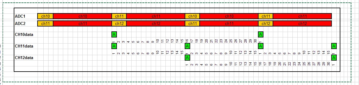

Standard peripheral is far better than this new hal library. Anyway, I modify the example file included in projects. The example file is for sampling 2x2 channels in scan mode.
0690X00000602lKQAQ.png It works perfectly but I have to modify to only sample one channel for each ADC1 and ADC2. First solution I change 2nd channel in each ADC identical to 1st channel. So ADC1 sample channel 11 twice and ADC2 sample channel 12 twice. It works without any problem but it is stupid way.
/* ADC1 regular channels 10, 11 configuration */
//ADC_RegularChannelConfig(ADC1, ADC_Channel_10, 1, ADC_SampleTime_3Cycles);
//ADC_RegularChannelConfig(ADC1, ADC_Channel_11, 2, ADC_SampleTime_3Cycles);
ADC_Channel_11
, 1, ADC_SampleTime_480Cycles);
ADC_Channel_11
, 2, ADC_SampleTime_480Cycles);
/* ADC2 regular channels 11, 12 configuration */
//ADC_RegularChannelConfig(ADC2, ADC_Channel_11, 1, ADC_SampleTime_3Cycles);
//ADC_RegularChannelConfig(ADC2, ADC_Channel_12, 2, ADC_SampleTime_3Cycles);
ADC_RegularChannelConfig(ADC2, ADC_Channel_12, 1, ADC_SampleTime_480Cycles);
ADC_RegularChannelConfig(ADC2, ADC_Channel_12, 2, ADC_SampleTime_480Cycles);
For better modification I did this changes. But It doesn't work properly. The problem is that only channel 12 data shown correctly and channel 11 data is missed!! There is something with DMA I assume. >Change DMA buffer size from 4 to 2 >Change variable aADCDualConvertedValue[4] toaADCDualConvertedValue[2] >Turn off scan mode >ChangeADC_InitStructure.ADC_NbrOfConversion = 2 to 1 >Remove second channels in each ADC config
