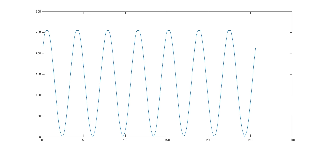

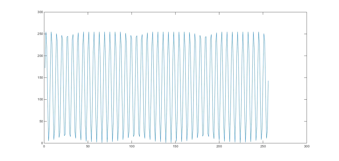

I have change sample cycle from 480 to 28. it works very well till frequency of 1KHz. Above that it start to degrade. I change ADC clock in order to make higher sample rate but it fails, even decreasing ADC clock make it worse!
Approximately the sample rate is :
(ADC prescaler=8 and prescaler peripheral clock=2)
sample rate= 168MHz/(2*8*28)=375 KHz
1KHz input
6KHz inpu
A single channel does not scan. Channels = 1, Scan = Disable
I will turn the scan off.
Ideally do one buffer so you don't transfer discontinuities as you confirm the functionality.
I thought this is the way of doing that. DMA interrupt for each ADC transfer and UART send with higher transfer rate than sampling rate.
I set DMA is mode 1. you suggest that I use DMA in mode2?
can you give more insights? or maybe a code example.
