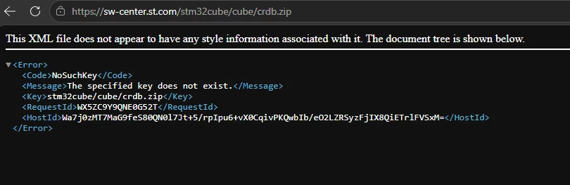

Explorer
July 6, 2026
Dear colleague!
Unfortunately, looking at what happened, I see that the essence of the problem has not yet reached the GSOURI colleague who is looking at the support.
It's simple. Either the crdb.zip file is not in place or the network permissions are set incorrectly on the server.
supposedly this is the location of the file on the server.
https://sw-center.st.com/stm32cube/cube/crdb.zip
until it throws an error, it is not available and there is nothing to fiddle with on our own machine.

I found the latest version of stm32CubeMX under the windows sandbox, since the java interpreter was not willing to connect to the st server and connected offline. So I think the install program uploaded the crdb.zip file locally in the zip, the timestamp of the file is 2026.06.27. i.e. the assumed date of death.
My knowledge of Java is zero, so I can't give a correct solution.
Ghofrane GSOURI
July 8, 2026
Hello ​all,
First of all, I would like to thank everyone for their contributions.
A workaround has been provided at the following link:  Workaround for file download error: crdb.zip (Problem during download) | Community
THX
