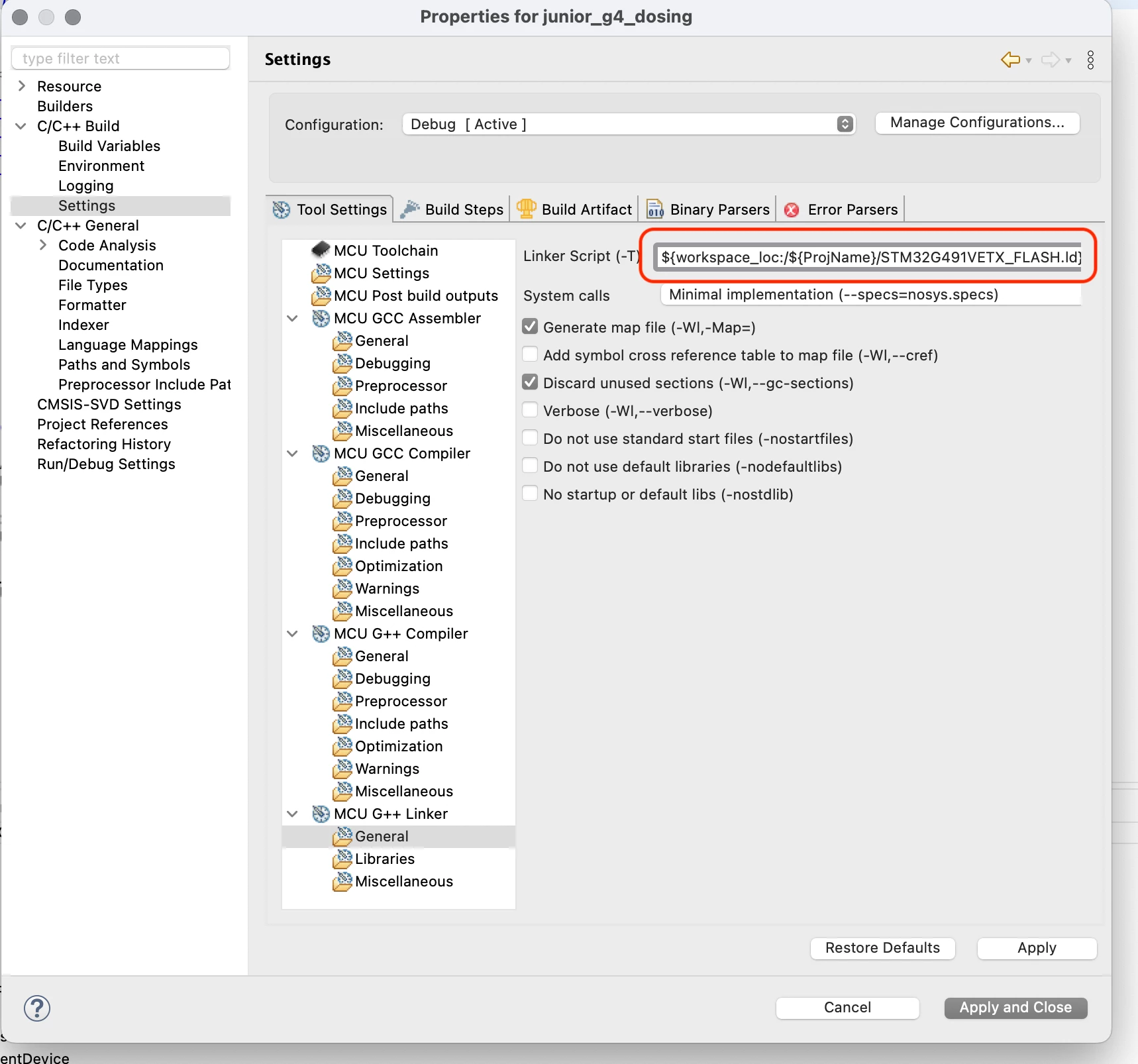

DSala.18
September 7, 2023
in case anyone still wondering:
it's here:
