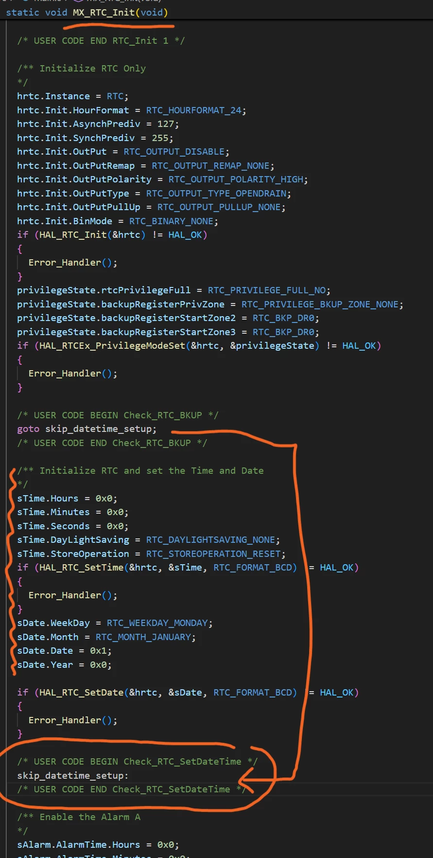

Hi ST,
Is the issue with generated code resetting RTC clock described here
CubeMX RTC config issues | Community (Internal ticket number: 200239)
going to be fixed?
Thanks,
Thomas
1 reply
TDJ
TDJAuthor
Senior III
Sep 1, 2026 1:00 PM UTC
Just to clarify, all that is needed is an additional “USER CODE” section right after the date/time is set. This would allow users to add custom code that can bypass the date/time setup. Currently, this is simply not possible because there is no “USER CODE” section between setting the date/time and configuring the RTC alarm.
The required change is very small, straightforward, and non-breaking. Please see the proposed solution below, which introduces a new Check_RTC_SetDateTime section.
