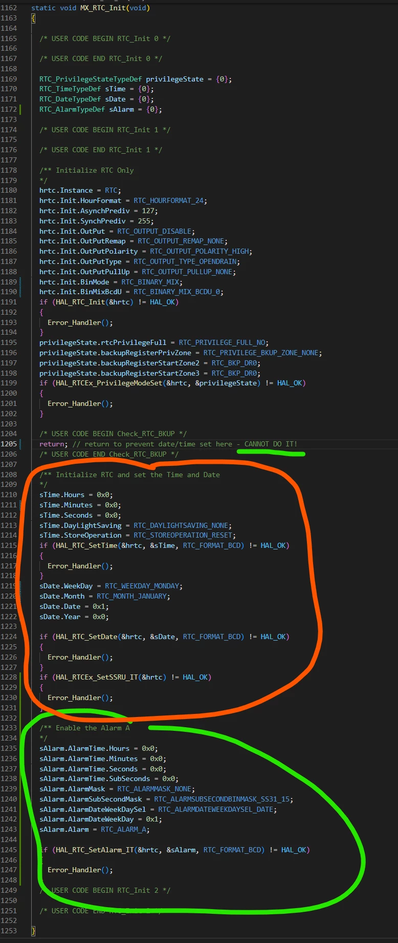

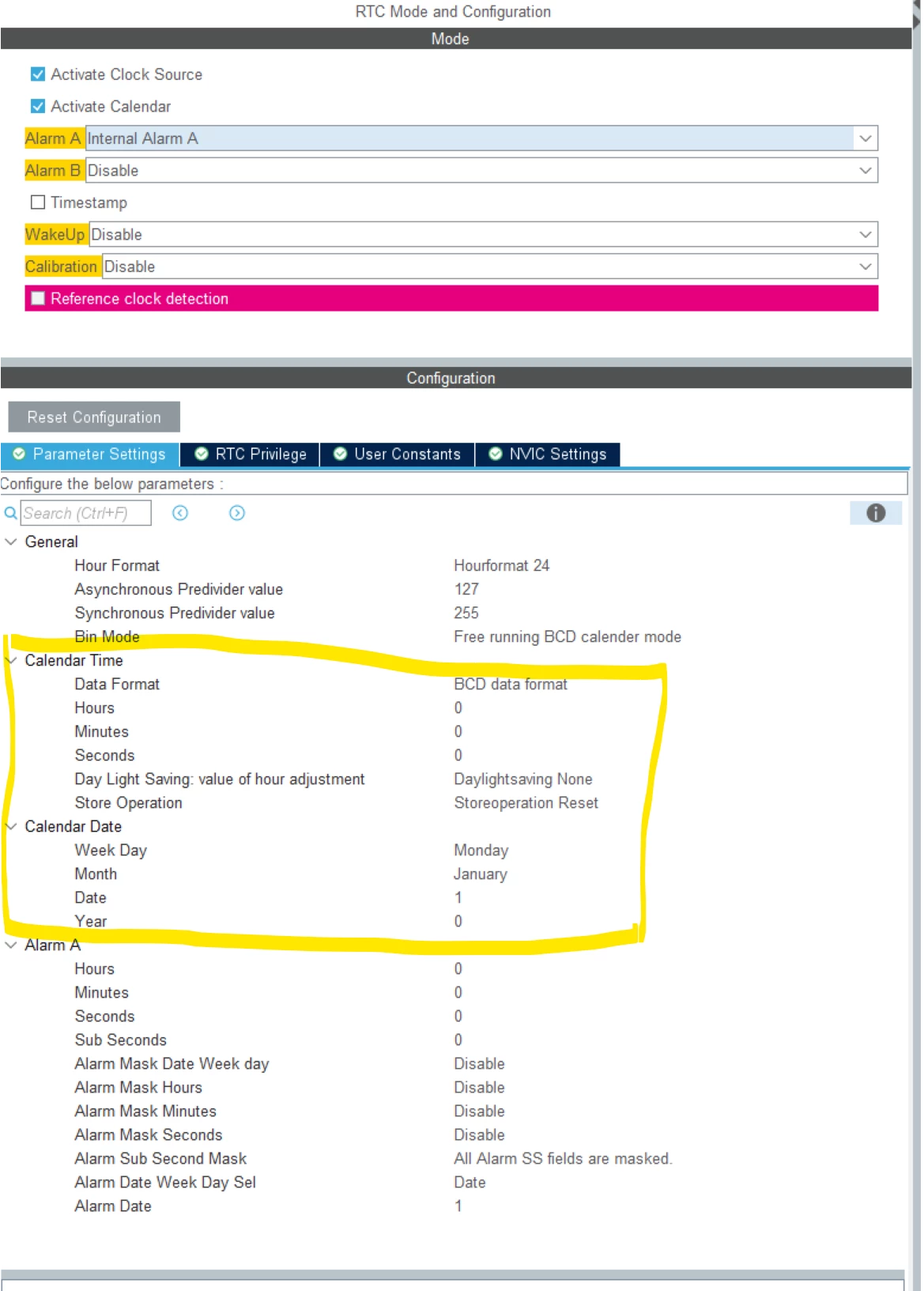

Trying to to set up RTC alarm for STM32U5G9 I come across this CubeMX issues:
There is no option to disable Calendar date and time setup. Needless to say, probably it does not make any sense to set up date and time on every board reset if it has (as it should) some RTC battery backup.
It is not a big deal until one configures RTC alarm, function "return" statement can be added in MX_RTC_Init() 'user code' section before date/time gets reconfigured.
However, this is not an option when RTC alarm is configured because code execution needs to reach this part resetting time and date along the way.
Another reason for that is the lack of 'user code' between date/time setup and alarm setup sections in generated code. Otherwise, label and goto statement could be used to skip date/time setup.

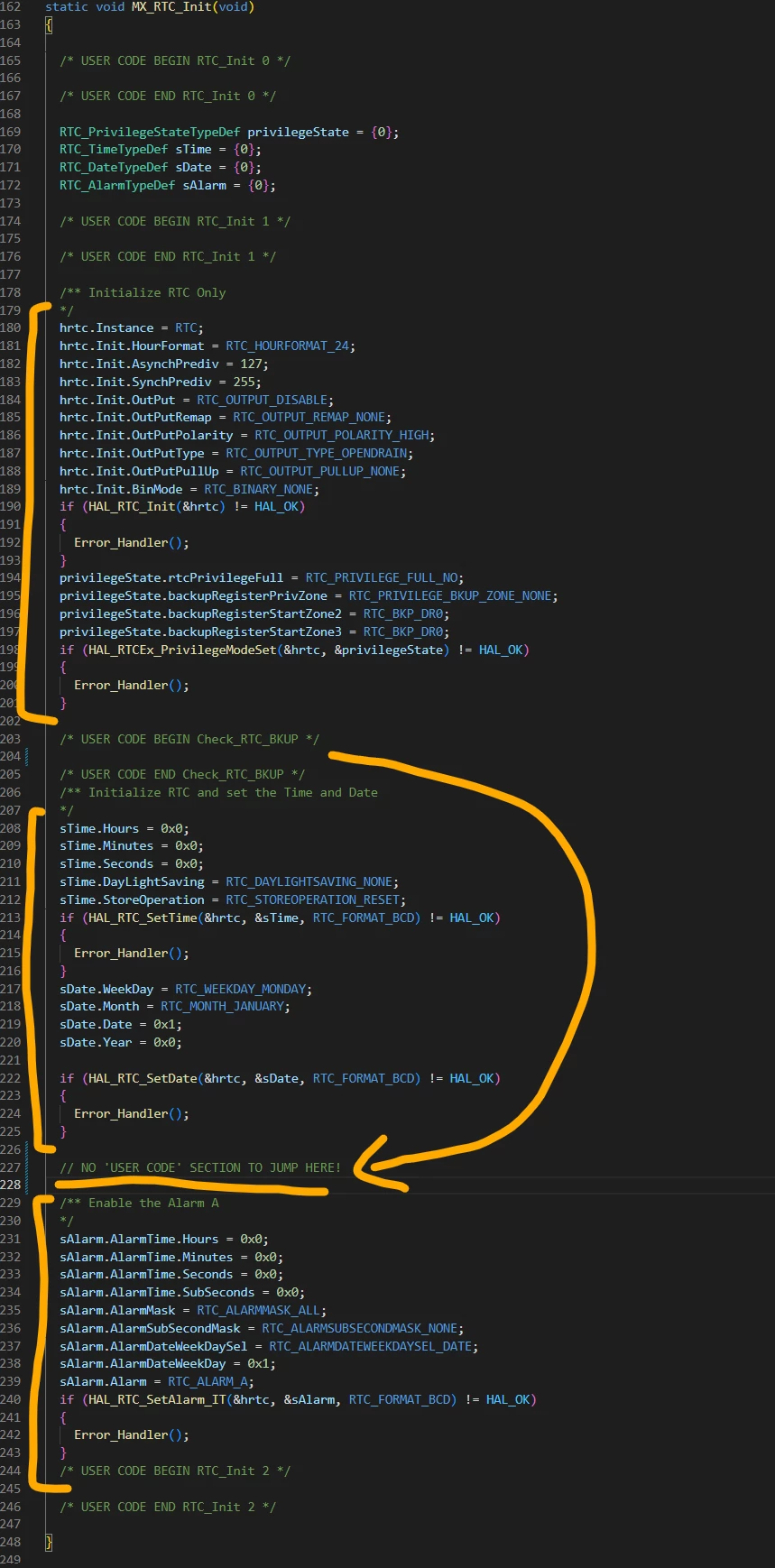

Hello @Sarra.S I tried to explain why the approach you suggested is not doable if an RTC alarm is also configured. Simply, there is no way to place code in the 'user code' section that will conditionally or unconditionally skip the date/time config and go straight to RTC alarm config. There is not 'user code' section between date/time setup and RTC alarm config where code execution could jump to in order to skip date/time setup - no matter what the logic behind is.
I can see two solutions which are not mutually exclusive:
1. Make CubeMX current date/time config optional. It is current date/time. Usually, other than for Nucleo boards without battery used for demo, there is no need to hardcode it.
2. In the generated code add another 'user code' section between date/time config and RTC alarm config code

@Sarra.S Maybe this picture below will better illustrate the problem.
