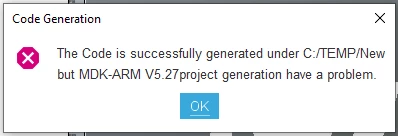

CubeMX: Project generation have problem
Posted on May 23, 2018 at 12:53
Hello guy.
   I' upgrade my CubeMX software to V.4.25.1 every thing is clear no problem. But when we try to generate MDK project CubeMX show an project generate problem ( see in attach pic.)
   Please tellme how to fix it
Thank you
EDIT!!:: TrueStudio has the same problem.

DCano.1
Visitor II
Mar 1, 2020 12:20 PM UTC
Thank you for the help.
For me the probelm was the project folder, the path to it had some cyrillic letters. I created new foler on the desktop and the problem was solved.
JJara.1
Visitor II
Mar 9, 2020 11:15 PM UTC
Hello, I had that problem and for me solution was uninstall Java and install Java JRE 8x64. I had Java x86 and when I updated Java downloading from this URL: https://www.oracle.com/java/technologies/javase-jre8-downloads.html, my problem was solved.
SRavi.1
Mar 11, 2020 9:29 AM UTC
uninstall the java run time environments and all java compilers from control panel. Run stm cube mx it will ask for kjava run time click ok it will direct you to java runtime update website. down load and install the java se. open cube mx it will work.
Gulev.Borislav
Explorer
Mar 19, 2020 9:27 AM UTC
The folder names are simple. The problem remains.
Keil version 5.29.0.0
CubeMX 5.6.0

Gulev.Borislav
Explorer
Jun 1, 2020 7:15 PM UTC
Everything is fine and working with
java version "1.8.0_191"
Java(TM) SE Runtime Environment (build 1.8.0_191-b12)

SLLuv
Visitor II
Jun 19, 2020 2:18 PM UTC
I have the same problem. The problem is related with Java Run Time Enviroment Version, i back to 8.231 version and works fine.
