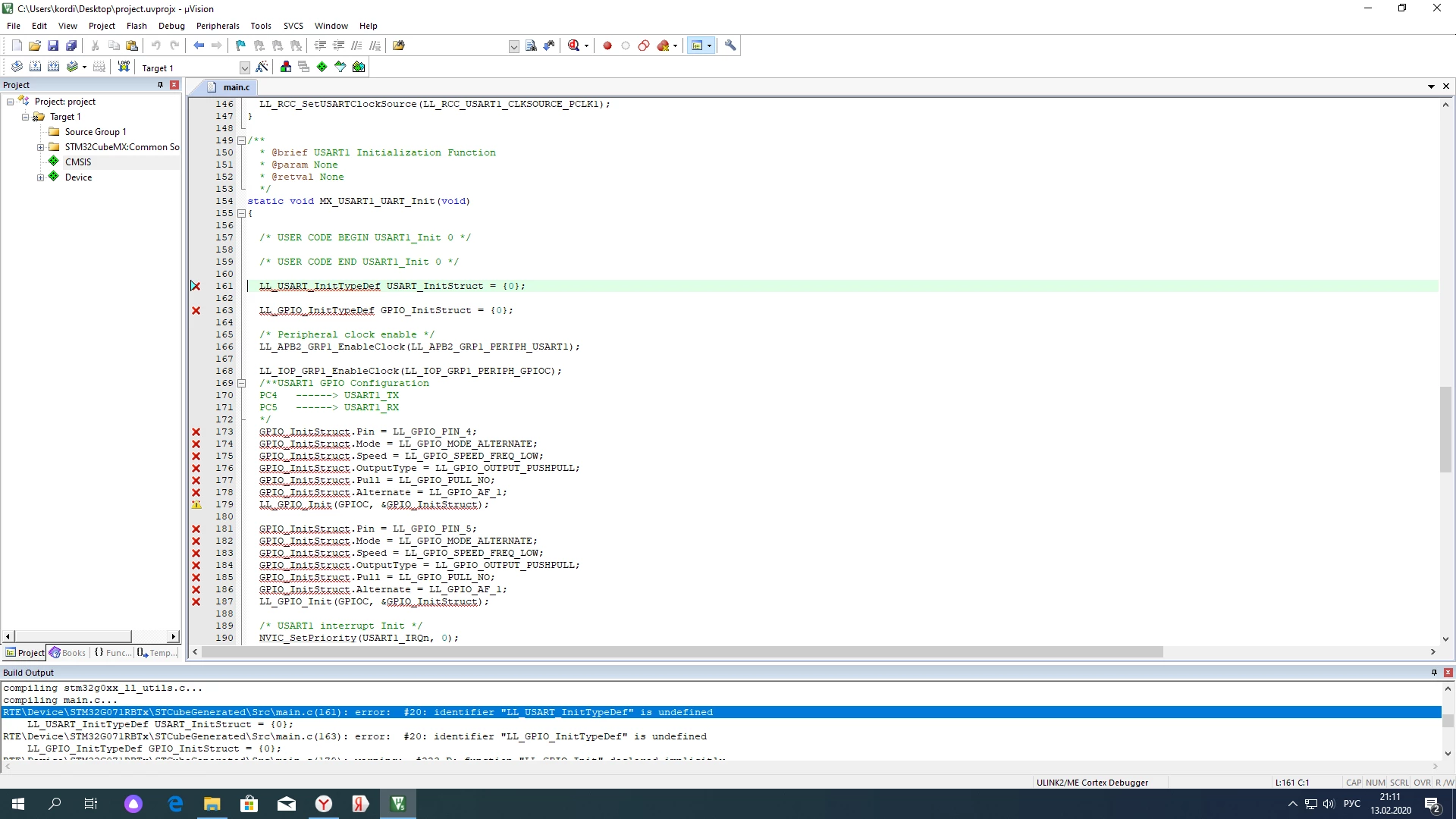

Hello guy.
   I' upgrade my CubeMX software to V.4.25.1 every thing is clear no problem. But when we try to generate MDK project CubeMX show an project generate problem ( see in attach pic.)
   Please tellme how to fix it
Thank you
EDIT!!:: TrueStudio has the same problem.
#cubemx-4.25 #mdk-arm

Can you try generating the code while your .ioc file is closer to the root folder? Like in E:/Work/ in your case? I have had the same error when my project file was too deep in a nested folder structure. I am thinking that the '&'-symbol in your path could cause an issue.

My repository had some files (.cproject, .project, .settings) owned by root. After I changed the ownership to my own user, I could generate my files through CubeMX smoothly.

I have met this problem as you are today,Then I solve this problem by changing "Project Location�? of my Stm32cubeMX's Project to a folder which have pure English.

For Me the issue has been solved for me by returning back to MXCube 5.2 version

I tried everything described above nothing helps. Now I write under several microcontrollers nrf52, TI, Silicon labs. Nowhere was there such a situation(there were other ha ha:) but at least described solutions) and here in General it is somehow bad. I got to the point where keil opens a project using this manual https://www.keil.com/pack/doc/STM32Cube/General/html/cubemx_proj.html
and imports settings from CubeMx but writes the following errors
STM32G071RBT6 - Nucleo board (noBSP)
LL tried
HAL tried
Keil version 5.29.0.0
CubeMX 5.5.0

Same here; like other users, I've tried everything to no avail. The strange aspect is that code generation for ARM-Keil under CubeMX works perfectly on my desktop PC, but it fails every time I try on my Surface2 laptop. The setup is identical for the two machines, even the folders are the same (i.e. they have the same name, with no diacritics or peculiar symbols). On the Surface 2 machine, code generation is successful for every IDE/toolchain with the exception of Keil uVision, which is exactly what I need to use for my university project. It would be a serious problem for me to not being able to work from my laptop.
Edit: reverting to CubeMX version 5.3 on the Surface2 PC solves the error during code generation, but then another issue appears: once Keil uVision is started, it cannot locate the board (the error message is something on the lines on "device not found"). Not very surprisingly, if I generate the exact same Keil code with CubeMX 5.5 installed on my desktop PC and then copy the folder on the Surface PC, Keil works perfectly!

I had the same issue with the '...project generation have a problem' when using CubeMX v5.4. Reverting CubeMX v5.2 resolved the error issue, but I experienced the same issue as you - a 'device not found' error when opening the project in Keil. Taking a look a the Keil .uvprojx file generated by CubeMX shows that the device parameter is blank!??? This is shown below in the snippet from the beginning of the .uvprojx file.

After opening a support case and sending files back and forth, the support person asked me to send my java version (which was 13). I did some more searching and found the following user guide for CubeMX.
https://www.st.com/resource/en/user_manual/dm00104712.pdf
The solution was in this document. Specifically, the following section states the java version requirements.
3.1.3 Software requirements
The Java Run Time Environment 1.8 must be installed.
Note that Java 9 and Java 10 are not supported and there is limited validation done with Java 11.
Note that I had version 13 installed. After uninstalling v13 and installing v1.8 x64, everything started working! After running 'Generate Code' in CubeMX, clicking the 'Open Project' button in CubeMX caused the project to successfully open in Keil, and the build of the project succeeded.
Kudos to ST support - they definitely helped to resolve this issue. Hope it helps someone out there. If it does, be sure to post your success so others with this issue will be pointed in the right direction.
