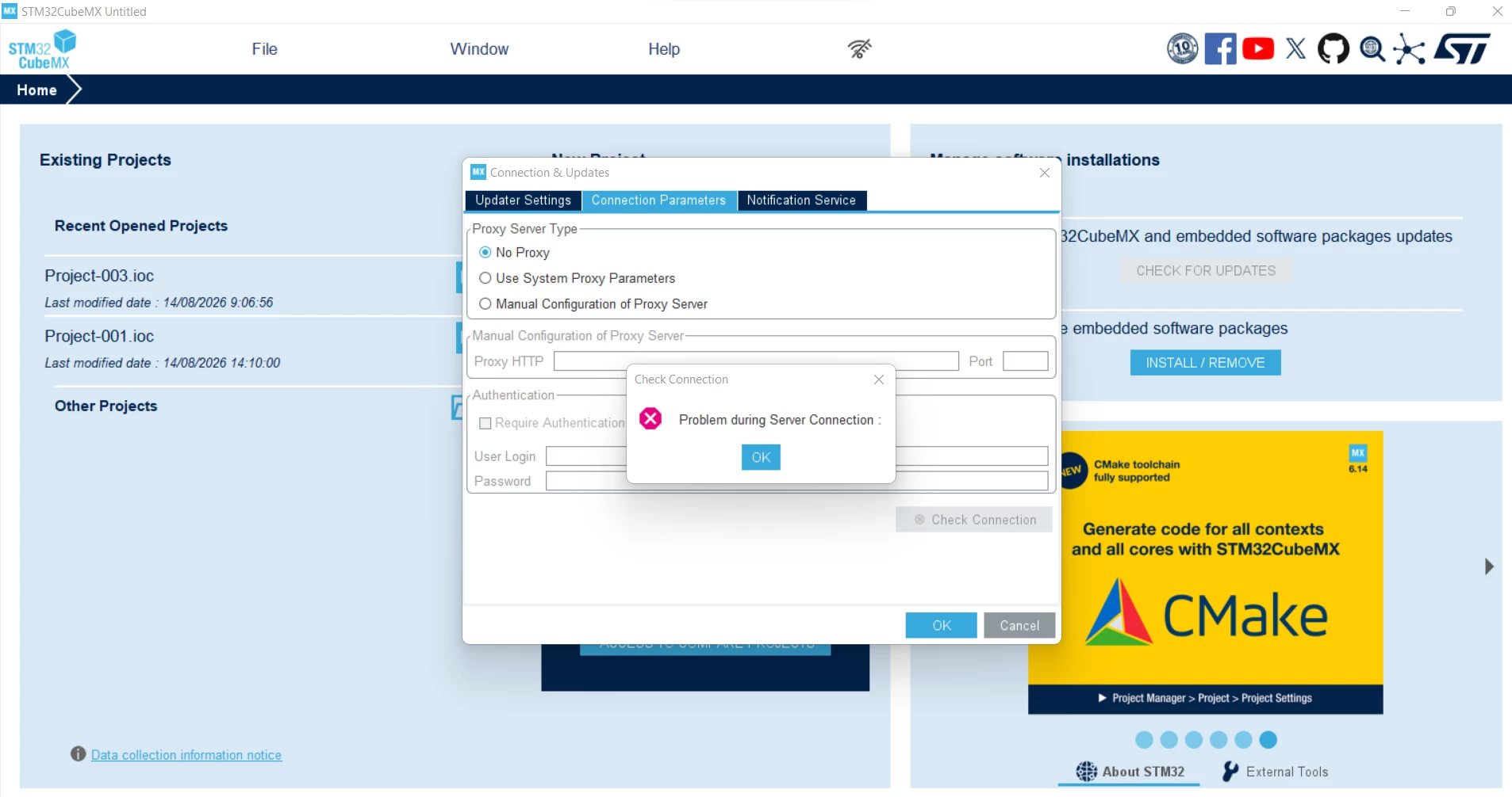

Hello everyone,
I am experiencing an issue with STM32CubeMX version 6.18.0 right after a fresh installation. The software is unable to connect to the server to download repositories or updates.
Here are the details of my situation:
  • Network Environment: I am using my office Wi-Fi, which does not use a proxy server. Other applications connect to the internet without issues.
  • Error Message: I keep getting a "Problem during server connection" error.
  • Troubleshooting Done: I have already gone into the Connection Settings and tried changing the proxy settings to "No Proxy" as well as "System Proxy", but neither option resolved the issue.
Since there is no proxy on our network, I am unsure what is blocking STM32CubeMX from reaching the server. Has anyone encountered this with version 6.18.0, or does anyone know which specific ports or URLs need to be whitelisted in our office firewall?
Any help or guidance would be greatly appreciated. Thank you!

In my case, the application cannot establish a backend internet link at all.
When I open the connection configuration and click "Check Connection", it results in a hard "Problem during Server Connection" failure immediately. This blocks me completely from fetching firmware packages.

Thank you for the suggestion.
I just tested using my mobile hotspot completely disconnected from the office network, and the result is exactly the same: no connection gets established, and the cross remains over the network icon.

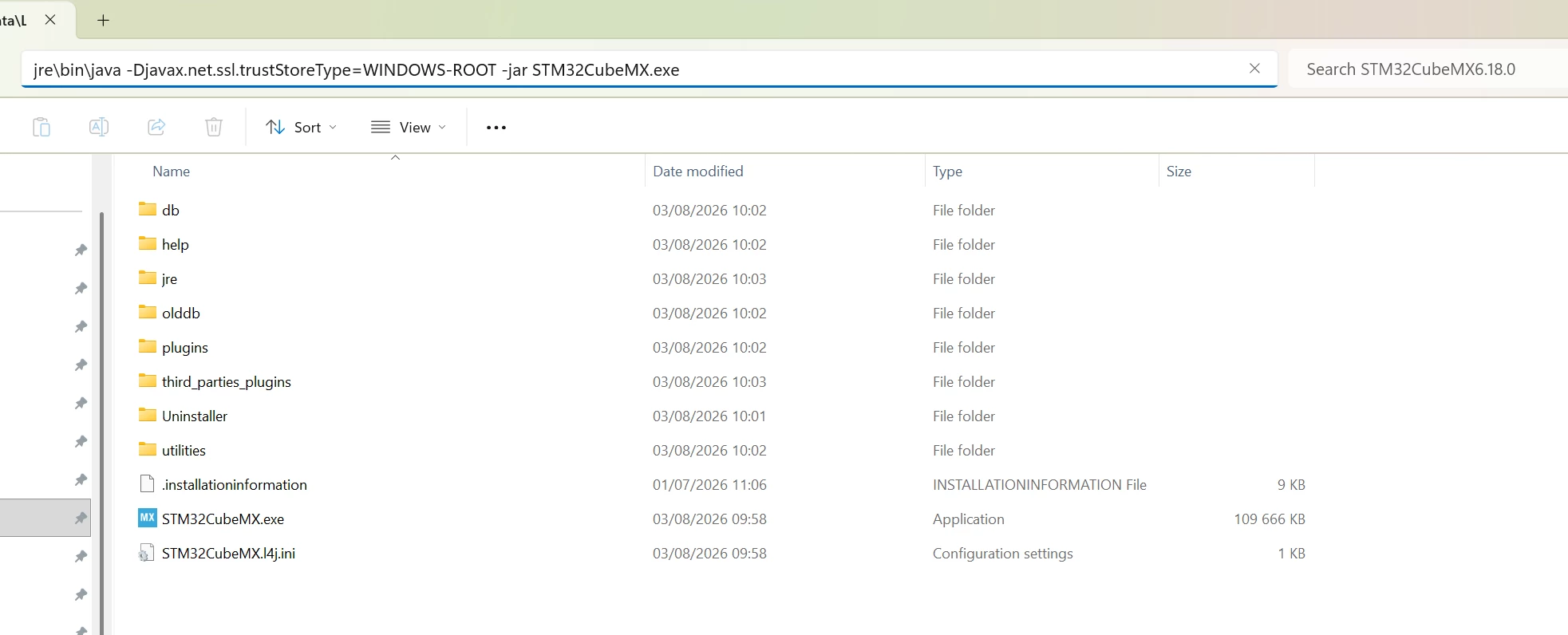

Hello ​@Shirisha Manchi
Let’s try a full clean reinstall of STM32CubeMX: first uninstall the application, then reinstall it using a fresh installer.
Then launch STM32CubeMX from a Command Prompt opened in the installation directory using the following command:
jre\bin\java -Djavax.net.ssl.trustStoreType=WINDOWS-ROOT -jar STM32CubeMX.exe
Then test the connection again from inside CubeMX. If the issue still persists after the reinstall, please send me the full command-line output by simply copying and pasting everything displayed in the Command Prompt window. This will help me investigate the issue further.

Hello ​@Ghofrane GSOURI
Still, it is not working and here is the command-line output
log4j user configuration file not found: C:\Users\Shirisha Manchi/.stm32cubemx/log4j2.xml
Configure log4j with default settings from jar:file:/C:/Program%20Files/STMicroelectronics/STM32Cube/STM32CubeMX/STM32CubeMX.exe!/log4j/log4j2.stm32cubemx.xml

Ghofrane GSOURI
Aug 14, 2026 11:55 AM UTC
The command-line log shows that STM32CubeMX can reach the backend, but the HTTPS handshake fails due to a certificate trust issue. The relevant error is:
PKIX path building failed / unable to find valid certification path to requested target.
That typically happens when a firewall, endpoint security tool, antivirus HTTPS inspection, or a corporate web security solution intercepts the connection and presents a certificate that the Java runtime inside CubeMX does not trust. So at this stage, the evidence points much more to a local or corporate security configuration issue than to a defect in CubeMX itself as ​@Hamza King mentioned.
So you should inform your IT/security team.
THX
Ghofrane

2026-08-14 17:10:00,130 [INFO] MainUpdater:2892 - connection check result : 22
2026-08-14 17:10:00,130 [INFO] MainUpdater:289 - Updater Check For Update Now.
2026-08-14 17:10:00,130 [INFO] MicroXplorer:498 - Change Database Version : DB.6.0.170
2026-08-14 17:10:00,365 [INFO] RulesReader:64 - Compatibility file has been processed (323 Rules)
2026-08-14 17:10:00,381 [INFO] RulesReader:64 - Compatibility file has been processed (323 Rules)
2026-08-14 17:10:00,396 [INFO] CADModel:166 - CPN selected for project level
2026-08-14 17:10:00,396 [INFO] CADModel:115 - Register for checkConnection events
2026-08-14 17:10:00,426 [INFO] CheckServerUpdateThread:120 - End of CheckServer Thread
2026-08-14 17:10:00,615 [INFO] CADModel:166 - CPN selected for project level
2026-08-14 17:10:00,615 [INFO] CADModel:115 - Register for checkConnection events
2026-08-14 17:10:00,756 [INFO] HomeAdPanel:117 - Auto-refresh data requested => check proxy status ongoing
2026-08-14 17:10:00,772 [INFO] HomeAdPanel:138 - Proxy status is invalid, do not check for advertisement updates
2026-08-14 17:10:00,835 [INFO] DbMcusAds:53 - JSON generation date=Thu Sep 30 12:25:09 IST 2021 (1632984909247)
2026-08-14 17:10:00,867 [WARN] DetailPanel:346 - Failed to get advertising image, set to default
2026-08-14 17:10:00,961 [WARN] DetailPanel:346 - Failed to get advertising image, set to default
2026-08-14 17:10:01,039 [ERROR] ConfigurationRetriever:142 - IOException on connection: (certificate_unknown) PKIX path building failed: sun.security.provider.certpath.SunCertPathBuilderException: unable to find valid certification path to requested target
2026-08-14 17:10:01,057 [ERROR] ConfigurationRetriever:142 - IOException on connection: (certificate_unknown) PKIX path building failed: sun.security.provider.certpath.SunCertPathBuilderException: unable to find valid certification path to requested target
2026-08-14 17:10:01,078 [ERROR] ConfigurationRetriever:142 - IOException on connection: (certificate_unknown) PKIX path building failed: sun.security.provider.certpath.SunCertPathBuilderException: unable to find valid certification path to requested target
2026-08-14 17:10:01,275 [INFO] MainFrame:210 - [MX] HOME_PANEL == 9257839426500
2026-08-14 17:10:01,306 [INFO] MainFrame:569 - Register for checkConnection events
2026-08-14 17:10:01,338 [INFO] JxBrowserEngine:153 - Initiate JxBrowser Engine with user profile folder
2026-08-14 17:10:01,478 [INFO] ThirdParty:978 - Integrity check success = true
2026-08-14 17:10:01,478 [INFO] IntegrityCheckThread:100 - exiting critical section [integrity check]
2026-08-14 17:10:01,478 [INFO] IntegrityCheckThread:103 - End integrity checks thread
2026-08-14 17:10:02,594 [INFO] WebApp:108 - Instantiating new browser for Auth
2026-08-14 17:10:03,401 [INFO] WebApp:239 - Apply proxy settings
2026-08-14 17:10:03,401 [INFO] WebApp:311 - Chromium requires no authentication
2026-08-14 17:10:03,417 [INFO] WebApp:267 - Direct internet connection detected
2026-08-14 17:10:03,425 [INFO] WebApp:370 - Register for checkConnection events
2026-08-14 17:10:56,250 [INFO] LoadServerUpdatesThread:375 - End of LoadServerUpdate Thread
2026-08-14 17:10:56,533 [INFO] WebApp:239 - Apply proxy settings
2026-08-14 17:10:56,533 [INFO] WebApp:311 - Chromium requires no authentication
2026-08-14 17:10:56,533 [INFO] WebApp:267 - Direct internet connection detected
2026-08-14 17:10:56,560 [INFO] CheckServerUpdateThread:120 - End of CheckServer Thread
