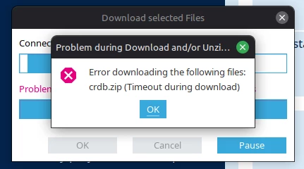

crdb.zip Timeout during download
I am unable to start a project from STM32CubeMX running on Linux Mint. I have no proxy setup on my network and verified the same with Connection Parameters > Check Connection. I also tried the steps with another ISP, however the issue persists. What is the fix for this?

Hello ​@mnsandeepkumar
This issue has been fixed in the latest version of STM32CubeMX 6.18.1
Download STM32CubeMX6.18.1 from this link.
Same issue is discussed here: Error downloading the following files: crdb.zip (Problem during download) | Community and problem is under investigation.

I updated CubeMX to 6.18.1 and the issue is fixed. Thank you :)
